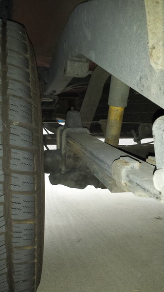

    So. Suggestions? Should I AAL or completely get them replaced? What does something like this cost?
    *I should add, I don't haul/tow anything the taco is my daily driver/road princess. 20150930_185811.jpg

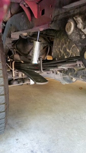

    They actually don't look to bad, but any factory style pack will look the same or worse in a short time.you really need 4 leaves/overload to eliminate axle wrap.I bought standard packs from General spring and made a extra a leaf from the factory mainspring. I would suggest there HD pack or add Wheelers 3 leaf mini pack and ditch your overload.

    Those yellow/blue shocks ... are they the original TRD Bilsteins? If so, they've gotta be dead too. AALs don't replace (meaning, "fix") worn springs. You should get springs if you've lost height.

    I'm assuming they are the original bilstiens. I've only owned the truck a year. At this point I think I'm going to completely replace the shocks all around and maybe the front springs too. As well as the leaf springs.

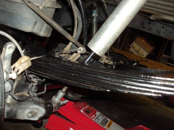

    Build urself some...
    RugglesTarlek likes this.

    That's clever! So, you save $50 over the cost of the HDs from General Spring, and recycle part of the old setup to create a spring stronger/taller than just the Standard set from them.[/QUOTE]
    Well, it wasn't the plan, but the standards settled in really fast and I started getting axle wrap within 500miles. So I measured and cut the mainspring, drilled the holes for the spacers (which was very tough)and added it as the the 3rd leaf. Ended up with 1" of lift or so and stiffen the pack up nicley. 20150913_144907.jpg

    California
    basic basic basic 14 AC
    What Doug (@4WD) said. You can save money and have fun at the same time. This really isn't that hard a project.

    4WD
    4WD cRaZy oLdmAn
    Jul 2, 2009
    #19185
    23,530
    Doug
    Lakeside, Ca / Gardnerville, Nevada
    2004 DC TRD 4x
    Grey wire MOD, deck plate, diff breather MOD, 2nd gen. OME 883# on Tundra 5100's, OMD custom 3" leafsprings, rear shock relocation, Ivan Stewart TRD rims w/285/75/16's, '02 bumper MOD, Famous Fabrications sliders , LED interior/exterior lights, bed bar, Custom tube bumper, Old school KC day lighters,Red Ring 8" HID flood, Kenwood vhf 2M.. umm some other shit I'm forgetting right now
    Good to see you & others are still banging the drum on this MOD....:thumbsup::thumbsup:
