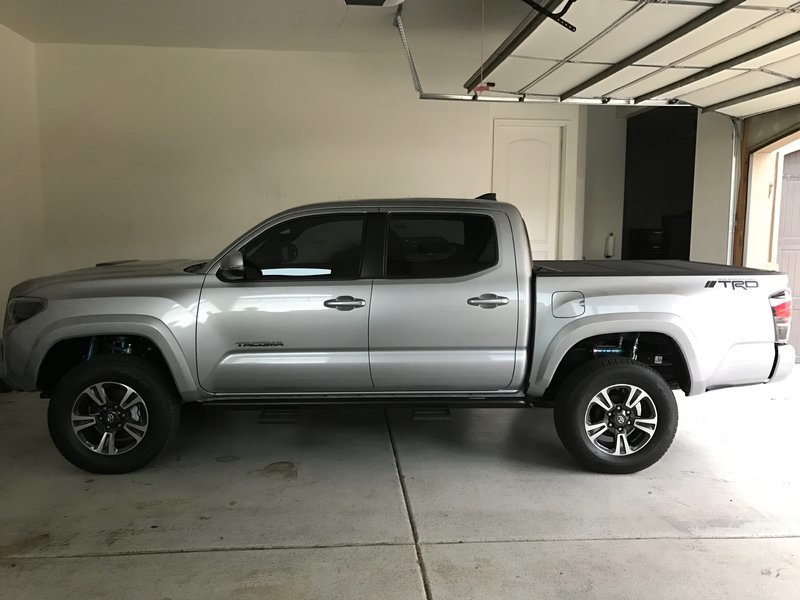

    All done... finally. I don't know who says this crap only takes them 3 hours. In total I was probably 12 hours. Granted I'm slow and wanted everything to be perfect, but still. Took FOREVER!! Pics and more info below:

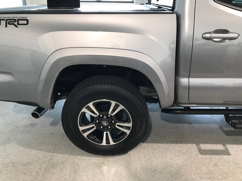

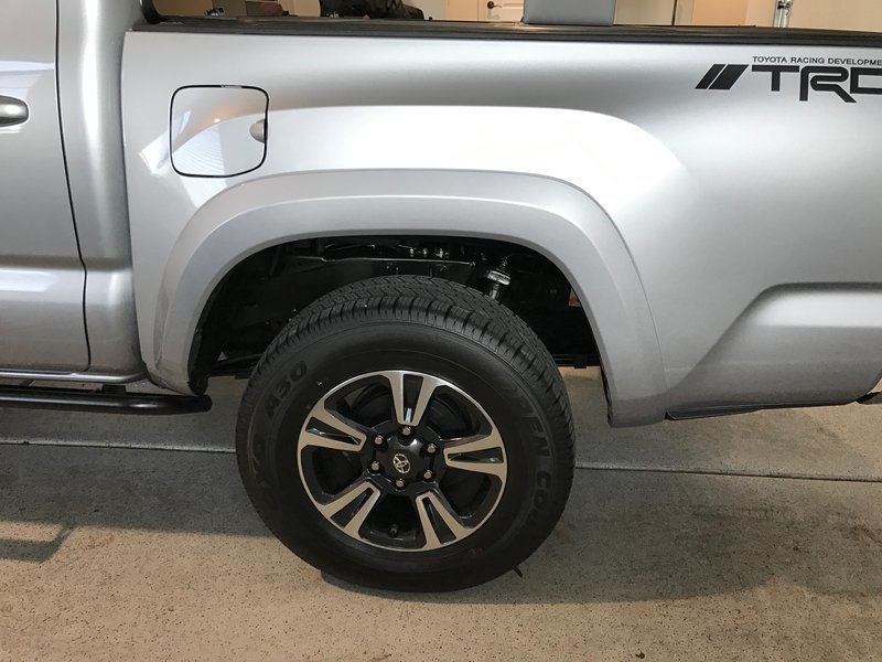

    Stock ride height:

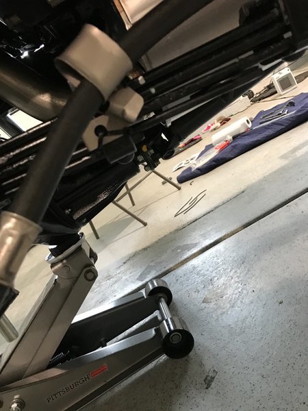

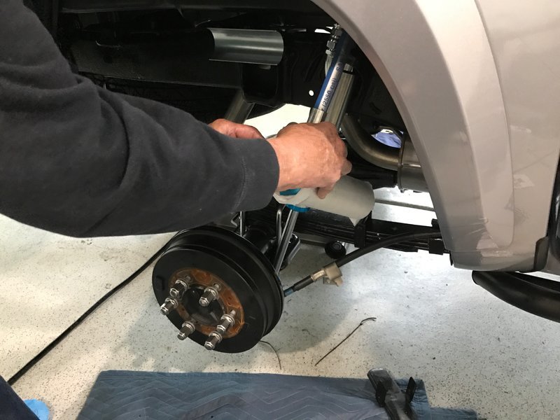

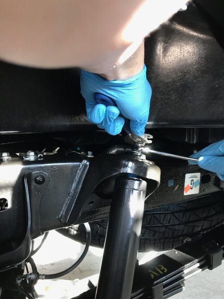

    For all of you who don't tool a ton, this one left me stumped. When I would try to get the bolt off, it just spun. You've got to grab the little nipple on the end of the bolt with a crescent wrench and it'll hold the shock still and keep it from spinning. Who knew?!?!?
    Shock removed:

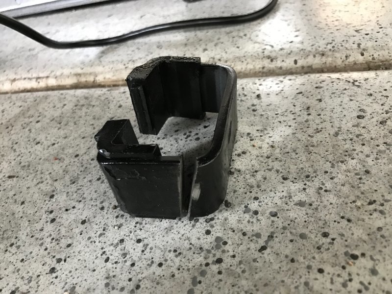

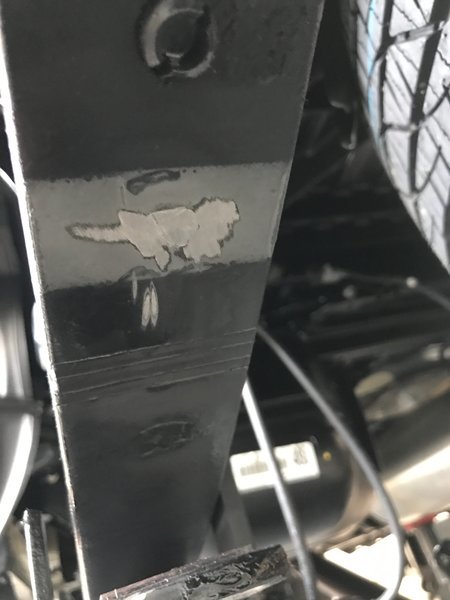

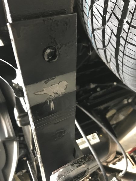

    Soooo, this whole thing. Everyone said all you had to do was grind down the rivet and then use a punch to push the rivet out. Yeah, that dog don't hut. I spent 2 hours trying to get it out on the passenger side. Didn't come out. So instead I decided to pull the bracket off and just grind it down to the leaf. Took 15 minutes on the drivers side.
    You can see where I cut the bracket after I had ground down the head. Once I ground the head, the bracket just fell off.
    Little bit better shot of where I ground it down.

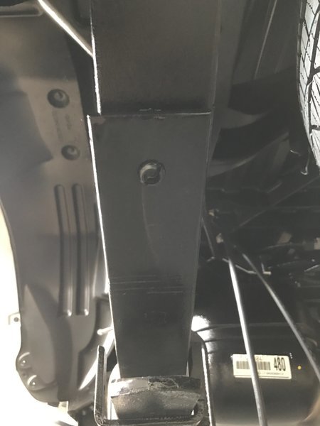

    Now you can't just leave bare metal under there. So I HAD to paint it. I hate rusty looking springs. Sprayed some primer under there on both sides:
    Little bit of Rustoliam satin black:

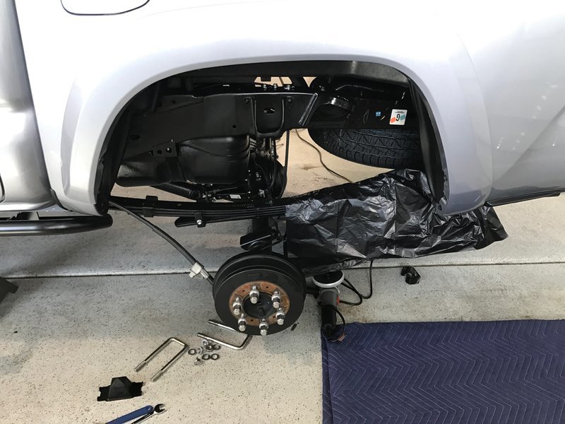

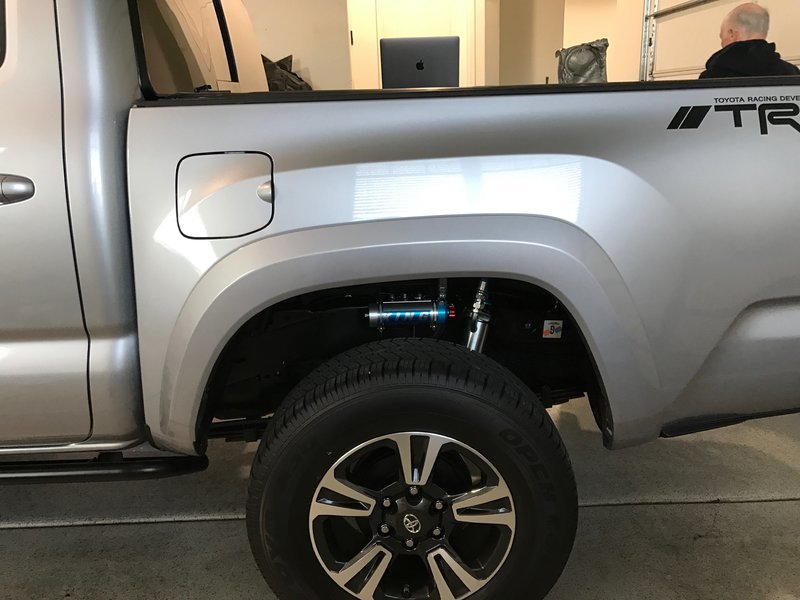

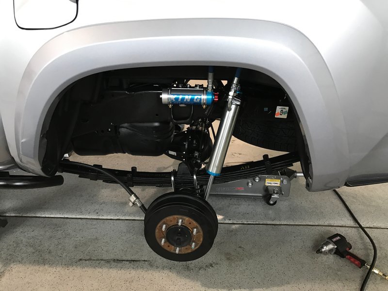

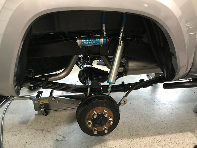

    Getting the AAL lined up sucked BIG TIME. Took quite a while to get them through the bolt, but the C clamps helped. Loading in the shock below:

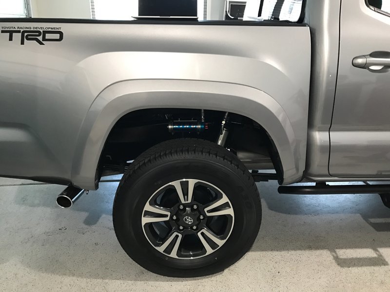

    All mounted up on the passenger side. Looks hot. I adjusted them all to their stiffest setting just to see how harsh the ride was. You'll also notice, no overload. Icon doesn't recommend them for their AAL.
    Driver side all put together. Interestingly, the adjuster valve switch will hit the shock mount if you're not careful. I twisted it to its stiffest setting (since that's all the way out) and lined it up in there with the clamps. I've now got room to adjust.

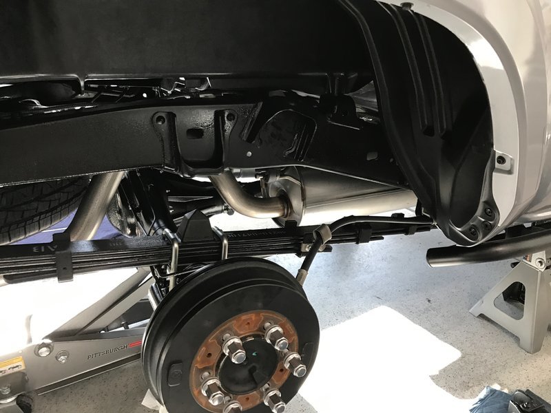

    This is my fun e-brake line "mount". I can't believe they don't give you something to replace your standard mount on your overload springs. I was thinking about drilling a whole and then bolting it down but I was tired. A project for another day perhaps. 3 zip ties will have to hold it for now.

    A couple of notes - if you do this yourself take your time. Rushing isn't needed. I drove it around and no clanking, clinging, rubbing, nothing. Sounds just like stock. Suspension was stiff for sure, but that was on purpose. I've got the settings on the reservoirs to their stiffest. Wanted to see how "terrible" it rode. Yeah, it was a LITTLE stiffer than the stock sport suspension, but I'll be honest, not much. I DEFINITELY need an alignment. That's all sorts of nightmare on the front end. Wheel doesn't return to center, super stiff, etc. My measurements are the following:
    Pre-lift:
    Front Driver - 20.5"
    Rear Driver - 21.5"
    Front Passenger - 21"
    Rear Passenger - 21.5"
    Post-lift:
    Front Driver - 23 1/4"
    Rear Driver - 23 1/4"
    Front Passenger - 23 3/4"
    Rear Passenger - 23 3/4"
    After getting the rear lift on, the weight redistributed and pushed that front end down a little bit under the 3", but just barely (1/4"). Sucker sits pretty dang level though! Very happy with how it turned out, but honestly it sucked - not $800 sucked like some places want to charge you, but it did suck. Doing it over again I could go faster for sure. Anyhow now it needs those wheels and tires. That should hopefully be coming tomorrow - weather permitting...

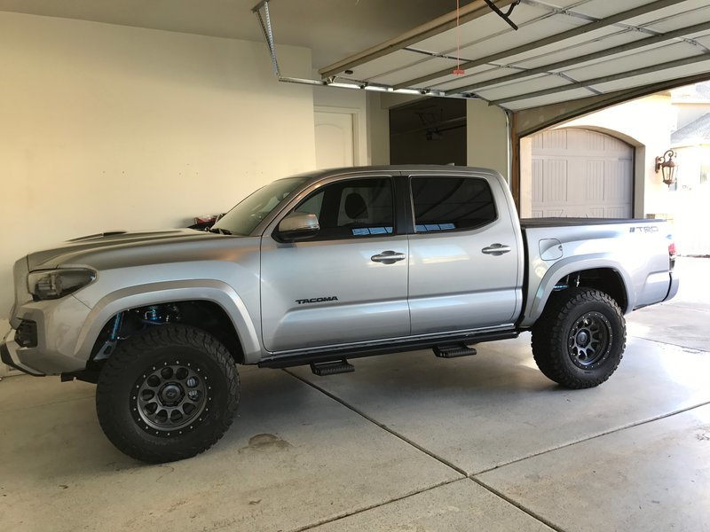

    Well got the wheels and tires installed today. The alignment is all screwed up. Dealership said "we can't adjust your caster because of the lift." So now I've got to look for someone who can/will. Idiots. Pics coming soon... hopefully...

    Alright, here's a teaser (I still need to take better pictures - this one is all drown out). Truck is going to go under the knife on Friday to help with the rubbing of the inner fender well. Also going to do a CMC on it next week. Buddy has a welder and just ordered a CMC plate from @JLee to do the job. Should be pretty straight forward from what I've read and can tell. We'll get those tires not rubbing yet...

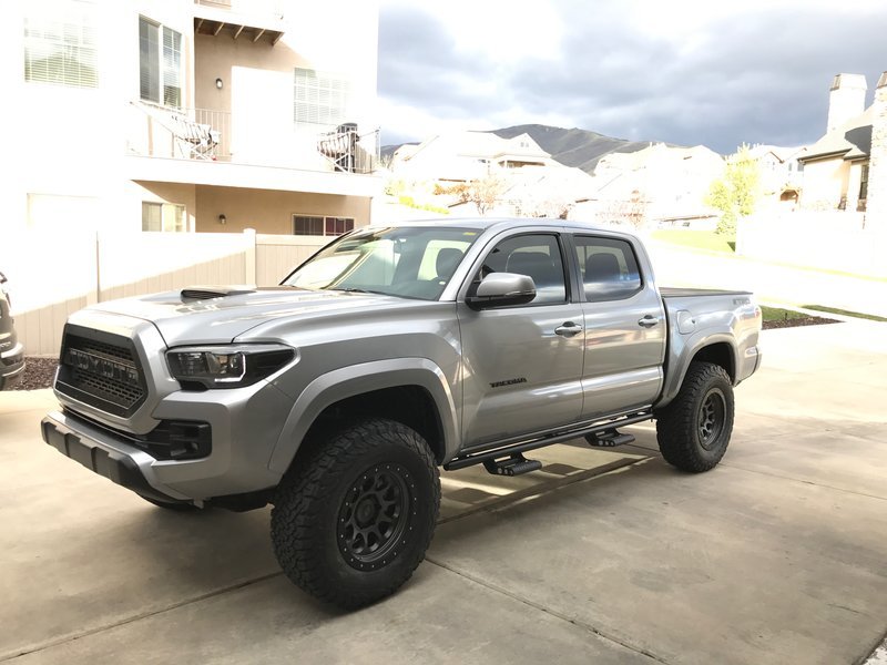

    Here's a slightly better profile pic... still need to take some better pictures.

    I'm not sure why others aren't rubbing, but I've only found a couple that are running this same wheel/tire setup. The backspacing on the Ray10's are pretty aggressive making them stick out. That's what's causing the rubbing I think. Pull them in and it helps A TON from what I gather. Cutting and CMC isn't that big of a deal. It doesn't look like there's anything behind the inner fender and not a TON needs to be cut, just the bottom. I'll post pics once I do the hacking that should help you out. The CMC is a little different, but you only hit the cab mount at full lock.
