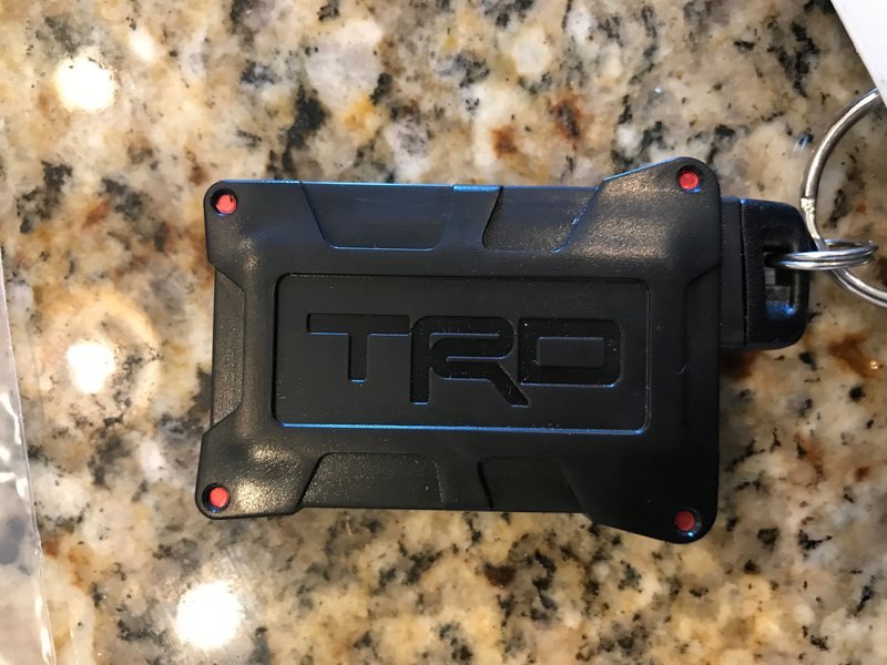

    Look what I got today. Must say, I really like it! Thanks @AJT DESIGN!

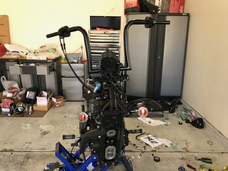

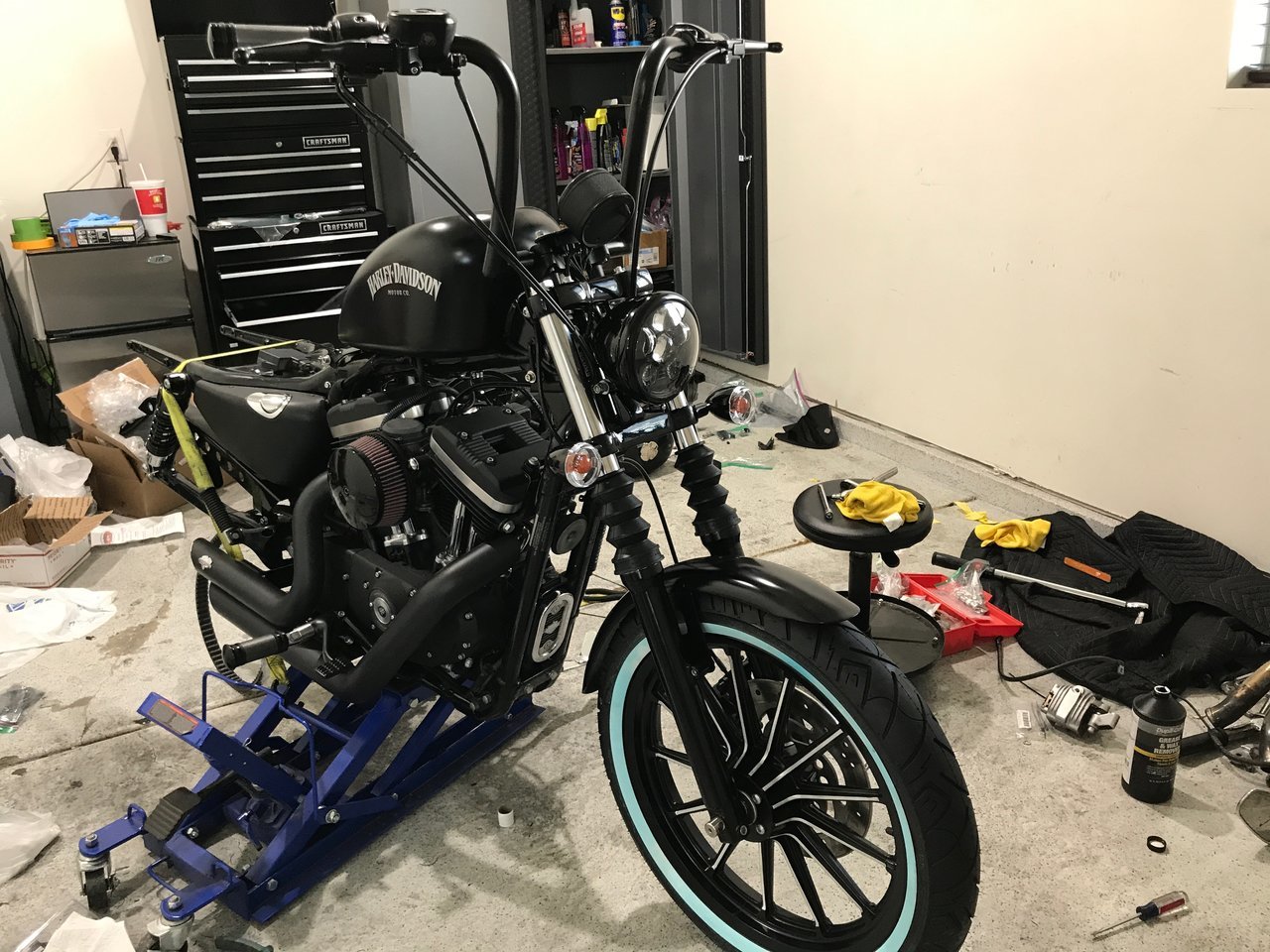

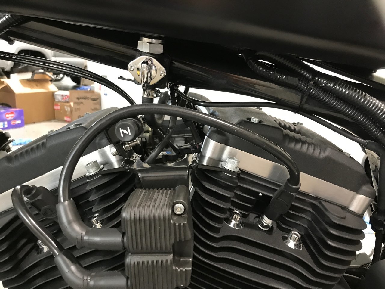

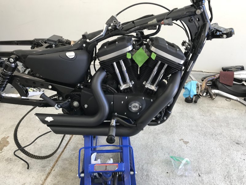

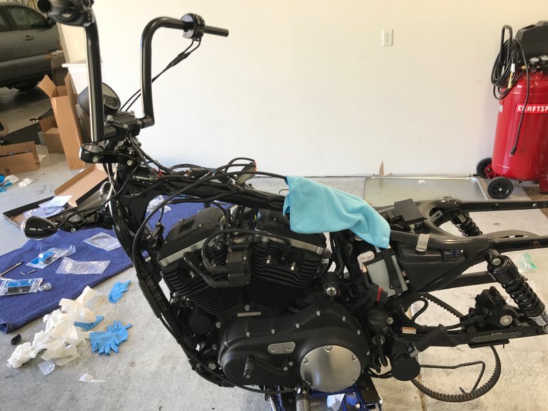

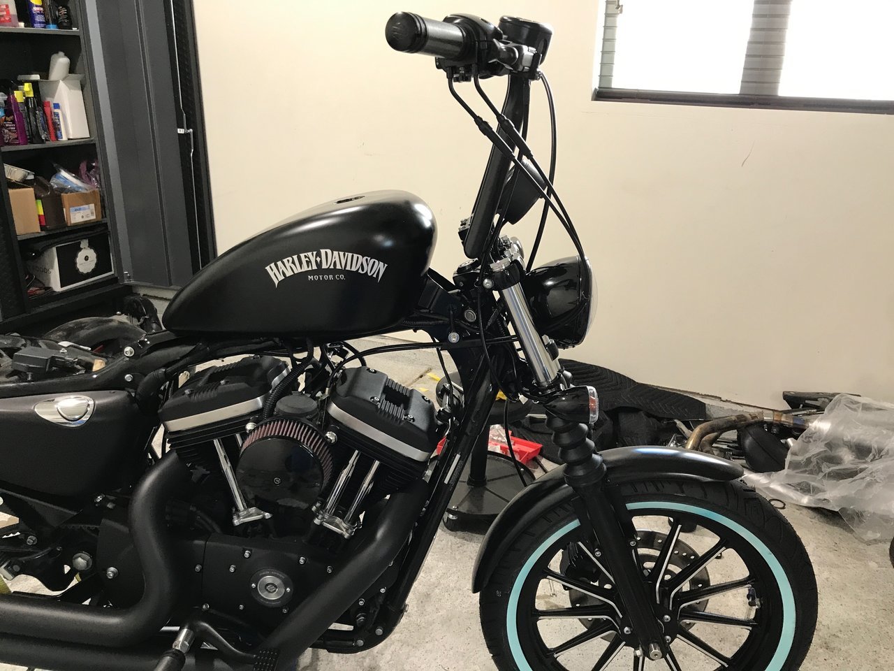

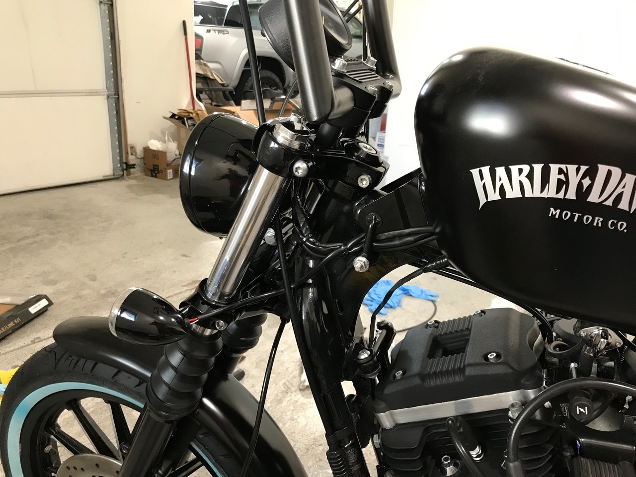

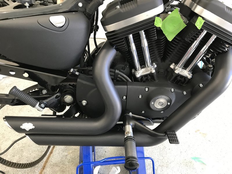

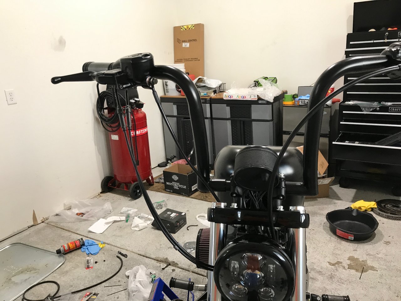

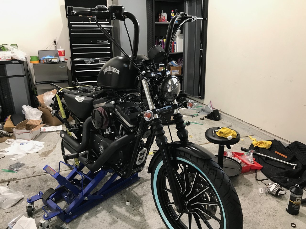

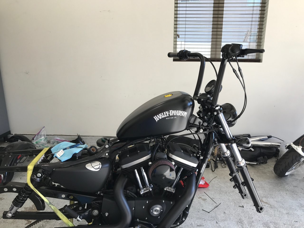

    Well, got some more work done on the Harley yesterday but wanted to make sure I highlighted the keyfob! Got the exhaust mounted, handle bars mounted, turn signals mounted, rerouted the ignition to clear the petcock, got the carburator and new longer throttle cables put together as well. My wife said, "it's finally starting to look like a bike again!" Can't agree more. Anyway, pics below:
    Exhaust all mounted... I know, played out short shots, but I still like them:
    Handlebars and carb mounted:
    Turn signals mounted - still need to wire those guys up:
    Ignition moved to behind rear cylinder:
    Close up of ignition, also you can see the choke there... not too sure I like how it's currently mounted. I'm using some zip-ties, and I don't love how well it's holding it. May end up moving it.

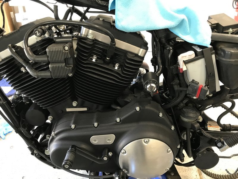

    2017 Silver Sky TRD Sport 4x4

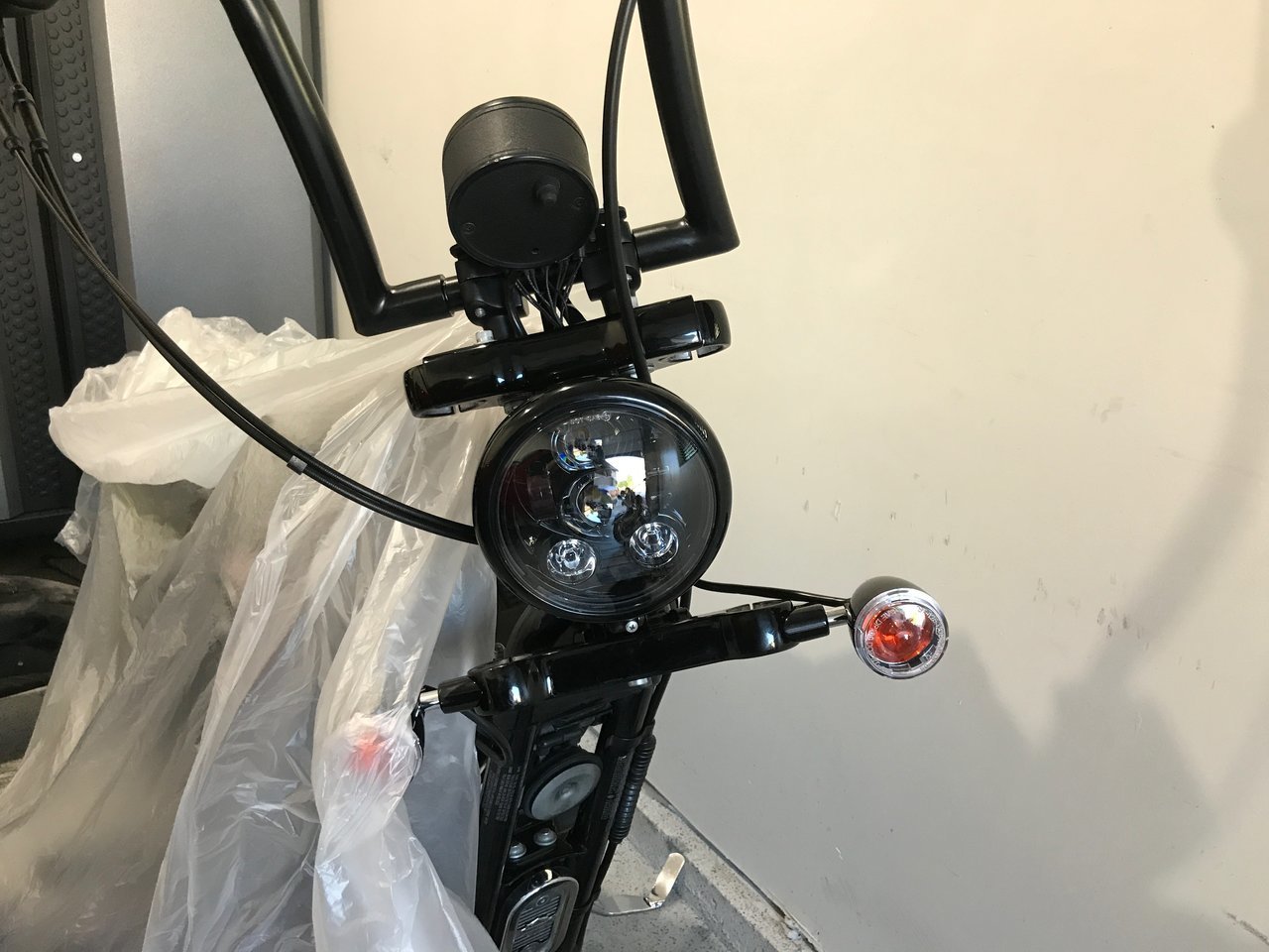

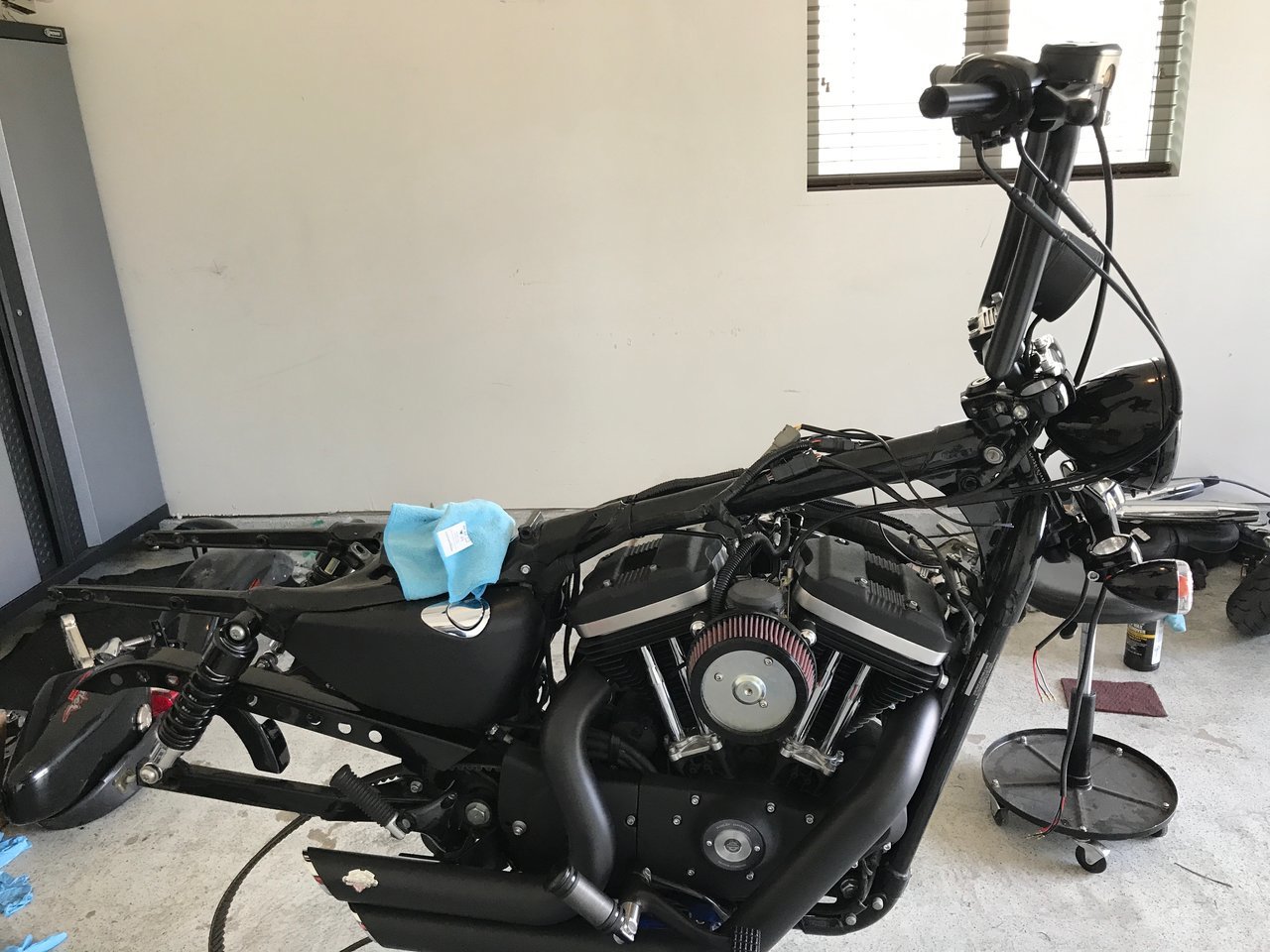

    Got a few things done today. Sorry for the kinda crappy pictures, I'll get some better ones tomorrow. Got the intake all mounted up. Can I just say the Arlen Ness instructions kinda suck? Anyway, got that taken care of, and also picked up all my stuff from powder coat. Let me tell you, it looks AWESOME! Put on the new powder coated oil tank cover and battery cover, got the headlight mounted too. Had to drill a hole through the lower triple tree, but the gloss black looks AWESOME! Re-mounted the chock using the stock mount bracket. Looks much better, but I'm worried that it'll hit the petcock. Guess we'll see. Also bought a chrome cover for the front of the triple trees that comes on the custom's and powdered it gloss black to finish off the front end. Oh, and can't forget, got the new clutch cable mounted up and finished buttoning up the left-hand controls. That side is ready to roll. Right side is about 75% there, but need to get the throttle cables all done up there too. Anyway, tomorrow will be finishing up some of the wiring and testing it, then 15K service time. I promise I'll get some better pictures too.
  16. Jul 3, 2017 at 5:27 PM
    #196
    obz
    obz [OP] Well-Known Member
    Nov 8, 2016
    #201908
    511
    Utah

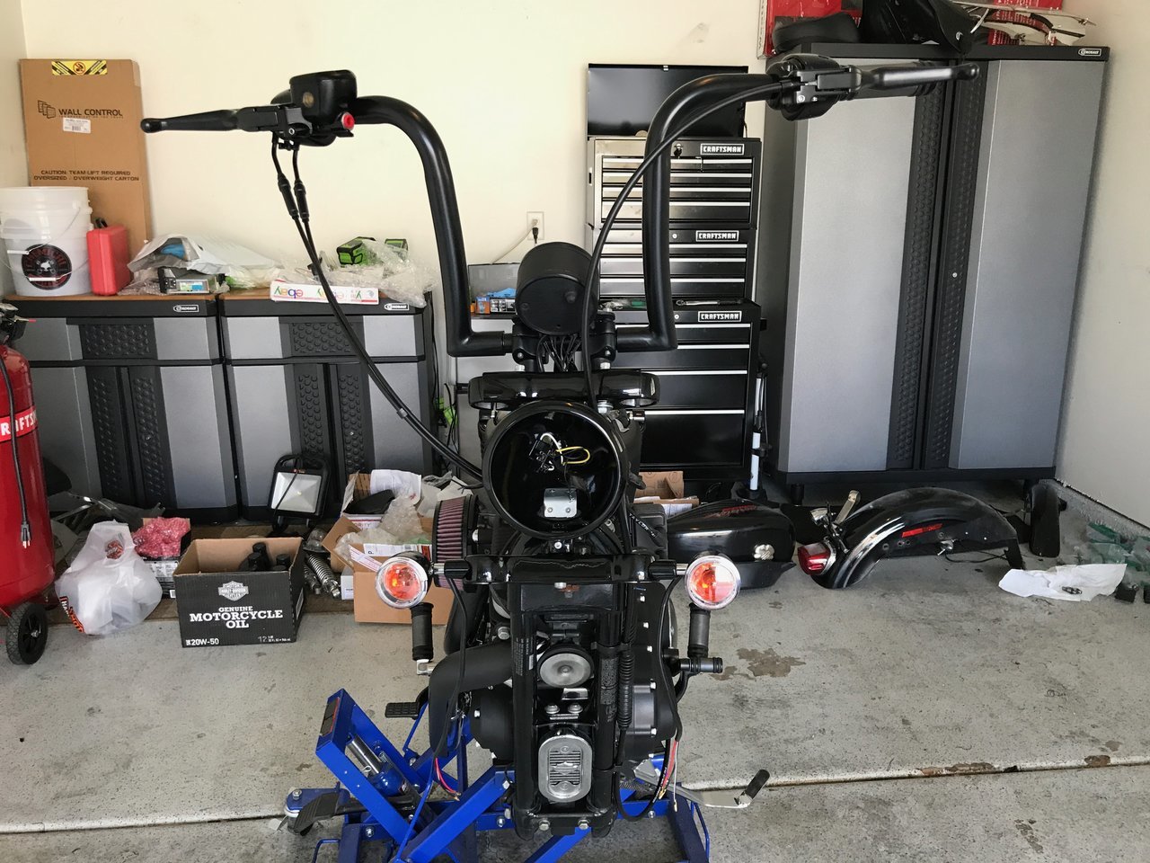

    As promised, a few more pictures. Did the primary fluid change today as well, but didn't want to do oil until I got my stuff all back together and could run the engine. Also removed the stupid charcoal tank. It's a California bike so had to plug the carb line and run the fuel overflow down through the engine. Also need to get a longer line for the carb overflow. The one that was on there is super short because it plugged into the old intake. All gone now. Finished up the right side controls too and wired up the front turn signals. Now I just need to get everything back from paint!! Anyway, pics:
    Close up of new headlight bucket:
    Close up of mount to triple tree:
    Close up of air cleaner:
    Right controls all buttoned up:
    Both sides:
    Removed charcoal tank:
    Choke mount from stock choke... still not sure whether it'll clear with the petcock - guess we'll see:

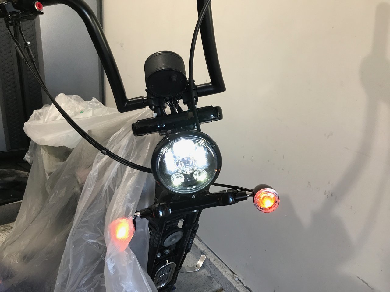

    Got the headlight in. Super bright!!

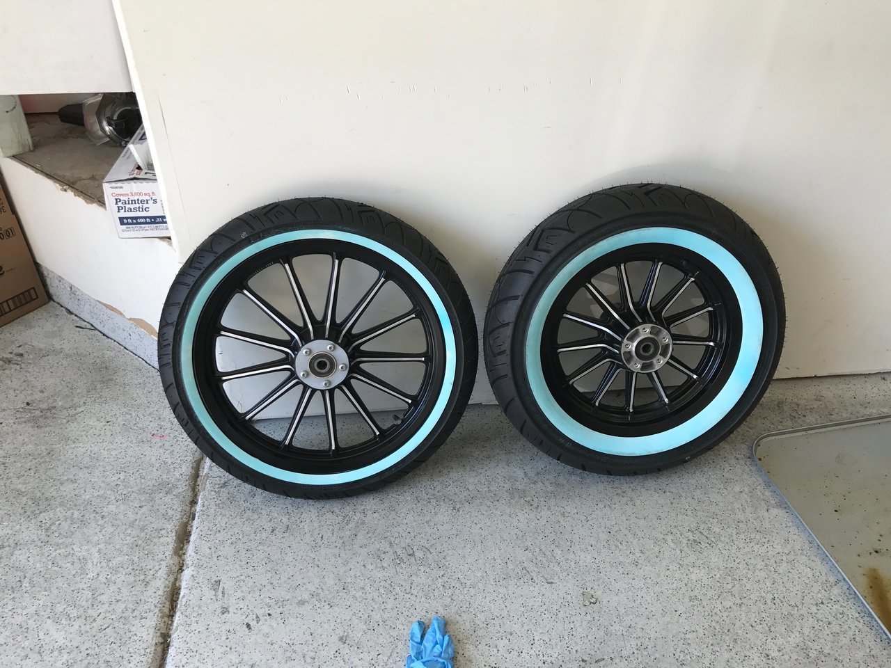

    Got parts back from paint. Now it's really going to start coming together. Wheels are getting the tires mounted and will be ready tomorrow.

    Tires mounted on wheels. The blue will come off once I wash the bike. It's to protect the whitewalls:

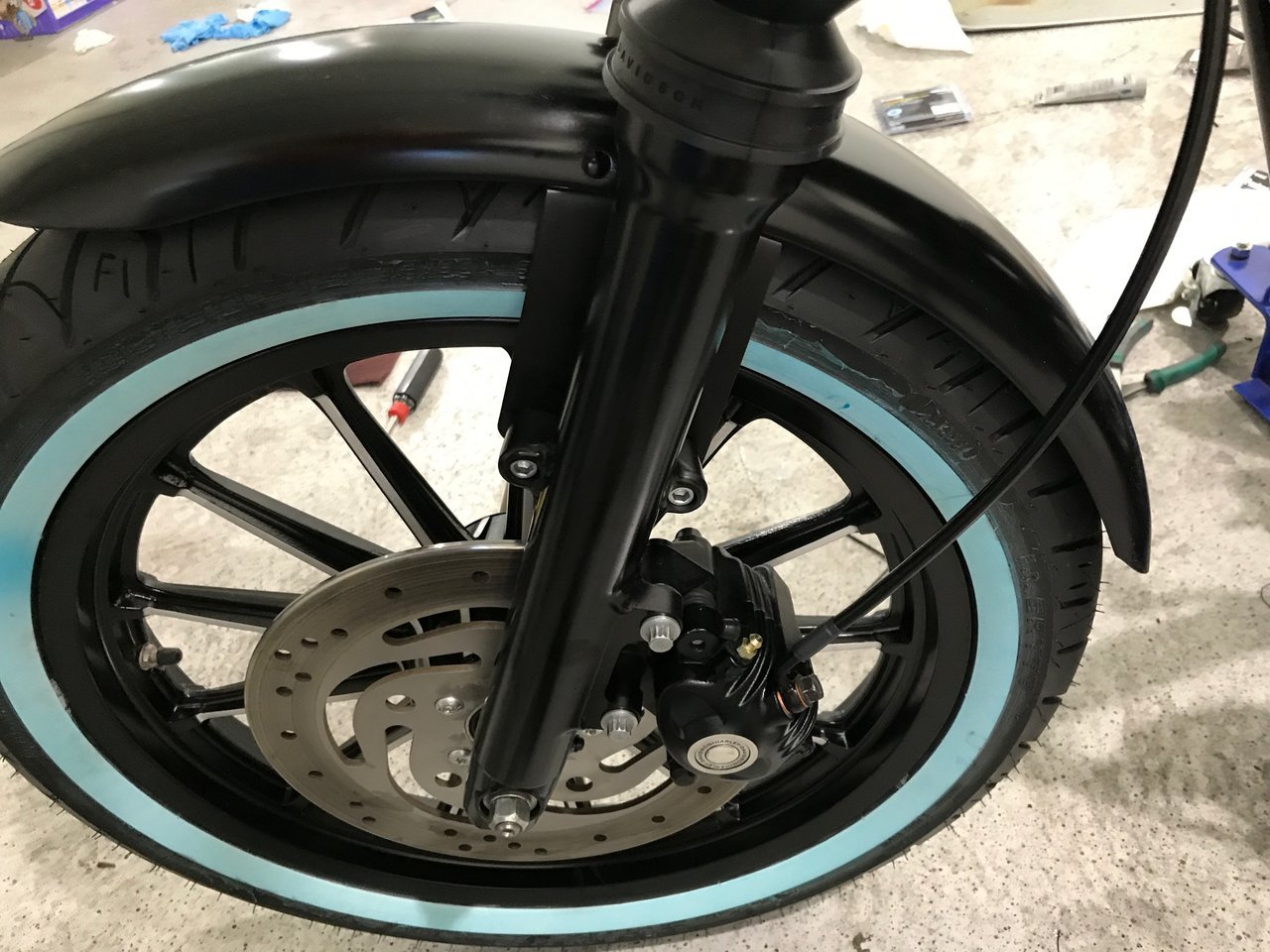

    Front brake line connected and bled. Easiest bleeding that I've done yet, I must say:

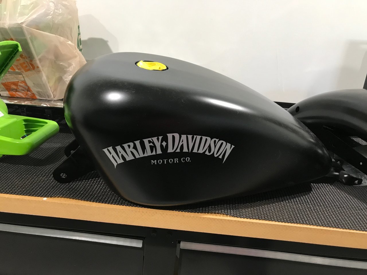

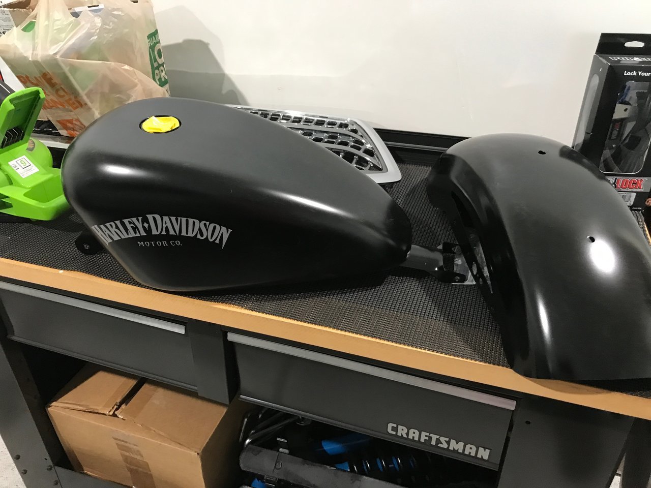

    Some more pics of the tank. My painter did a really good job. That's not a decal, that's actually paint!
