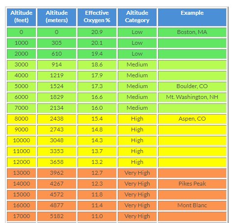

    Yes, the air/fuel mixture burns slower due to the thinner percentage of air. Lower oxygen percentage mixed with lower octane = less chance of detonation/ spark knock/ ping. Lower octane fuels burn more easily than higher octane as mentioned.
    Basically the same as using 87 at sea level to having 85 octane available up in the mountains of CO. 87 octane will be closer to having mid-grade in the truck. If you get access to 91, you'll be running race fuel. LOL
    Here's a chart for an idea of oxygen percentage based on location elevations the vehicle ecu has to account for, and adjust for the ideal Air-Fuel Ratio. Hope this helps.
    :burnrubber:
