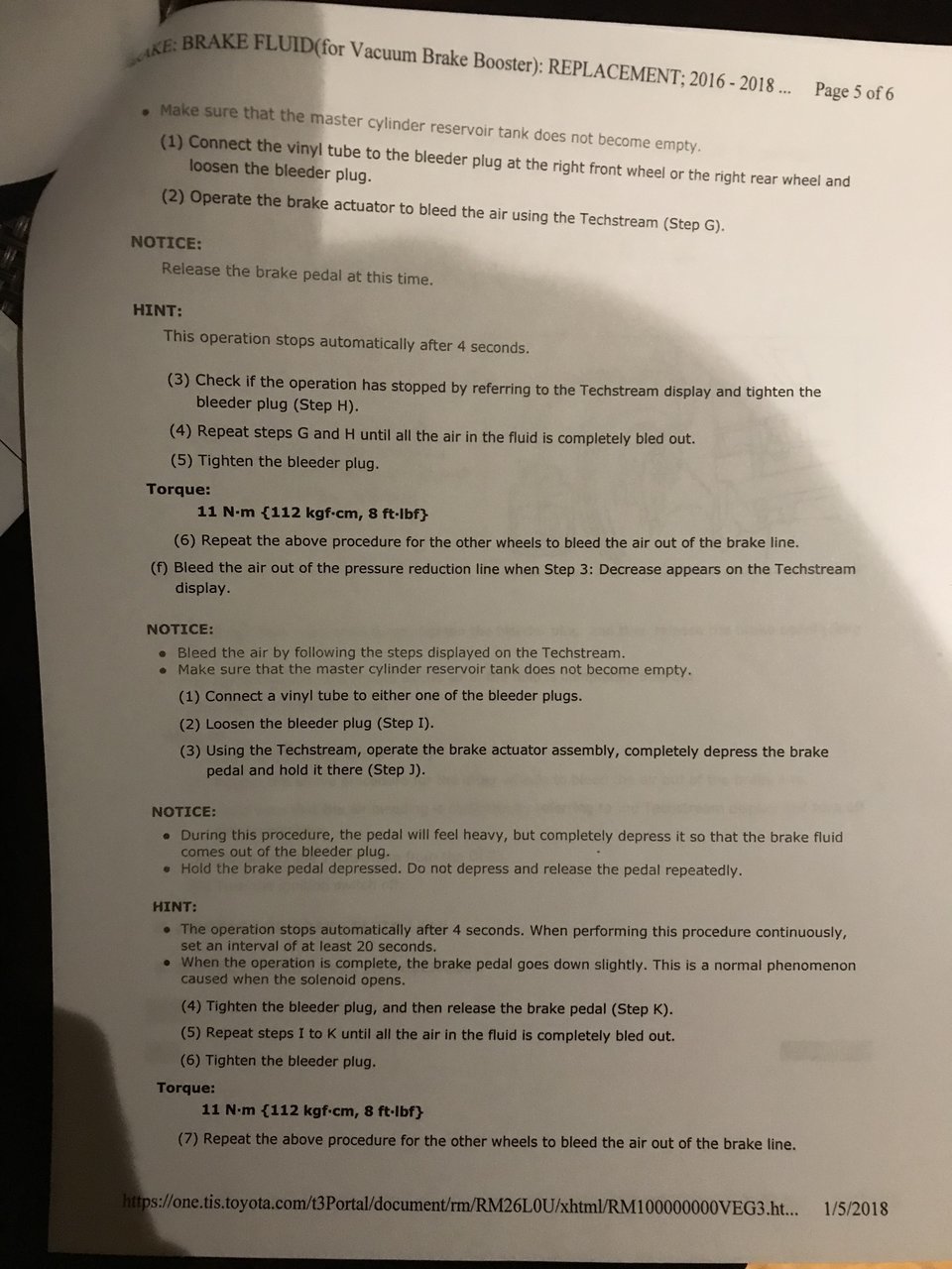

    Can you bleed brakes through the abs module with this scanner?

    Is there a function within your bluetooth scan tool that actuates the abs module in order to bleed air out of the system?

    Do you know of any tool that can do this or are you asking for a unicorn? I have never heard of such a feature nor can I figure out how it would do this in a mechanical sense. The abs module has no “vent” or any way that I know of to separate entrapped air from the fluid.
    Either I am not understanding what you are asking or your lack of understanding of the system is making you ask for something the system is not capable of.

    FA8CBB74-FF4F-404F-BCBF-A5B7EC8B9750.jpg It’s not my lack of understanding of the system. I understand the system quite well. It may be your lack of understanding on modern brake bleeding procedures though. I know of many scan tools that do this, at the shop I use the snap-on versus pro to bleed brakes via the ABS module on mostly all the new vehicles. If you’ve never done this or seen it I highly recommend looking it up. It’s also a step in how to bleed the brakes in our trucks btw...

    To be quite honest I had never given it any serious thought. I can see on abs module replacement or similar technology this is a requirement. I have never needed to work near the abs or related equipment. Even with caliper replacement I kept bleeding the old fashioned way. You learn something new everyday.

    I use an autel ds708(old model there is newer now) it does actuate the abs pump to allow bleeding. Many other functions as well tpms program ect....
    But Carista is under 100 and a tool like this is about 800-1000

    It's a real thing, I have done it before when air was in my system.
