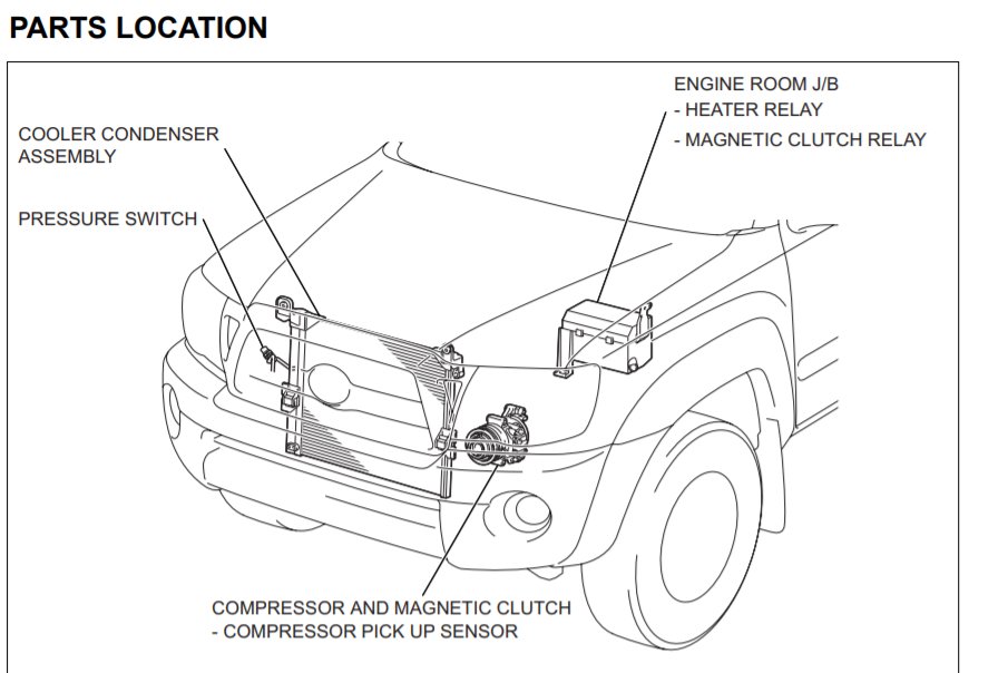

    Do you know off hand where these pressure switches are? I’d love to try that.
  15. Apr 1, 2020 at 7:06 PM
    6 gearT444E
    6 gearT444E Certified Electron Pusher
    Feb 3, 2018
    #243372
    7,795
    Deep South
    Herculiner Hootus
    right in front by the power steering reservoir, behind passenger side headlight. A small paperclip works great. Just had this happen on mine a few weeks ago, first thing I did was jumper the switch and compressor kicked on. I charged it up myself with $6 worth of refrigerant, no sense in paying a grease monkey to read a gauge.
