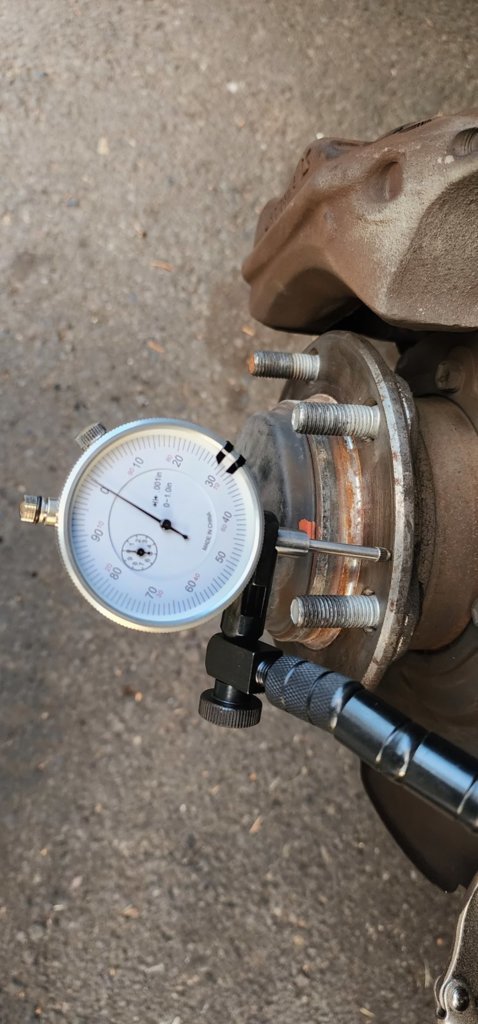

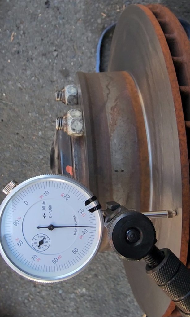

    BTW, just cause parts are swapped doesn't mean their true. FWIW, had an aftermarket set or rotors/pads that pulsed. So indexed on the hubs to find .0028" runout. LAPS swapped under warranty and indexed two new sets with similar results in some cases measuring like .002"-.0035". So bought Toyota rotors and pads. One rotor had undetectable runout and another measured <=.001" on the hubs, so used those.
    To index rotors, consider:
    • Starting by checking runout of hub. If the hub is true, then can bolt the rotors on the hub and check rotor runout.
    • Checking the rotor by marking one stud and the rotor hat at the same starting position and measuring the runout.
    • If not, then can rotate one lug and check again, repeating for each lug until you find the sweet spot where runout is minimized and in spec.
    • If have hub runout, then if have disc runout on first try that matches the position on the hub where the runout occurred, consider swapping the disc 180 degrees on the hub to see if that fixes or exaggerates the disc runout - confirming if runout is from disc or just propagated from hub (or both). Sometimes hub and disc are both slightly off and can be mounted to offset each other.
