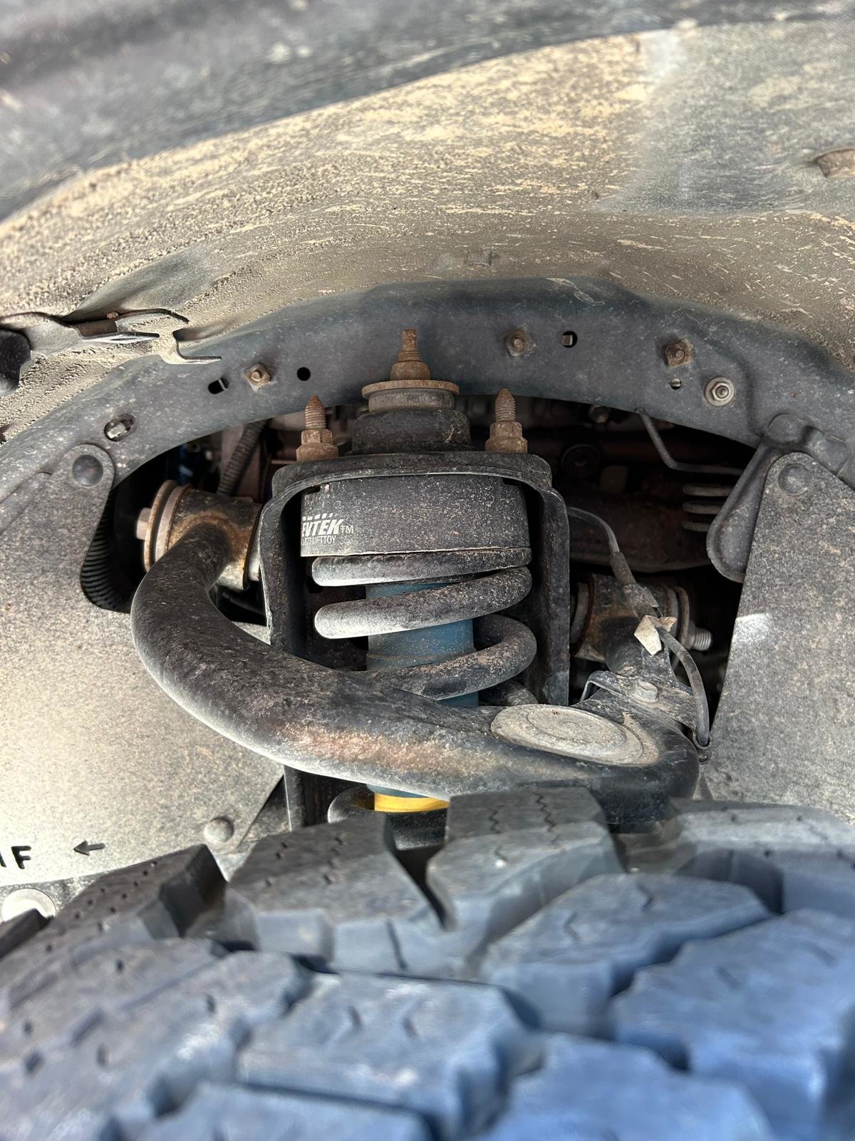

    Do you have aftermarket UCAs? Take a pick of the lift and post it on here. If you can get a video even better

    I bought the truck with the lift but I believe the UCAs are stock. It has a Revtek 3 inch suspension lift on it.

    I'll take a look at those. thanks!
