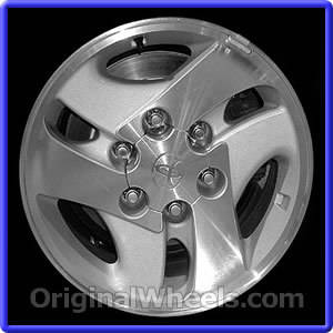

    Those lugs are definitely not stock. Here is what the stock lugs look like.
    Note there is a washer permanently attached to the stock lugnut and also a small taper on the end. That taper is important as it "centers" the wheel on the hub.

    The washers may have been put there on purpose. Those wheels may not have cleared the calipers without them. The pic you posted of the hub and caliper definitely show the wheel is hitting it.
    The wheels you have may have the toyota logo on them but I've never seen them before. They are definitely not what came with the truck from the factory.
