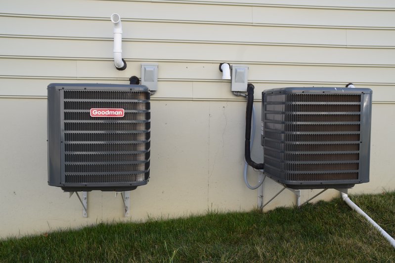

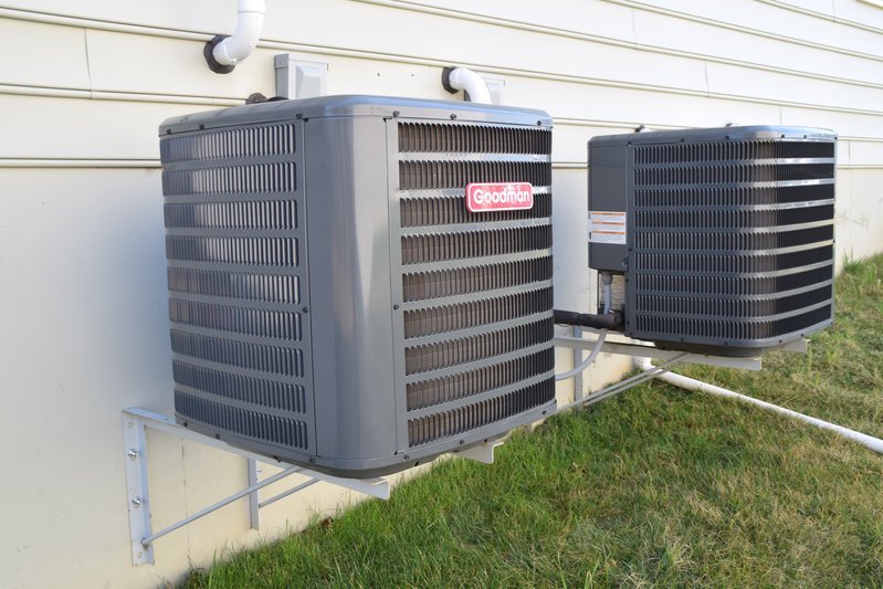

    My parents' house, built in 2015-2016, has dual Goodman A/C units. The older ones, manufactured prior to 2006, are typically junk in my opinion. There are exceptions to the rule, but Goodmans manufactured from about 1995-2005 are junk.
    Straight-cool is just an air-conditioner. A heat pump functions just like an air-conditioner in COOL mode. The difference between a heat pump and a straight-cool A/C is the reversing valve. When in HEAT mode, the flow of the refrigerant reverses and the heat process extracts warm air from outside and pumps it into the house (hence the name "heat pump"). Believe it or not, there is ambient heat in the air right down to absolute zero (−459.67°F). Even with modern heat pumps, the heating performance tends to suffer when it gets below about 40°F. The colder it gets, the harder the heat pump has to work to keep the space warm, and if it is particularly cold and/or humid, the unit will freeze up more frequently. When a heat pump becomes excessively frozen, it needs to defrost, which involves switching back into A/C mode (but with the fan blades not spinning) to melt the ice off of the coils. When the heat pump is defrosting, the A/C is basically on, and of course you don't want cold air being blown into your house during the winter. The emergency backup heat (basically oversized electric toaster coils in most cases) kicks in to cover up the cold air. This backup heat also kicks in when the heat pump fails, or if it is just too cold for the unit to operate. If you are lucky enough to have a dual-fuel system (heat pump with either gas or oil furnace), then you should not notice much of a spike in your utility bill or a difference in home comfort. If you have all-electric heat, then things can get expensive! Electricity is ridiculously expensive in California, and as such heat pumps are virtually unheard of out there. Most houses in areas of California where it get cold have gas heat.
    Most houses in America built in that last 50 years or so have a straight-cool air-conditioner matched up with a gas furnace. In houses that have a hot water baseboard or radiator heating system (not forced air; separate from central A/C if house is equipped); typically oil or gas), a straight-cool air-conditioner with no heat of any kind is not uncommon.
    As I said above, I highly doubt your house has a heat pump.
    Another question:
    Is your Goodman unit dark gray in color, or tan?
    These are the Goodman units at my parents' house in Pennsylvania (both from 2015). This is basically what Goodman and Amana HVAC products have looked like since 2006.

    My unit is dark gray, it looks just like the ones in the pic of your parents place... and no reversing valve so it must be straight cool. I know the compressor is on because I can hear it running when I'm standing next to the unit, yet no fan operation. The fan I am referring to is the one in the AC unit itself.

    I have never seen those mounted on the foundation like that. Is that because of all the snow and ice in your area?
