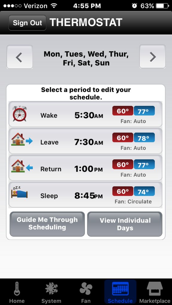

    You keep your A/C set to 77 all the time?
    As I said before, my parents' has two units (one for 1st floor and basement, one for 2nd floor). The first floor thermostat is set to 74 and I just set the second floor thermostat to 68 degrees like I always do right before bed. My parents and I like it cold!

    Lol yea man I wish I could keep it cooler but my wife gets cold really easy so I get an earful if I turn it down below 77. Plus I think my thermostat in the house runs a bit cold, I used to keep my apartment around 72-74 and it was comfortable. But set to 72 in this house is too cold even for me.

    I try to let mine run it's schedule. $300 electric bills are brutal in the summer. :bananadead:
