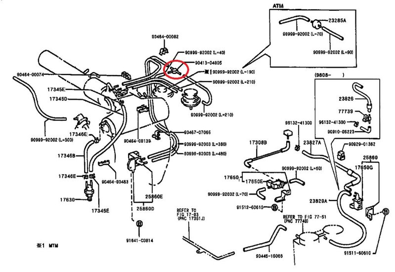

    I am trying to better understand how this EGR valve works, I can't figure out what the hose coming out the bottom of the modulator connecting to the EGR valve does. The hose on the top of the EGR presumably provides the vacuum to open the valve; does the one on the bottom simply vacuum it back shut? I would have thought it just closed on its own with its spring.
    This diagram isn't specific to this Tacoma but same system applies,

    I can understand the CEL, likely the P0401 code. But disabling the EGR shouldn't cause poor MPG, or rough idle :confused:
    Long shot here, but perhaps the PO worked on the truck, messed with the EGR stuff, and mis-routed the EGR vacuum lines. On mine, there are 3 that attach to the top of the modulator, in addition to the larger one at the bottom. One of the lines has a check valve in the middle of it. Make sure they all go where they are supposed to.

    I checked the hosing against the attached diagram, seems everything is correct. Is the part circled in the pic the check valve you're referring to?
