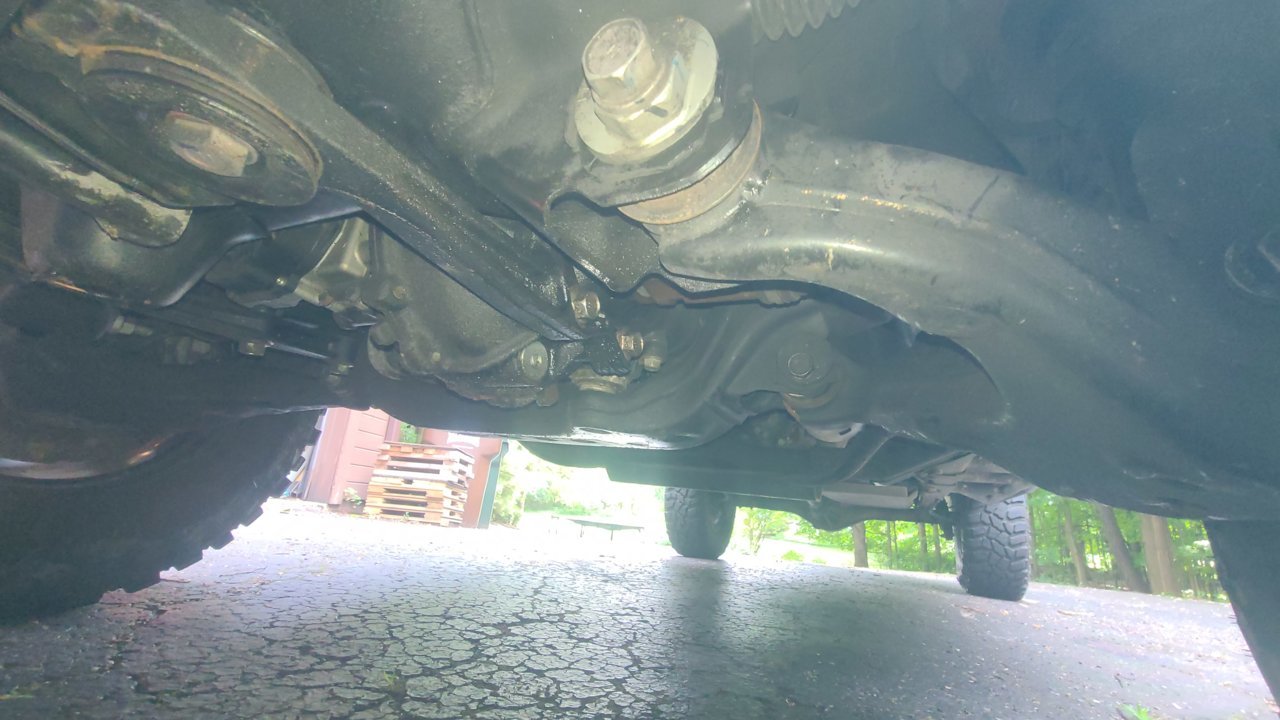

    So, i got home last Saturday. And i. The AM had a tiny spot under the truck, not from the AC water drain. Looks like the seal on the driver side front diff/axel. So i opened the diff fill to add fluid, well, the diff was full, diff fluid actually came out of the fill hole. Plugged back up, and looked further, maybe its the steering? Steering fluid is full. Engine oil is full. No leaks till i got home. Last day i drive 900 miles, all highway. I have an appointment at the dealer this week. But its driving me nuts i cant find the issue. I have photos, but i cant imagine they would help.
    This post will be annoying for most you read. My answer to me would be, go to a mechanic.
    I do have the driver side ecgs bushing, but its been in w my suspension for like a year.
    Puzzle.

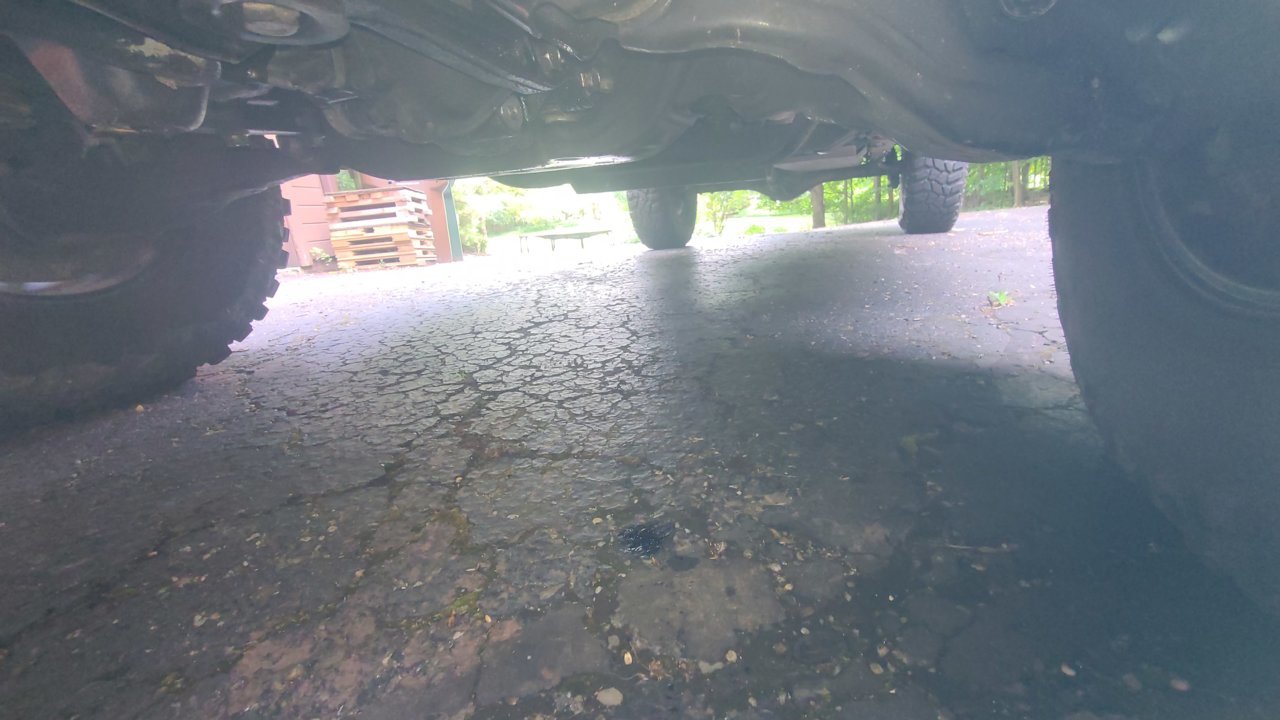

    Because im home in my driveway, and its always clean free of leaking vehicles.
    Underneath, crap. But cant fine it.

    What color is the fluid if you dab it with a white paper towel? Does it have a sulfur smell?

    No smell. Clear. But the diff and surrounding areas are filthy from it.

    Looks like an engine oil leak to me.

    Maybe the dreaded "timing cover."
    My mechanic uses oil that has blacklight dye in it. Ill have to find me a blacklight.

    Well, the cover is super clean.
    I hate now knowing the issue before bringing it in for work, get less hosed that way. Guess we'll just wait and see.

    The 3.5L V6 had major timing cover leak issues specially in the earlier years, and it's a big job because the 1-piece timing cover has to come out and no gasket.

    Is the second photo showing a crack?

    In this case it's so egregious I think it's safe to bring in without looking into it too much other than curiosity

    Yeah, that's not a "weep". Do not mention the ECGS bearing although gear oil has a very strong, distinct smell and you said it didn't smell. Is it wet on top of the dif? If not, then I don't see how it can be anything other that the dif axle seal.
    And I feel the same way about knowing what the problem is before going to the dealership.
