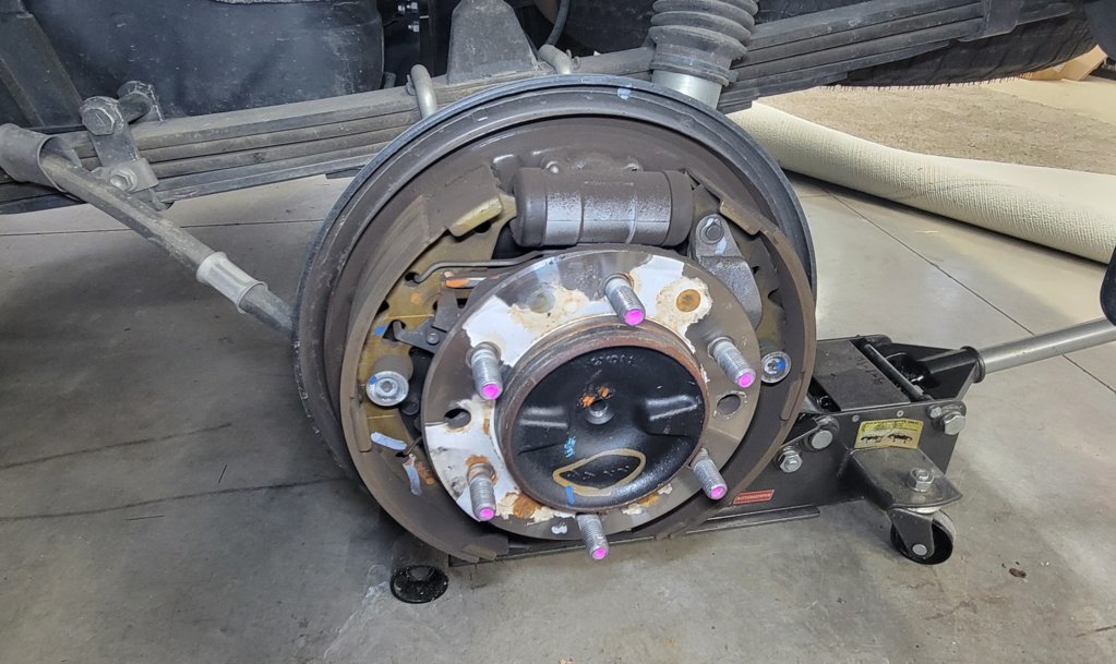

    I agree that it's unlikely that the shoes have much wear. It just seems there's a little bit of vibration when lightly applying brakes while backing up.
    I've only noticed it in reverse and when the brakes are lightly applied.

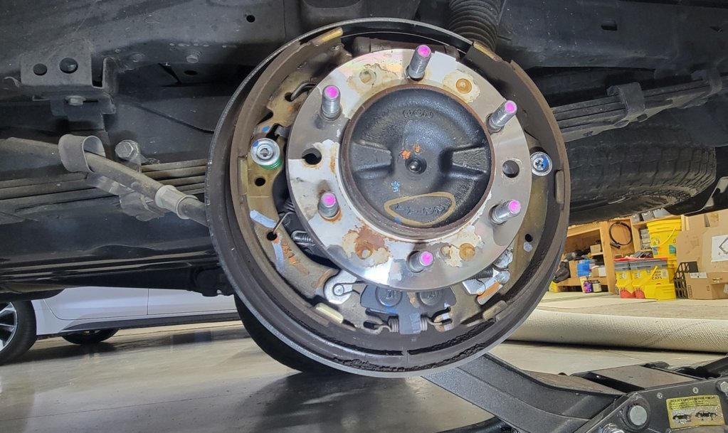

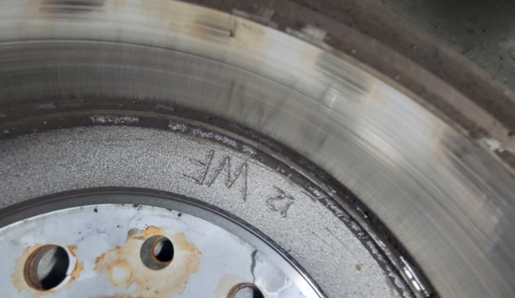

    All looks normal to me except for the layer between the drum and hub.... I'm not used to seeing that.
