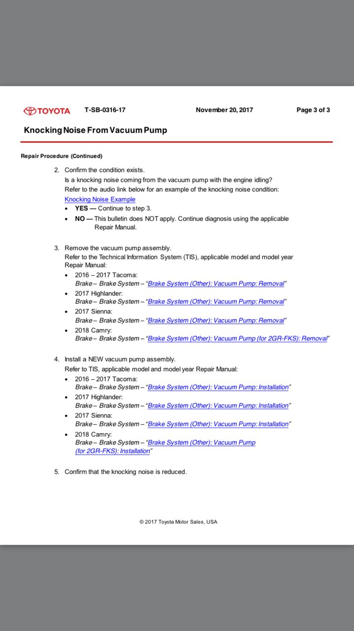

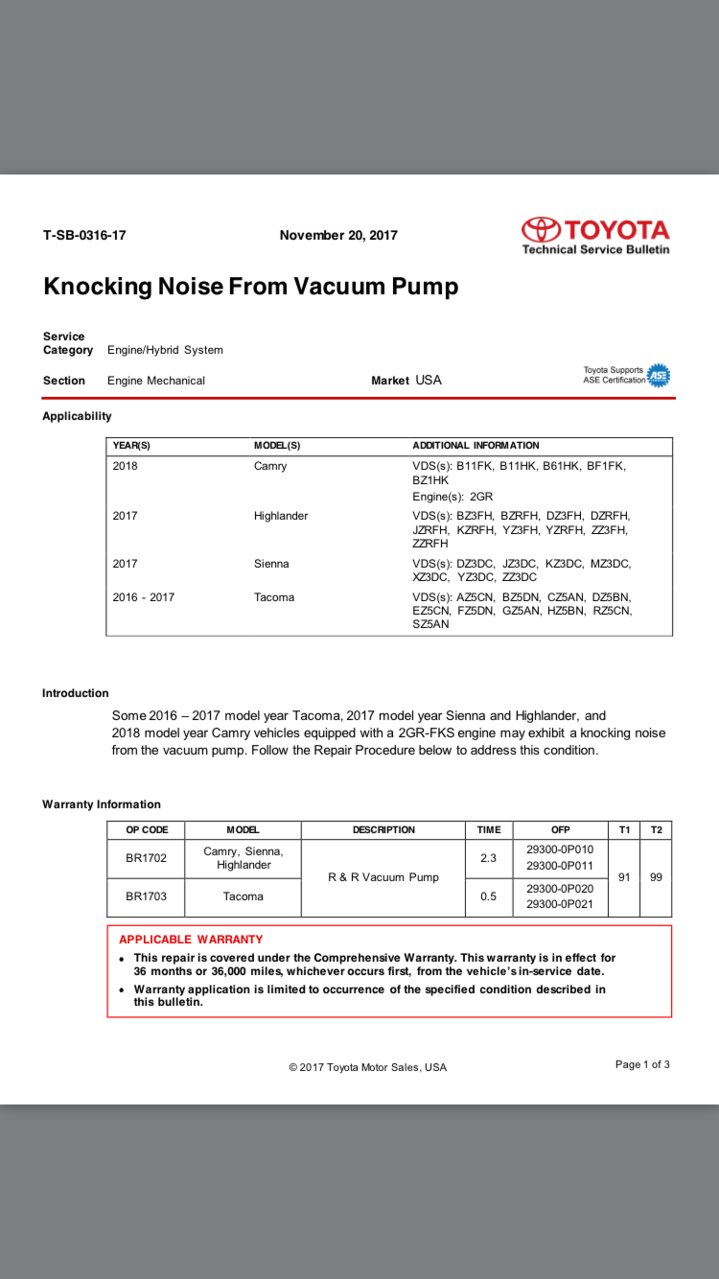

    Do TSBs apply out of warranty? Similar to a recall?

    It says in the TSB at the bottom on 1st page. This is one is covered by the 3/36 warranty.
