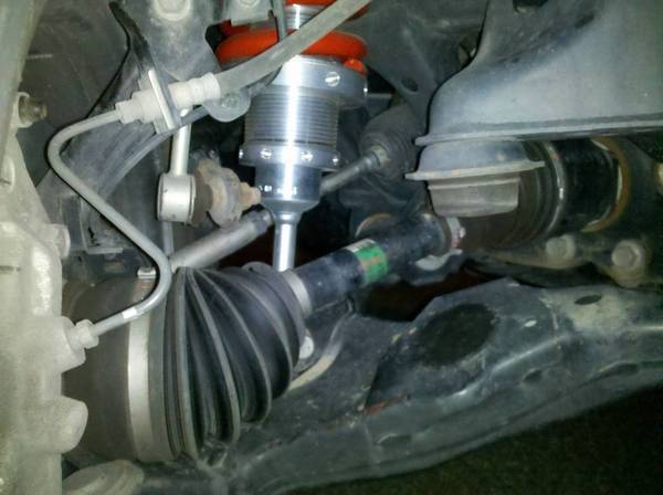

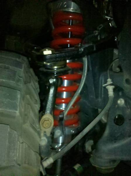

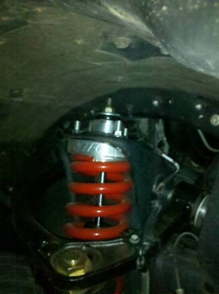

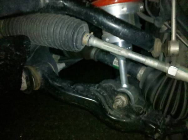

    Can you post a pic of the setup on the truck? Maybe we can tell if something isn't installed quite right.

    I wonder if they are using a stiffer spring now or something that is causing the difference. The shocks appear to be barely compressed if at all under full load; this would explain the rough ride I'm having since it seems like the shocks are slamming at the stops. I'll work on pics

    Can we see some pics?

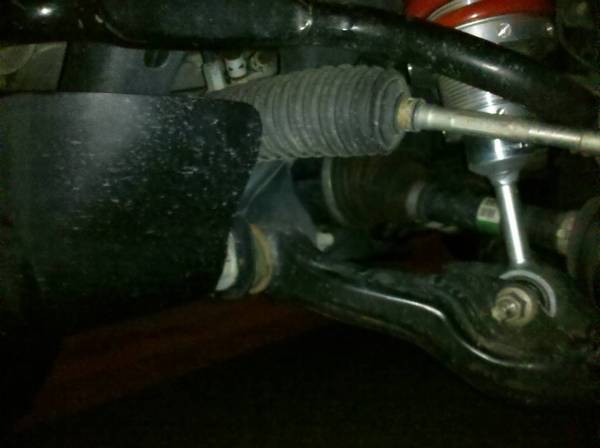

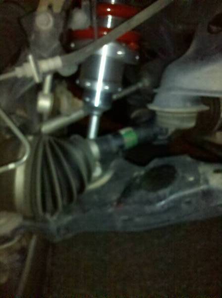

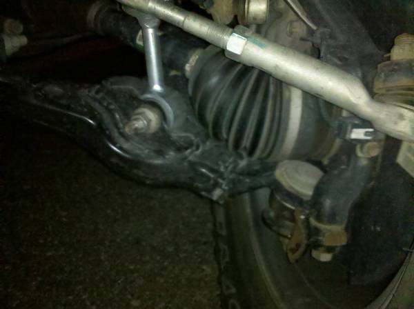

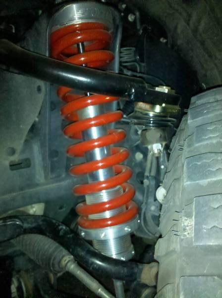

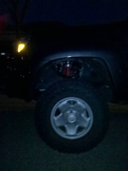

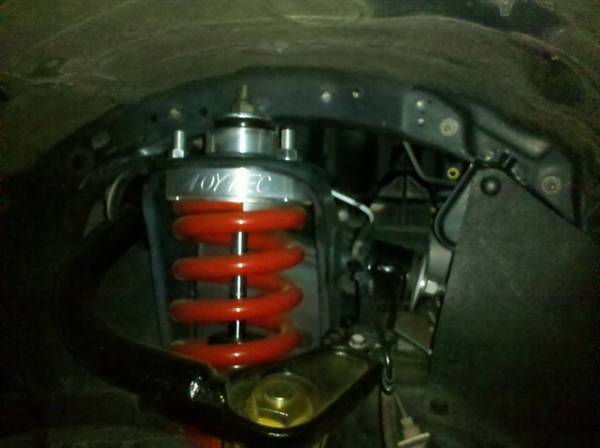

    Driver's Side, From the front

  16. Dec 3, 2010 at 4:06 PM

    Pics are all of the driver's side. Passenger side is identical.

    Its hard to tell when you turn the wheel when it compresses the boot already.

    To tell what? I know my cv angles are out of spec. The pics were for those wanting reference to if I had installed the lift correctly or not. It was the only way to get a decent pic in the dark and with the wheel on.

    Those look like they are installed fine, but you need to crank them down, otherwise, your gonna eat CV's.

    Thanks! I'll drop it down 2 inches.
