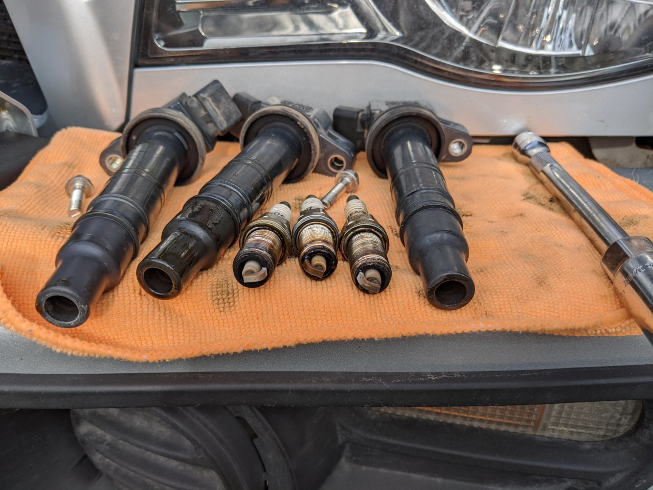

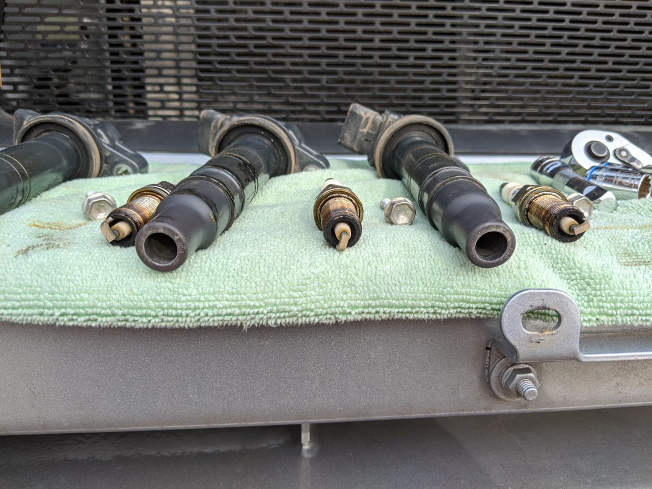

    This week is spring break for me as scheduled. Stay home and be lazy. Accomplish as much as possible if I got the urge to be productive. I saw my odometer has crept over 125k and figured it was about time to do spark plugs since I had the hood open for an oil change as well. Big thanks to @teamhypoxia for the recommendation to grab this ratchet from harbor freight all those years ago....job was less than an hour with the prior knowledge and a tool to make things easier. Sure wish spark plugs came gapped correctly as that's the biggest stress of this job for me
    @thefatkid is this a head gasket or valve cover you think? How should I diagnose.
    Orange is driver if standing at the fender green is passenger. IMG_20200316_165958.jpg IMG_20200316_165938.jpg
    Good bit of oil on that coil #4 and the plug as well..... Not what I had hoped for overall I don't think. I don't see much around the head area l as far as messes go and it hasn't felt down on power but maybe it is over time I'm not sure

    you spilled it down there doing an oil change.

    Was the plug loose to remove? Looks more like a weak seal on the spark plug gasket allowing combustion gasses by

    . Yeah it was none of them needed much to get them out which surprised me.

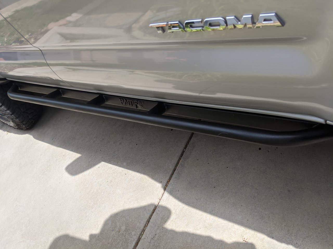

    Bumper is at powder coat now. Got a few items left in my pile and a few others I need to add to it. Have a bit of maintenance to do as well. Most of which is on hand. Some relearning to do too for electrical and other wiring needs. Need to relocate fridge a bit to accommodate bedside stiffeners. Nice to knock a couple things out

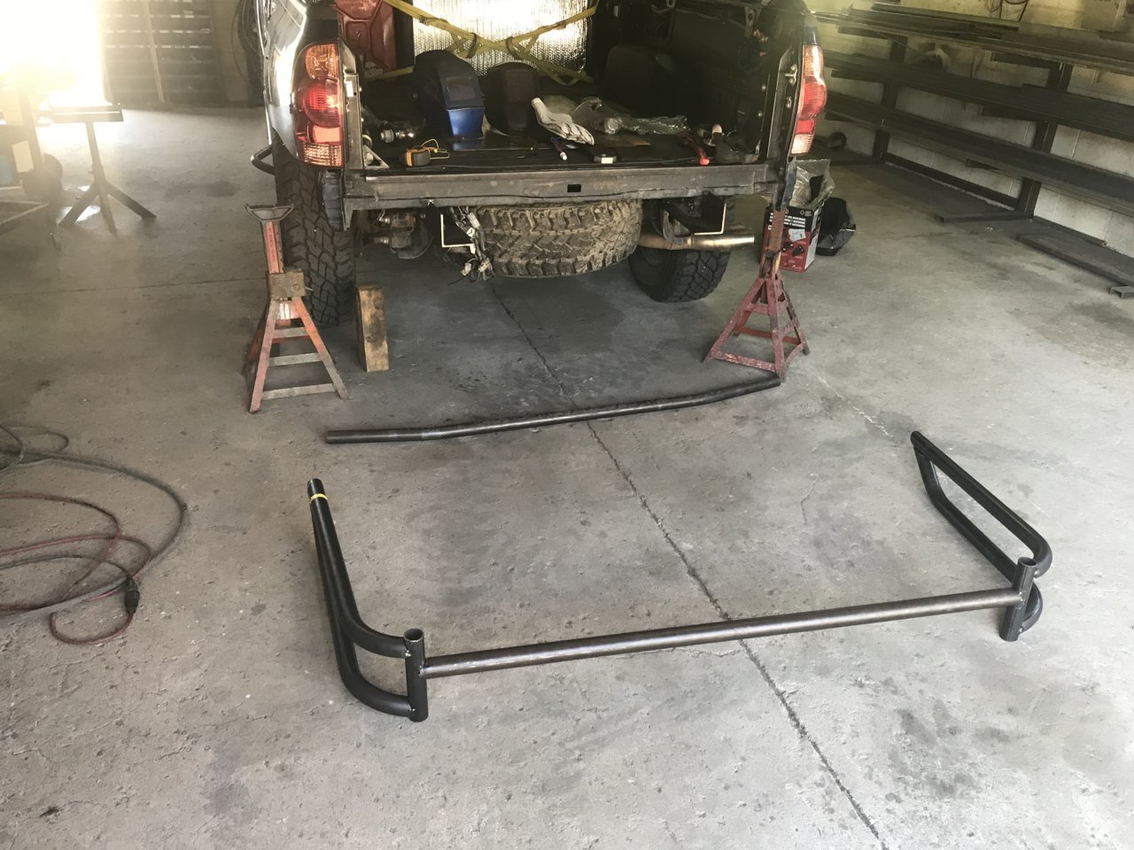

    Still need to get it completely bolted on and level but I'm at a point where every adjustment moves the other side out of alignment. Time for beers and a spare set of hands. Anyone available?IMG_20200717_123416.jpg
