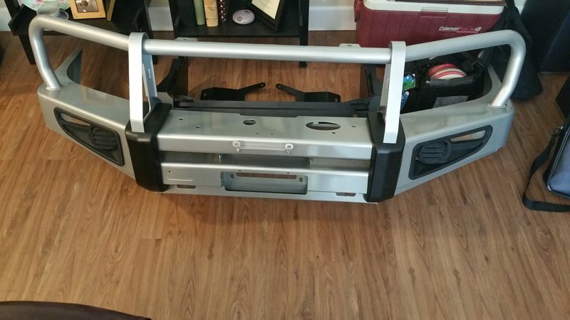

    that ARB turned out awesome!!

    @odomandr I was in moab this past weekend. Sorry I was not around to lend a hand. You get that bad boy bumper installed?

    I did not. Thinking I may wait a couple weeks til I can buy a winch and install all at once

    yeah id wait if you plan on installing a winch anytime soon after installing the bumper. do it all at once with a few helping hands to get it all lined up while someone else puts a bolt through. I would have been very upset with myself if i didn't do it all at once and my bumper is LIGHT

    Unless they changed the design on the ARB that front valance panel comes off and I used to just bench press my winch up into the bumper and someone else started the bolts for me. But the ARB is designed with the winch feet forward which is different from most. You also have to clock your winch motor due to this design.

    Yes the bumper valance comes off from the frame mount. Makes bolting it together a bit easier. With the winch mount setup I will have to clock the winch motor too. All that said i think it will be easier to install the winch with the bumper off and then install it all n the truck at once

    That's exactly how we mounted it on my buddies ARB. It was actually pretty easy to do. I benched, he fed bolts. Definitely a two person job.

    Keep in mind the winch will add roughly 50 pounds to lift and align.

    Apparently the bumper hangs from the mount (like walk away and look) and then you can bolt it down. Still think I'll need a hand to get the job done

    It's kind of hangs Andy. It will not sit level to let you walk away and look at it. Also after spending good money to get it powder coated to match the last thing you want to risk is having it fall off. It's a heavy bitch with the winch installed. I have done a couple of them.
    When you are ready to install let me know. If I am available I will certainly lend a hand.
