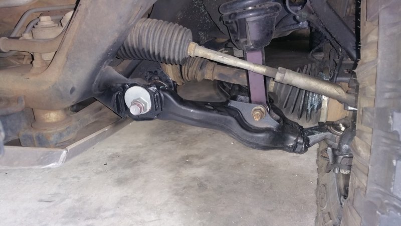

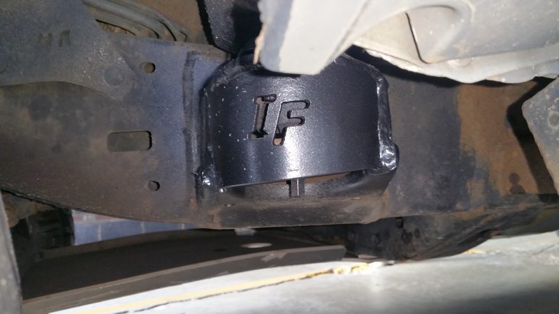

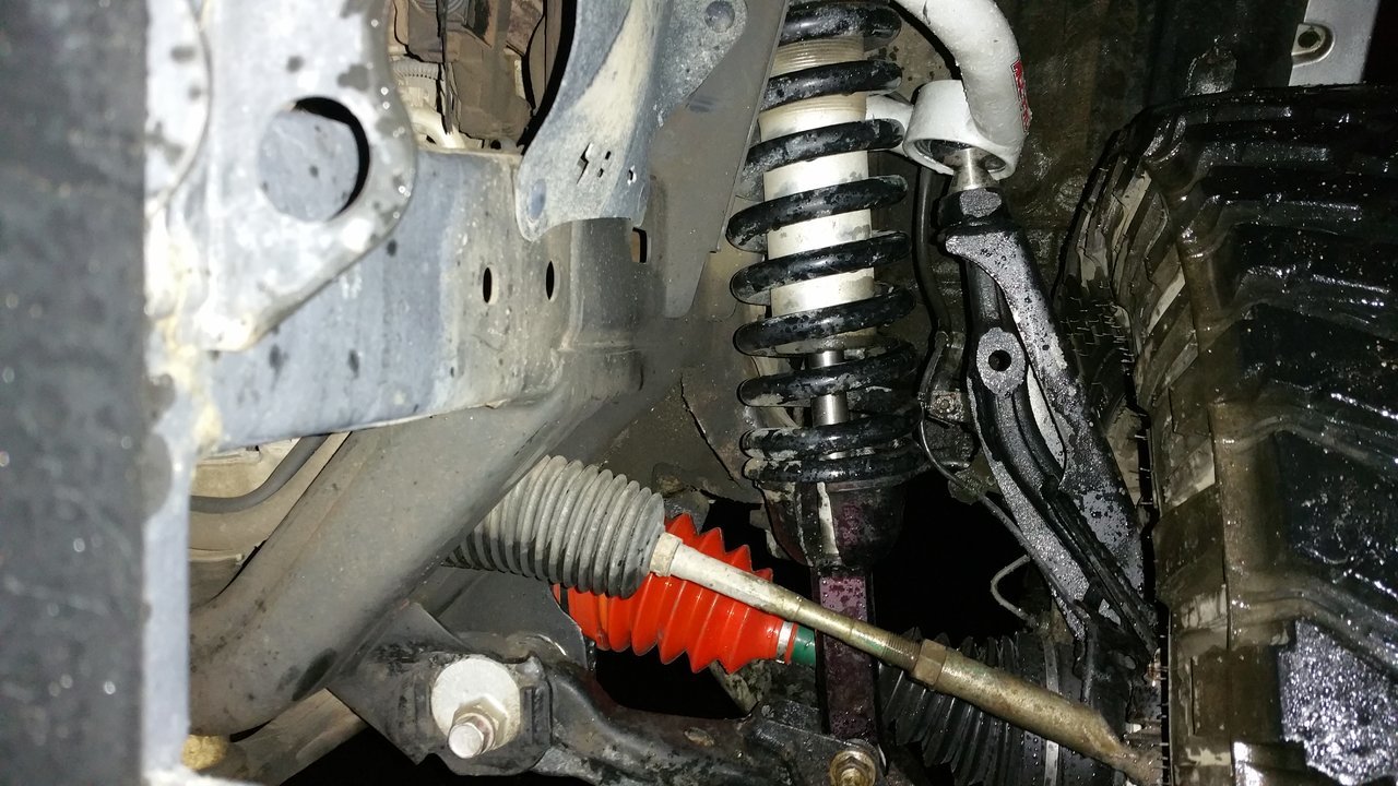

    Left the truck with Corey to burn some metal on my truck this week.

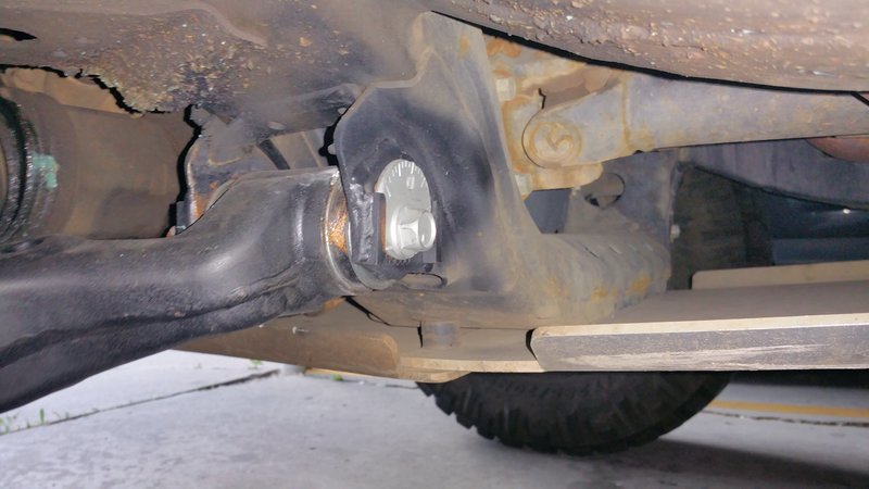

    New Total Chaos alignment tabs, newly refreshed A arms with Whiteline bushing's and OEM cam bolts and Corey did the BMC while he had it. Very pleased with my experience at Insain Fab as usual20170601_191418.jpg 20170601_191429.jpg 20170601_194852.jpg

    Spent last weekend finishing the front end refresh. Got the ECGS bushing installed along with new CVJ axles and oem seals. Ended up putting the TC gusseted spindles and All Pro uniball uppers on as well. Got an alignment today and a few items to rebuild the pile that is disappearing. I have spindles and lower arms if anyone wants to borrow for a rebuild. @YamaDirtrider is first in line for the spindles to gusset. 20171002_005415.jpg
    Preview of what's to come:
    Still have a short list to complete before I deem it Rock Therapy ready.

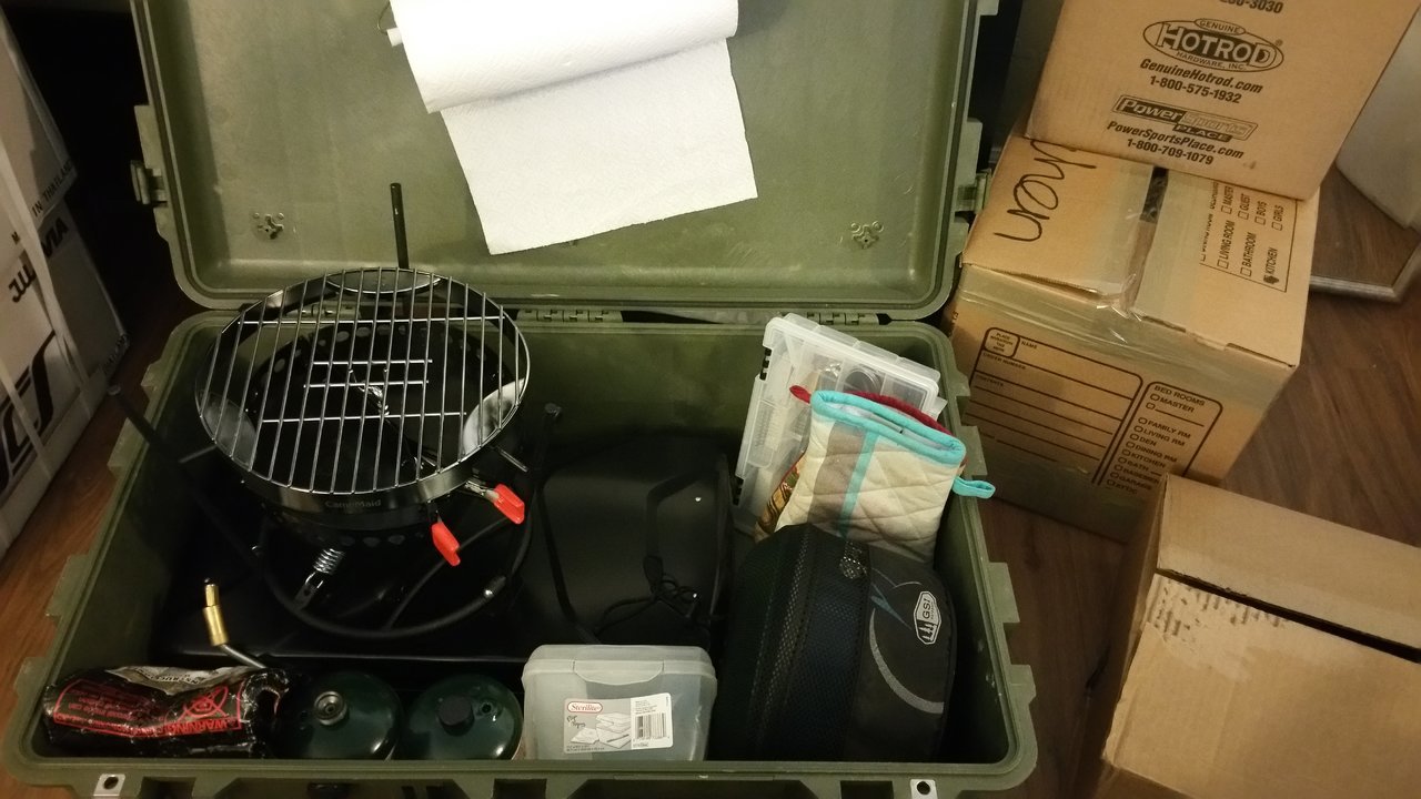

    I've considered building a chuck box for some time now. My storage bins were never the right size for it all and left things disorganized after a day bouncing on a trail. After a bit of research I found some pelican boxes on Craigslist that were missing the foam. The 1650 pelican will hold my Coleman Triton stone, a few cans of fuel, my GSI mess kit, silverware tray, the campmaid grill/Dutch oven system and bag of charcoal, random kitchen utensils and a box of dish cleanup stuff.20171005_110849.jpg
    I still have the personal msr stove and a personal mess kit behind the seat but this should be much better when cooking for more than 1. I still have room for a shallow 8" dutch oven (my larger 12" deep oven is too big) and a coleman gas grill, also plan to order one of the mesh lid organizers for spices/oils and utensils to further organize this box. It also has the wheels on it like a suitcase for easier transport from truck to picnic table. Hoping to give it a test run soon

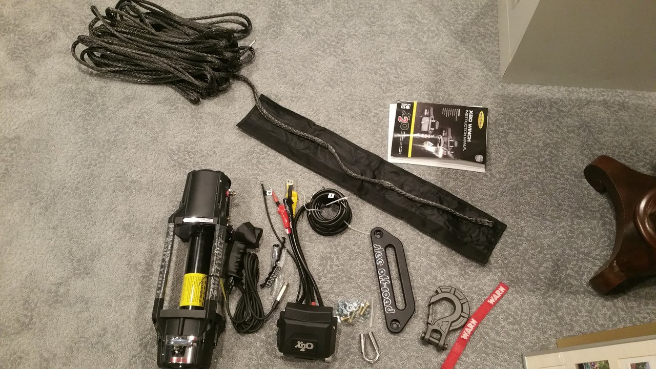

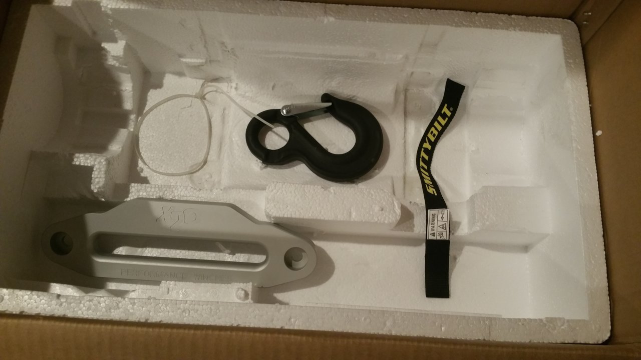

    Got a solid deal on a smittybilt winch. The x20 10k comp has a lot of solid features like ip68 rating and synthetic dyneema line along with a solid warranty. I pulled the brummel out and will replace the hook from smittybilt with a warn epic hook I got via raffle. I also swapped out the fairlead for an offset fairlead from slee to fit my arb bumper. I hope to clock it and install it soon but I need to get some longer wiring to extend it into the engine bay as I don't particularly care for the solenoid on the bumper either. I also need to grab a rubber bumper stop to keep from marring the fairlead. 20171118_072839.jpg

    How much wire are you thinking you'll need?

    Why'd you pull the eye out?
    Looks like that hook would've attached to it?

    Smittybilt hook might have had a closed loop, no clevis.

    You should have gotten the 1.5" thick custom Spice offset fairlead so you can clear the sides of the ARB bumper when conducting side pulls.

    not sure need to unravel the bunch and guesstimate.
    see below
    correct, it also has a tube abrasion thimble that i could not easily replace like th open side ones. Also good to practice the locked brummel splice and may order the hypoxic fancy fid 20171118_072827.jpg
    it hadnt been released last year when i got the one from slee. this one will do for now.

    Should have been released, I worked with them over 2 years ago to develop it.
