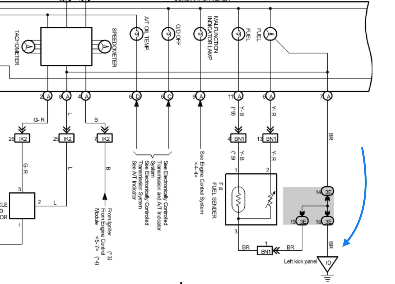

    I do not have a wiring diagram for my 1999 3.4L v6 4x4 Extra Cab Pickup. I tried adding a ground to the fuel tank harness no joy. Is there some common point(power/ground) in common between the ODO and Fuel Level?
    Anyone have access to the Fuel Level & ODO pickup to/from the Gage Cluster?
    Can I test the ODO pickup easily?

    Yeah, the ID ground on the inside left kick panel.
    But it could be the BN1 or 3E connector.
    Try the ground first.

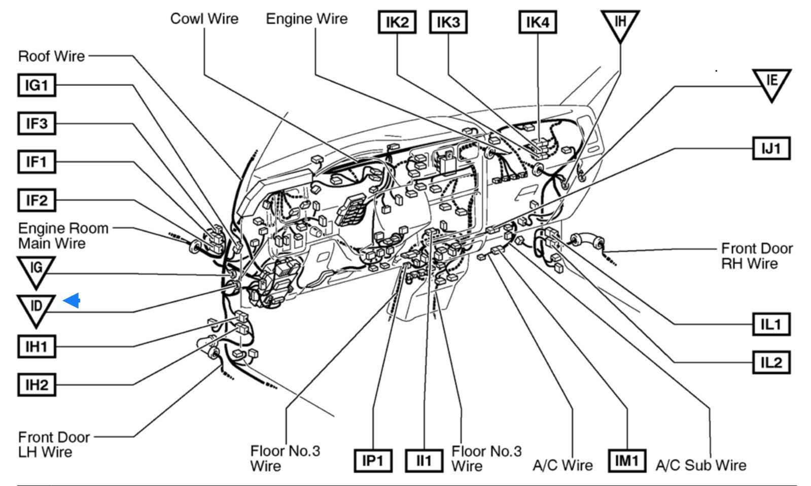

    I do not see either location of the connectors. How do I identify the correct connector?
