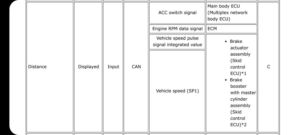

    Column 1: Item
    Column 2: Condition
    Column 3: Input/Output
    Column 4: Communication Line
    Column 5: Signal(s)
    Column 6: Component

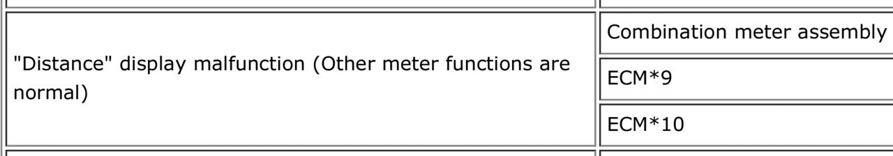

    Column 1: Problem
    Column 2: Potential problem area

  7. Aug 15, 2022 at 6:01 PM
    #27
    GRNbean
    GRNbean [OP] Member
    Aug 15, 2022
    #403618
    10
    2022 Army Green TRD Offroad
    Wow. It worked.
    But why though? It hardly seems intuitive to A) have that option/have that option be limited to just 5 digits, and B) reset it with that button. I guess I'll find some other display module to use instead since I don't have a use for that anymore, lol. I didn't even really use the trip meters to begin with, TBH. Trip B I think was automatically reset by the truck last time I fueled.
    Well, that was anticlimactic, but THANKS SO MUCH for all the speedy attention and interest. How fun. :)
