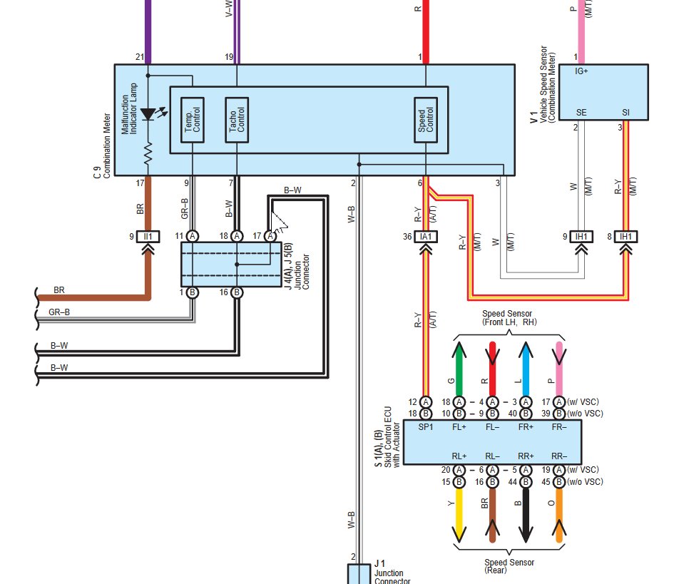

    The speedometer signal is fed from the right rear ABS Sensor to the Skid Control ECU ( Part of the ABS Unit ) to the combination meter if it is an automatic transmission.

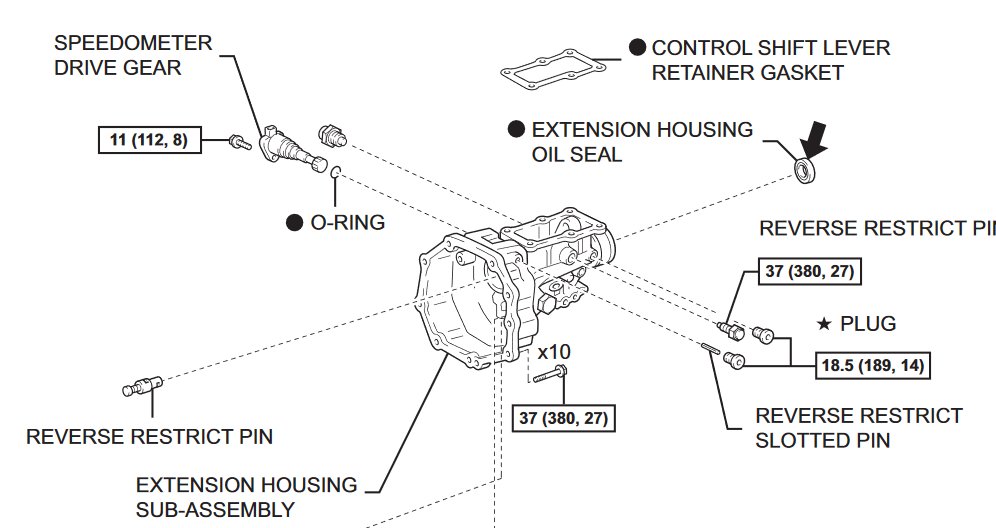

    A manual transmission has a separate speed sensor on the transmission that ties to the combination meter.
    The Tachometer and Odometer are fed from the ECU.

    I maybe wrong, but I seem to recall that Auto and Manual Trans trucks have different speedometer sensors. I could be wrong, there’s been so many different speed sensor post, it’s hard to keep up with?

    Yes that is correct. The automatic get the speed signal from the Skid Control ECU ( ABS ) where the manual gets the speed signal from the transmission sensor.

    If I would have actually looked closer, I would have seen that in the first pic you posted.
    Thanks Jimmy

    Manual speed sensor:

    Well I just realized I post the exact same picture you did.
