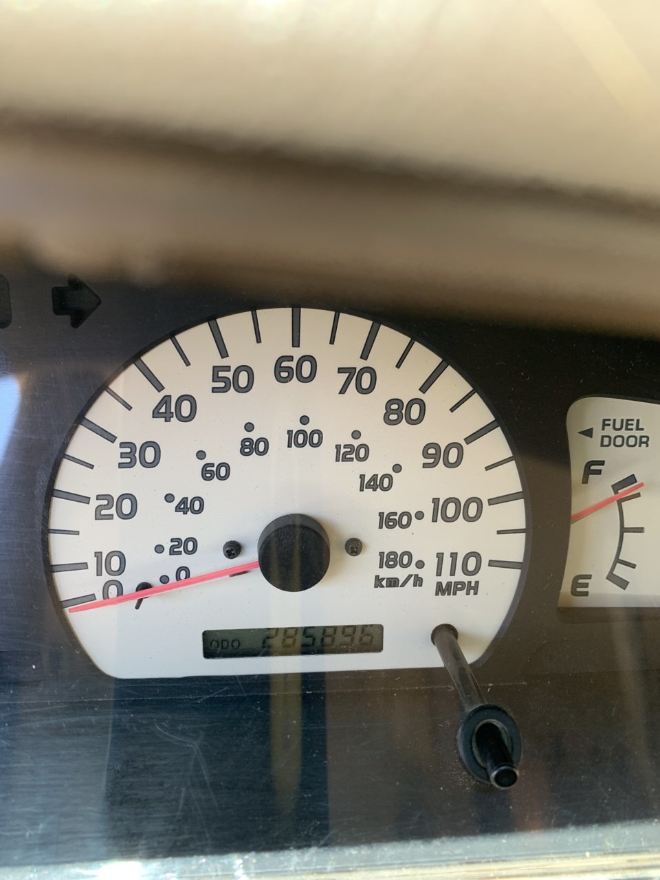

    My '02 is a digital. It is electronic with an LCD readout. Can you take a pic of your odometer?

    The odo in my ‘02 base model is analog

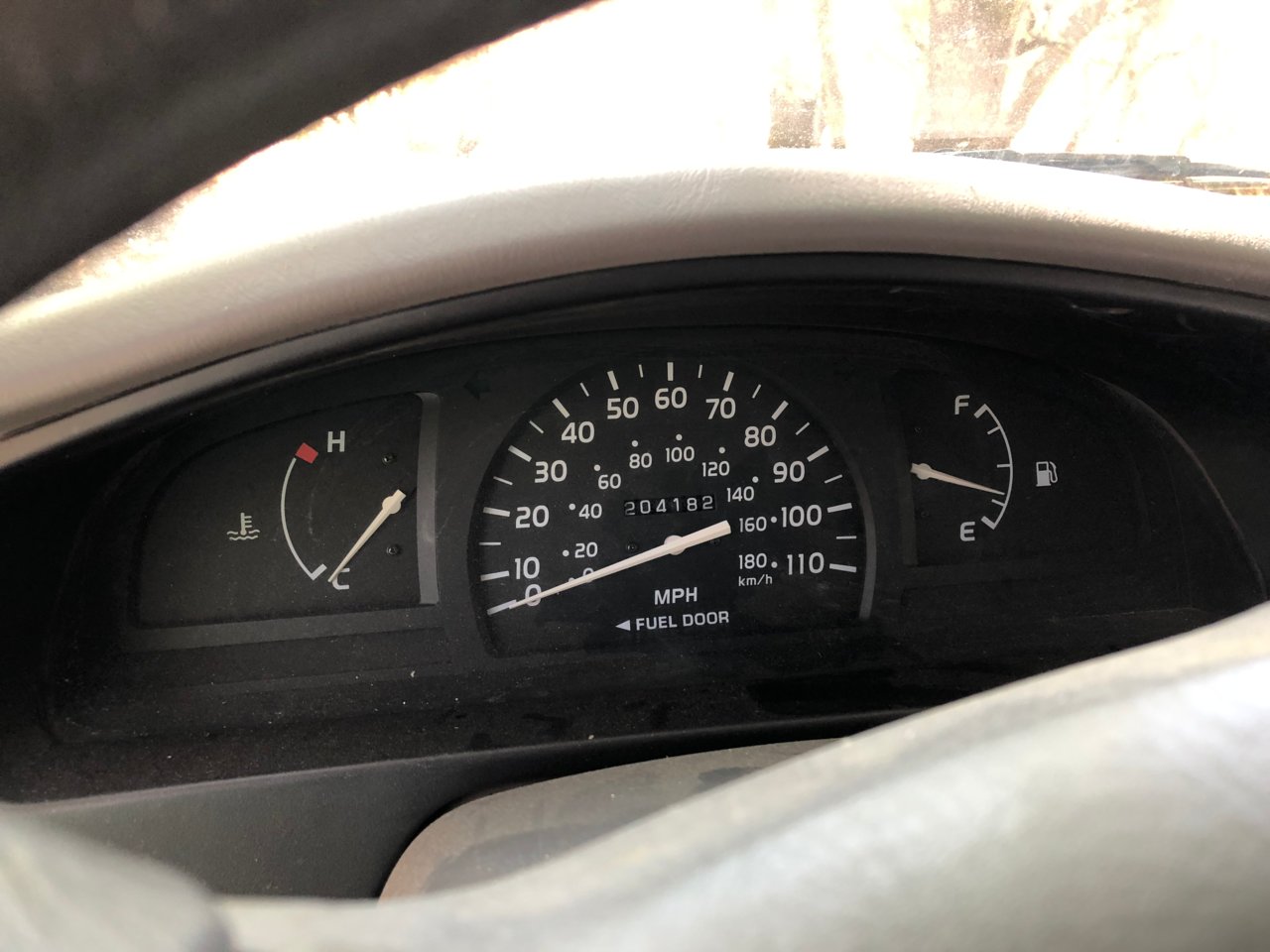

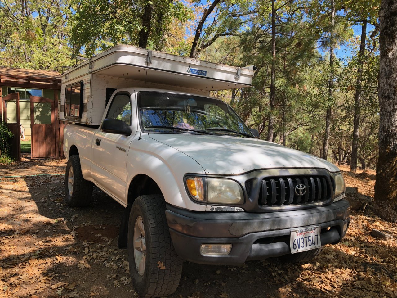

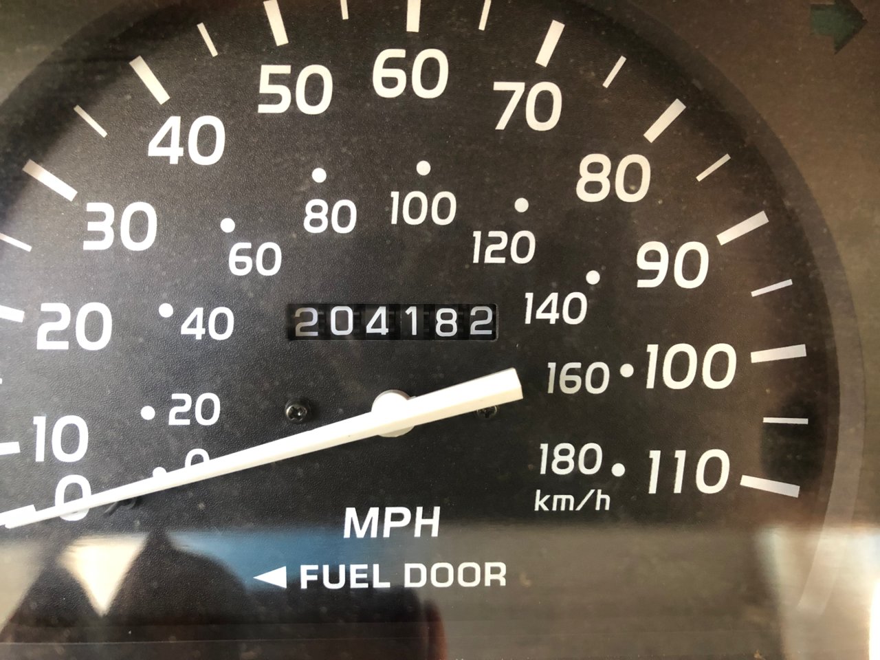

    I have uploaded a few images of my truck and instrument panel. Maybe I am misunderstanding the term "digital" so pardon me if so.

    No, you’re correct. That is what “looks” like an analog device. I’m wondering if it’s really electrical, and you could easily get a complete cluster off of eBay (upgraded SR5 or whatever) and it would be a simple plug and play.

    No, that's a cable driven analog speedometer.

    What the what?
    That can’t be original in an 02 can it? Every single 01 and up had the white face digital dash. 55143FBD-88C7-4257-ACCF-5AF2890345E5.jpg

    Well damn! Learn something new every day. I wouldn’t figure they would change that much from base model to anything else.
    If this is indeed a cable driven speedometer/cluster, I’d contact a speedometer shop and get a price on repairing it.
    I’ve not seen a cable driven speedometer since the early 90’s on most vehicles.
    If you opt for a used one, depending on different gear ratios, it and the speedometer may not be correct after replacement.
