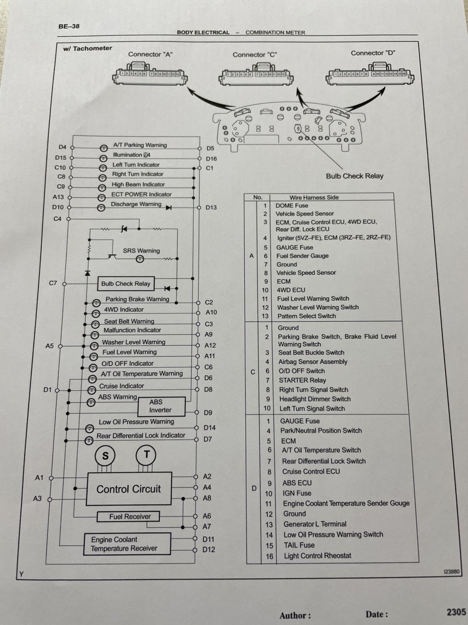

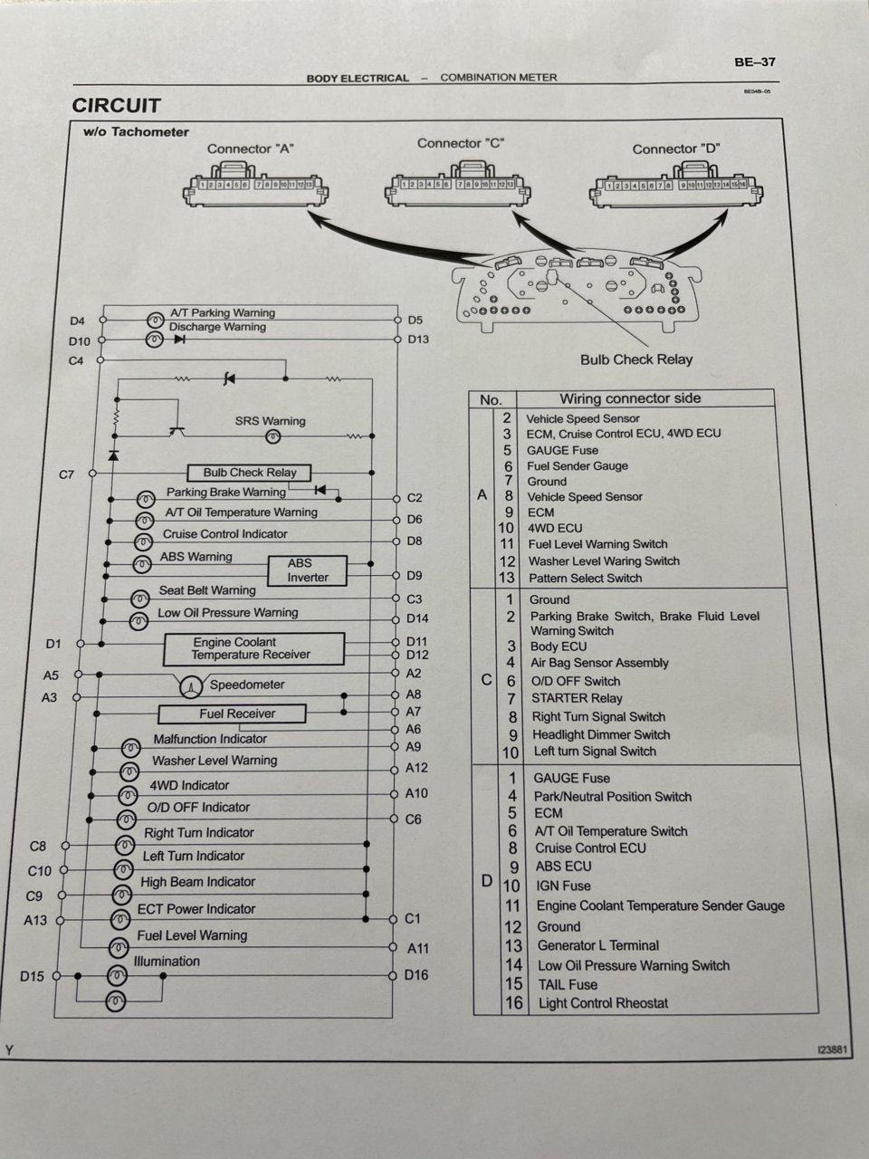

    I looked at the link of the one you purchased from eBay. It doesn’t look cable driven to me at all. It’s good that the mileage is close to your mileage. I hope it works out for you. I’m still having a hard time believing it is cable driven. I think it’s going to work. I think it’s an electric speedometer, if you opted for finding one with the same engine as yours, you could have added a tachometer. The back of that cluster looks pretty much like mine does. Three harness to printed circuit connectors, and that’s it. Here’s a photo of the link. I’m not familiar with the 4 wire connector all the way to the right of the picture.4ADA6C8C-24D5-45B2-A67B-0C564B8F1F90.jpg
    See the Phillips head screws? They all have a printed circuit running to them three for the gas gauge, three for the temp gauge, and the four in the middle are the speedometer connector terminals. These screws also mount these gauges into the cluster, you have to remove them to remove the gauge from the cluster.

    Pics are right out of the 01-04 workshop manual. Cable driven wasn’t an option, only with tachometer/ without tachometer.55B33EA2-A853-4073-BA60-8FAEED50D4A9.jpg9AF2EA59-EC53-4386-8EFA-AD956CC79A1F.jpg

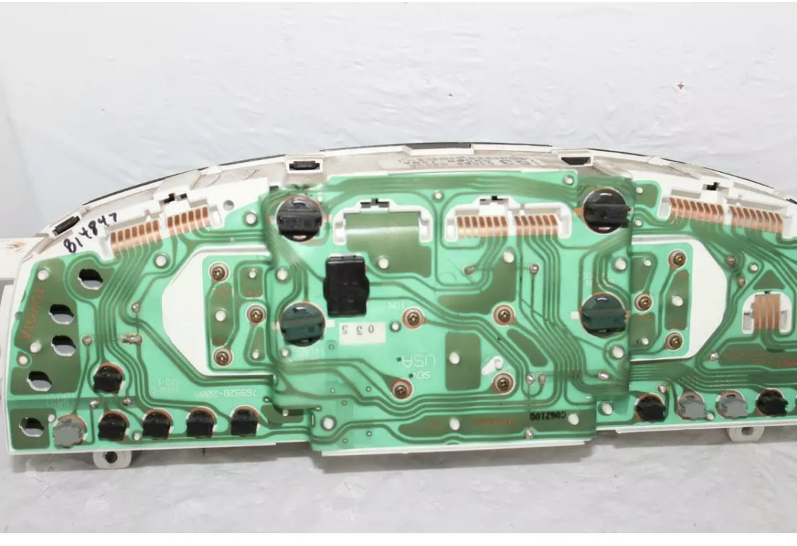

    It just occurred to me, I wonder if the one I found on eBay has the 4x4 indicator light. It looks exactly like my original, but maybe not all have the light if not made for 4x4. Otherwise, I do believe it is plug and play, as the seller indicated.

    It should have 4x4 as the clusters were mass produced. It may not have a bulb in the 4x4 slot, but you can easily remove the bulbs and use a small flashlight to see what slot is what. Also look closely at the printed circuit to make sure it looks just like yours, when you get it out.
    Push come to shove, it’s very easy to remove the clear plastic face of the cluster, then the four Phillips head screws in the back and swap only the speedometer itself from cluster to cluster.

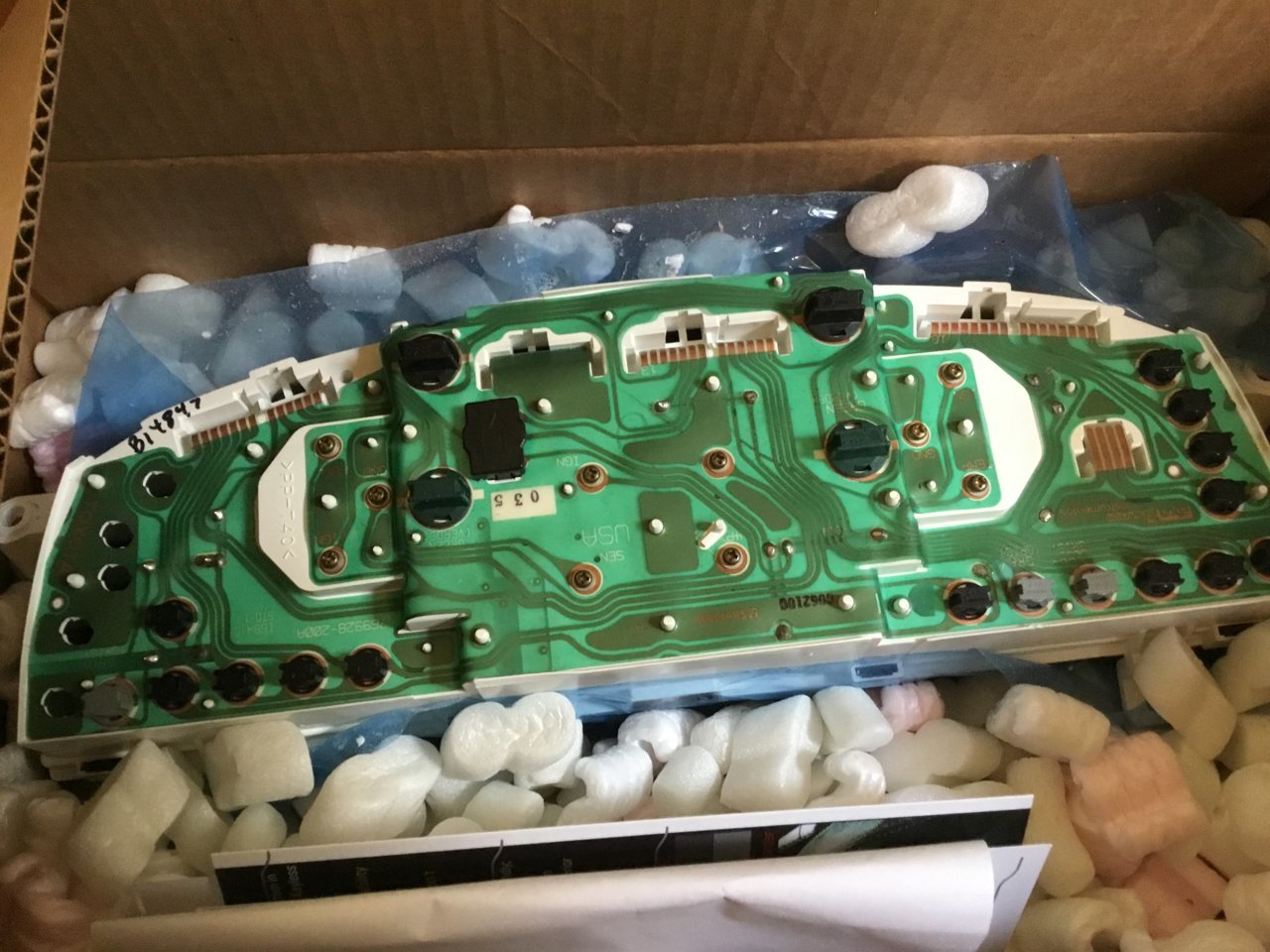

    Just received my instrument panel from eBay (instrument cluster store). Here is a photo. It is the same one as posted above. I will have it installed after I return from vacation. The strange thing is that my old odometer works intermittently. I can’t figure that out. Does anyone know why it might do this? Thanks again for all your input. image.jpg

    The motor that turns the odometer is probably going bad. Ford rangers were bad for this exact same problem in the 90’s. The problem should be internal to the cluster because you stated that the speedometer works all the time. Now that you have a replacement, smack the instrument cluster with your fist while it’s not working, most of the time it will start back counting.
    On the other hand, you could leave it alone….keep some miles off of your truck. That’s totally legal! Ha-ha!
    All jokes aside, I like to know my mileage for services and whatever.
