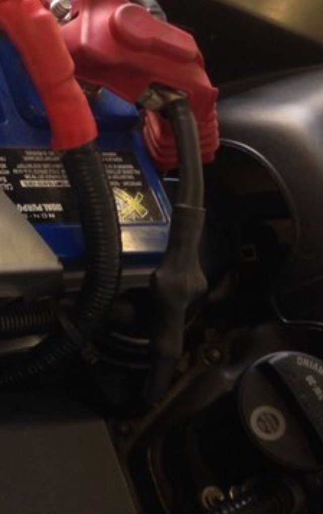

    I ended getting a terminal connector that made it barely long enough. There is a write up somewhere on TW on how to take apart the fuse box. Requires placing multiple zip ties on the attachment tabs. Let me see if I can find the thread.

    Ah, yes. The only part of this mod that wasn't plug-and-play.
    I cut about a 4.5-5" pigtail of AWG 6 (I think). Not 100% on the gauge size, but it's whatever the stock wire is that feeds the under hood fuse block. I solder slugged two eyelets on it and used marine-grade heat shrink on the connectors.
    Then all you have to do it connect it to the old wire. I used a short bolt with a lock washer. Cranked it down as tight as it would go. Coated it with some liquid electrical tape, and then wrapped the entire connection point with a large piece of marine-grade heat shrink for good measure. This keeps moister out, isolates the connection, and basically wraps the nut in place. It will never loosen.
    I have over 12k miles on this modification now. Lots of forest service and BLM roads. Schnebly Hill in Sedona and the White Rim in Moab. No issues to report, still holding strong.
    I didn't want to cut the old wire and solder on an extension or anything like that. I prefer to keep OEM wiring harnesses intact. It makes the modification reversible if you ever need to revert to the OEM set up.
    Here's a screen cap of the pigtail from one of my earlier photos:
    Please let me know if you need any further info or photos.

    This would be the preferred long term solution. I was strapped for time when I swapped in my Group 31. I took the Taco for a cross country trip the next day ¯\_(ツ)_/¯.
    Add this to the list. I may have to undertake this cable swap in the fall. I need to catch up on some nickel and dime projects that have been put off for awhile.

    Hey @yonah can you post up some more pics of the extension, I'm about to tackle it today at some point hopefully. This is the only thing holding me back is the extension part.
    Did you just do the small wire to the fuse box or the big wire going to the alternator or wherever it goes

    IMG_0358.jpg Finally got the X2power battery installed. Had to buy a longer battery cable and bolted together to the factory one. I put liquid electrical tape and heat shrink together.

    Looks good!
