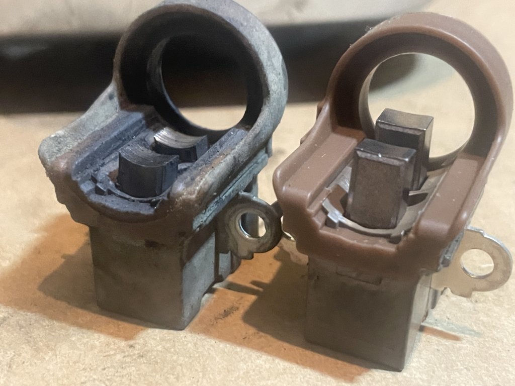

    I checked my original alternator brushes today at 316k. One is gone but the other still has some life so I'm sending it. I figure another 100k.

    Impressive to see them that good. They used a good quality brush on them.

    Holy Crap
    Excellent Documentation !!
    Thanks!
    so any “layman’s” tips
    (Just big ones)
    On disassembly of said alt?
  7. Sep 21, 2024 at 8:07 PM

    First I unclipped some wire harnesses out of the way, removed the wire harness plug, the voltage wire, a steel bracket, the oil dipstick bracket, and then the alternator bolts and adjusting bolt assembly which all was easy once I saw how to do it.
    Once off, a few 8mm bolts and one 10mm bolt opened up the back cover, and then two JIS screws on the old brush assembly. Air blasted out tons of black dust. Then reassemble and clean the outside with a copper brush and a rag soaked in brake cleaner.

    did you get the brushes from the Toyota dealer parts dept?
    if Y, do you know the part # still?
    i am now curious how the brushes on this original alt are looking
    it was tested as working properly yesterday when truck got a new battery

    27371-70300
    https://parts.earnhardttoyota.com/oem-parts/toyota-brush-holder-2737170300
    Looks like it's only $5 now from the dealer.
