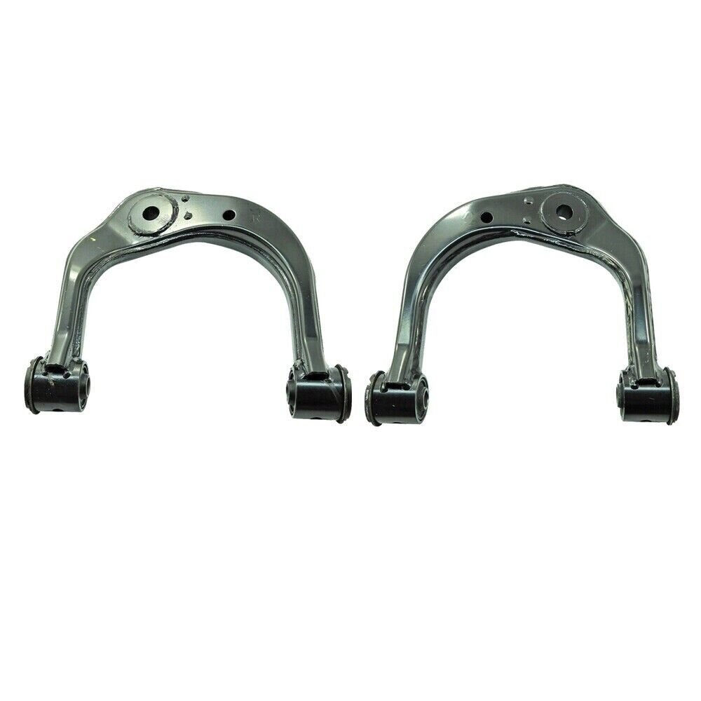

    2003 ExtraCab 4WD, TRD 3.4L, recently replaced OEM LCA's and LBJ's. Not looking for lift, staying as stock as possible. While I'm hesitant to stray from OEM, the prices are just too enticing.
    Anyone use OE brand UCA's? Not seeing anything specifically in a search. What's the record on OE brand? I'm thinking if they will last a while I could take the existing UCA's and put OEM bushings in them for later.

    I’d just refurbish your existing ucas and be done with it .

    That takes time, a commodity I'm not long on since I have to work 10 hours a day. I question the ability to get bushings pressed out and back in before 3AM Monday morning. :p
    The second option is to replace the entire UCA's like I did with the LCA's which would probably be doable in a weekend, but the cost is going to push back new coilovers/shocks for a while. With aftermarket UCA's and OEM upper ball joints, I might be able to pull off coilovers and the UCA's in one weekend and my "financial manager" won't have me sent off to the loony bin. :p
    Moog uppers are also a thought, but was wondering if anyone has used OE brand uppers.

    Hit the BST/car-part and find a used set of OEM upper arms. Change the bushings out for OEM ones (DIY, or a shop). Repaint them. Install them. OEM quality at a fraction of the price. Then pass on your used upper arms so the next person can do the same.

    I did this with OEM LCAs. Bought a set on here used, took my time extracting the original bushings, and hand tapped in new Whitelines. Still drives smooth AF. In my case I kept my originals just to have in case.

    If you can't find OEM arms, just get whatever brand you want, and then swap OEM bushing into them. The Moog arms themselves are probably fine, but the bushings are shit.

    It's just a brand out there floating around, maybe they're hoping someone will misread OEM LOL . . . they have rubber bushings, probably made in China.
    I was just asking if anyone had used them and what their feedback might be. I see a lot of aftermarket uppers here on TW but it's obvious most of those owners are throwing a lot of money at it and do a lot of offroading, this is a daily driver and it won't see a lot of bashing.

    Haha no. That's why I was asking, to see if anyone's used them and what their input was. I'm even wary of Moogs, in the end I'll most likely get OEM UCA's or re-bushing some used OEM's, but it will take all year to work it into the budget. Need to get this all resolved so I can enjoy those fabled "golden years" LOL
