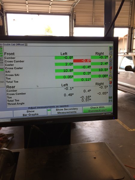

    Here are my alignment specs from about 4 months ago after I installed them. What I'm worried about is I had it done at my college auto shop and they went off the factory specs. But if you have aftermarket UCA's. Can't you get more out of them?

    Anything is possible, looks like it is close. Best bet would be to have someone who is familiar with doing alignments on lifted vehicles check it out. Correct most aftermarket uni-ball style UCA's have added caster built into the arm, around 3 degrees or so to aid with the alignment on lifted vehicles.
