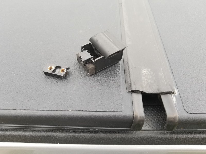

    Anyone have a P/N for this peice from my Tonneau? I can't find a good assembly diagram anywhere. Drivers side. Thanks in advance!

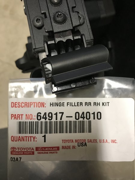

    If it is for the right side of the tonneau 64917-04010. This is the smaller of the two seals on the fold closest to the tail gate. I don't know the number for the left side. It was $25 approximately

    Thanks I'll cross reference that number. The bastard broke off when I took my cover off. I ordered what I though was the correct part but I have to return it because it wasn't even close.

    I can't help but just wanted to say thanks because I just got a good deal on a factory tonneau cover and the passenger side was broke. I'm going to try and super glue it for now but want to replace it and I couldn't find the part number either. :thumbsup:

    This is for the passenger side, but since you have you rubber piece this part number will work. You can remove the rubber with a torx bit in the center if you push the rubber to the side.

    64915-04010 - Front Joint, RH
    64916-04010 - Front Joint, LH
    64917-04010 - Rear Joint, RH
    64918-04010 - Rear Joint, LH

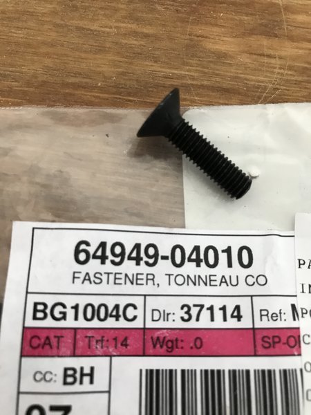

    I think it's 12. From my measurements, these screws are countersunk M6 25mm pitch 1.00. If you want to save yourself $30, you can get them from the hardware store.

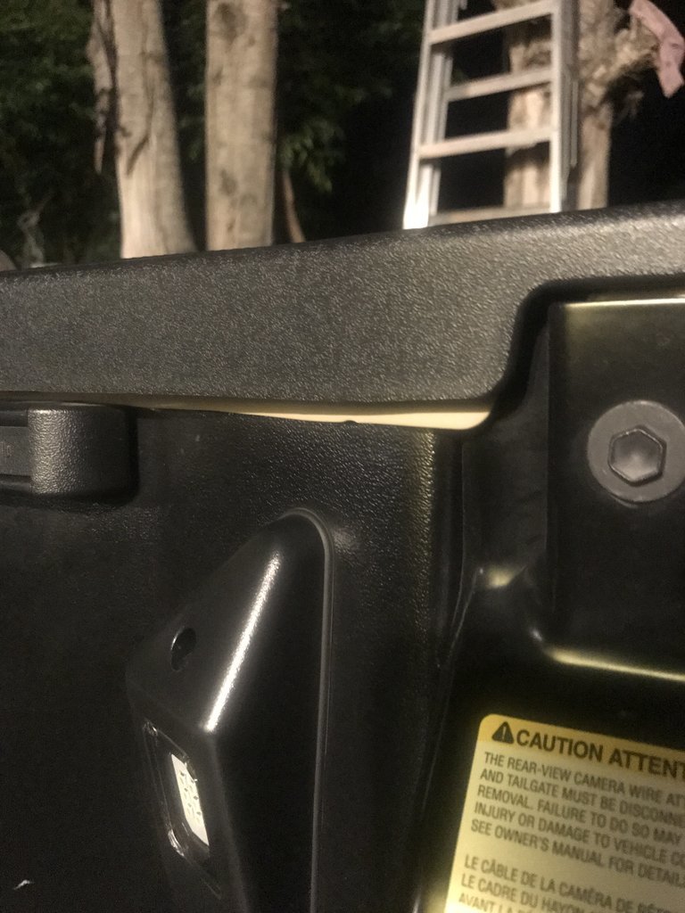

    Maybe you should take a picture of the area in your bed so I can better understand what you are looking for. These are the bolts that hold the pins into the side rails.

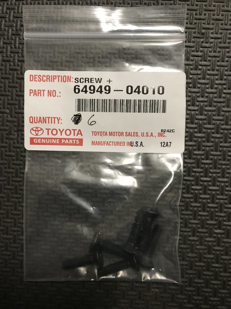

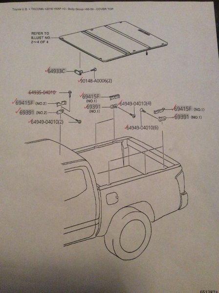

    I think it's
    69391 & 69415 plus those screws 64949
