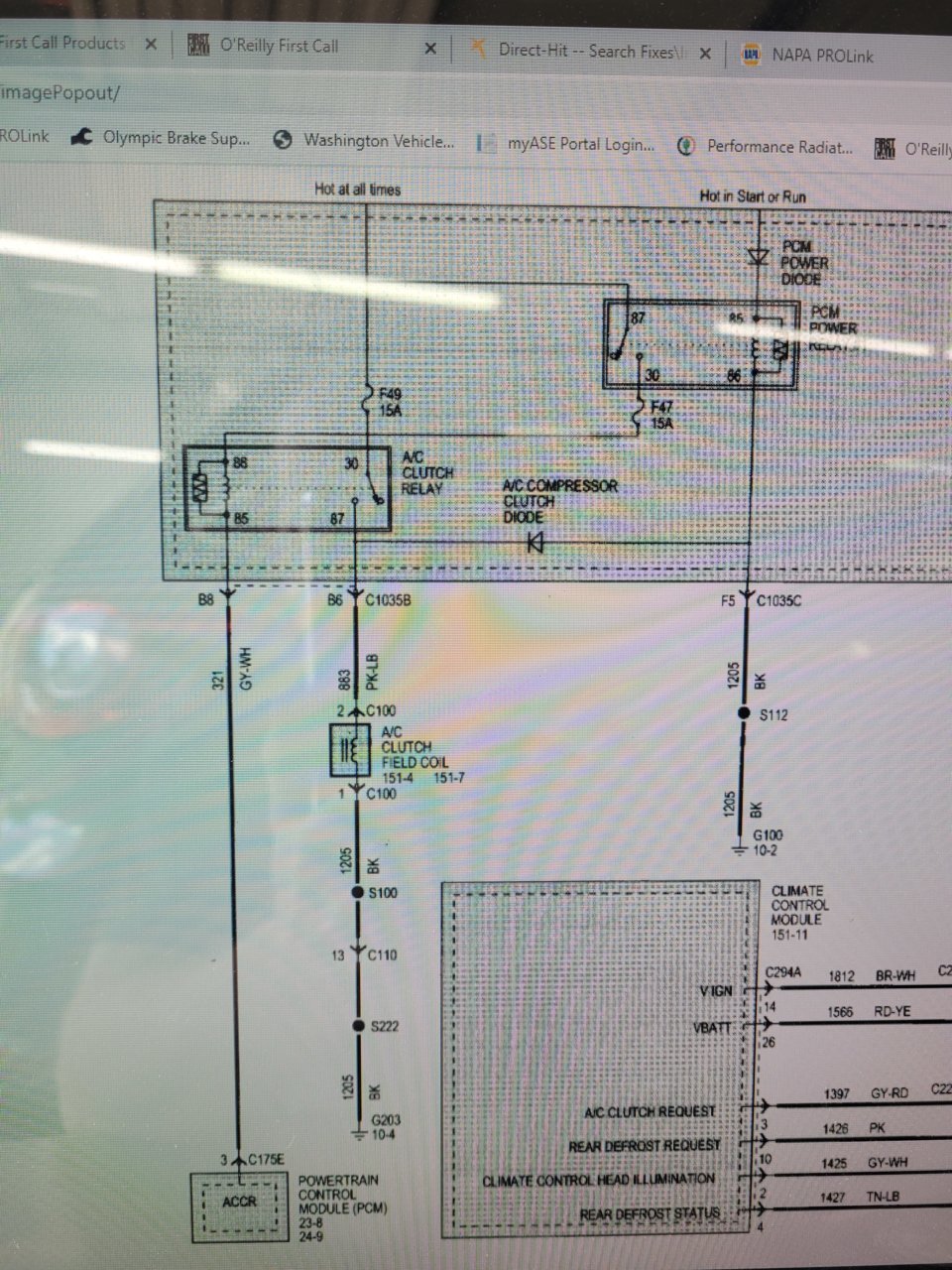

    Dead short on fuse 49 - AC Clutch fuse. It's a relatively simple circuit, more looking for connector & splice locations, as well as a the physical location of the diode (I assume under the PDC, but not sure) to check.

    This is a 4.0 but it should help
    Sorry about the crappy pic. The upper gray boxed area is the Bussed Electrical Center (BEC). Looks like the relay/diodes/fuses are all in there. The relay might not be serviceable if it's built into the fuse box
    If you can't see the diagram I might be able to email it to myself and get a better pic to post
    tirediron[OP] likes this.

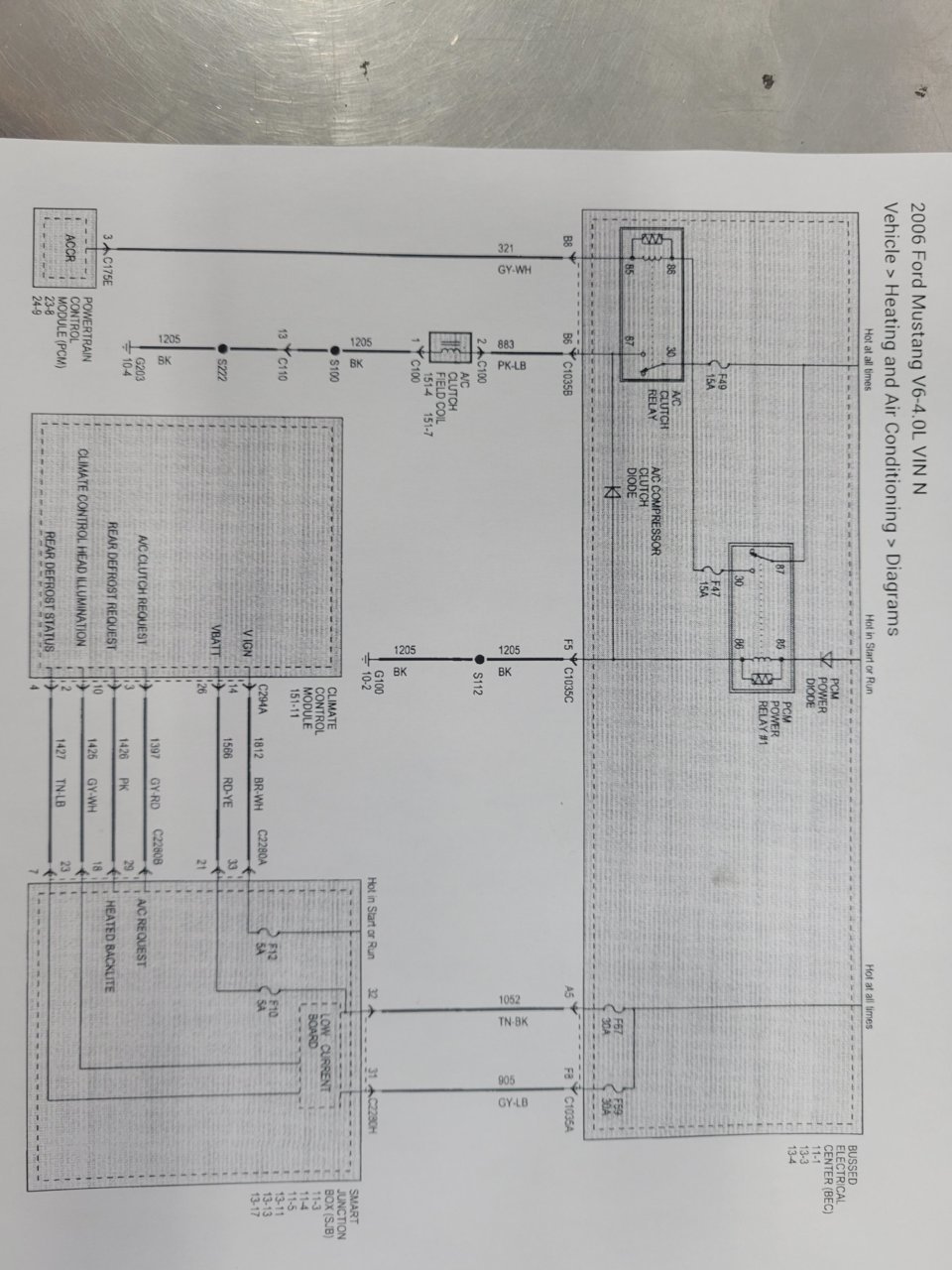

  13. Jun 9, 2021 at 9:47 AM
    b_r_o
    b_r_o Gnar doggy
    Nov 17, 2016
    #202672
    14,218
    Alex
    WA
    2015 DCLB
    This is better
    The short is probably in the BEC
