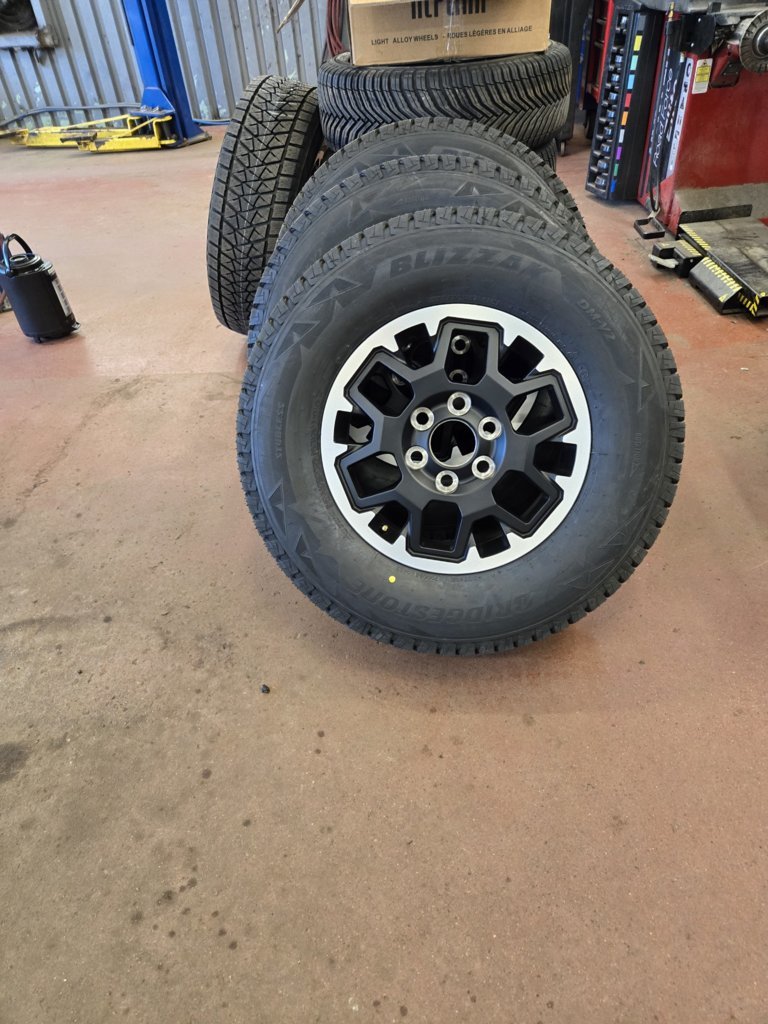

    IMG_20241028_091227.jpg I also bought Blizzaks at Cdn Tire.

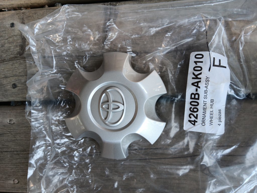

    I now have a set of centers for sale that I ordered on-line prematurely, that I have no use for, 20240917_164930.jpg and low demand for yet.
