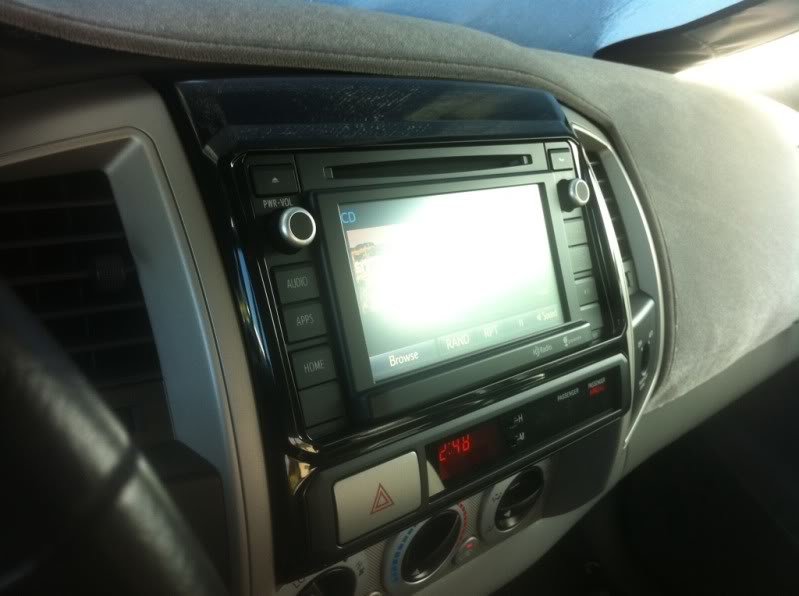

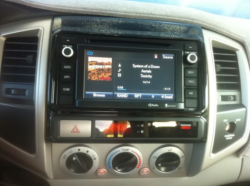

    Do you mean the faceplate from your 2014? It won't be 100% flush, they'll be unnoticeable gap unless your looking at it closely. From what I've seen 2012 and up have a different design on the center bezel.
    Here's mine on an 08.
    357689F2-EFD4-4FA7-8B8D-47BD45488F16-154_484cb11471f797918c7f0a2ba6086e157ca29a72.jpg
    F960EFEA-7133-4E32-9852-622B1FBEB1E4-154_7067be8c66fd26c4a21b002870a3efa39a06acd1.jpg

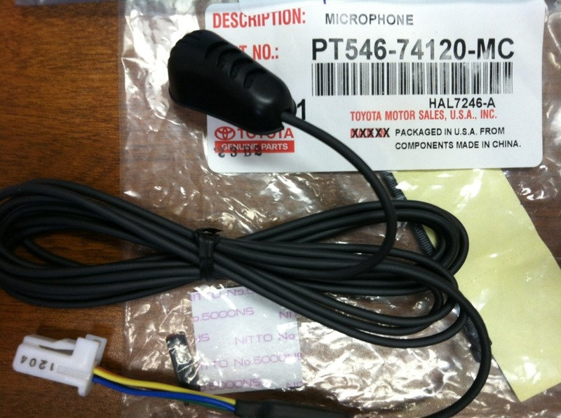

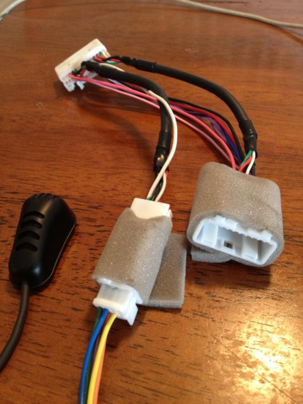

    If he wants to utilize BT. He needs the 28-pin conversion harness, and the mic. Somehow the HU has to detect that a mic is plugged so the BT can work.
    PT546-00120-CH
    bb4958ee5f0deff0cd22eb1a8be6a83c_zps56ca_5645912be61db542781e569ae72cc565a80c4be7.jpg
    Mic that's plugs into that 28-pin conversion harness for the Bluetooth to work.

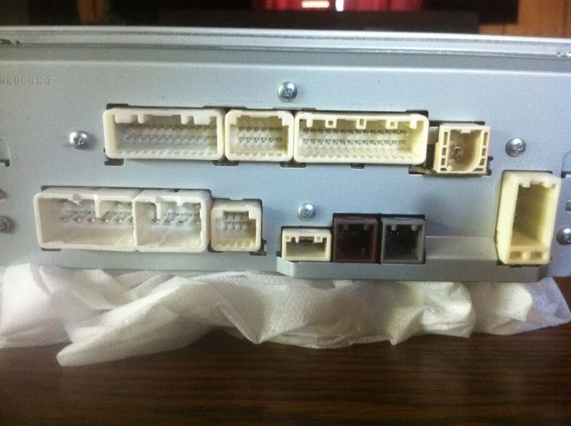

    Oh as for his aux plug it should plug right in to that grey next to the brown.
    CD1347E3-1DA8-4A48-8EB4-CB2AC2912939-138_ebfdbda076261296fa05a33261337da482183e8b.jpg

    Thanks for the info. So even to use just the BT audio and not speakerphone, he needs the mic in order for BT to be active? Did you order the mic directly from Toyota?

    Unfortunately somehow you have to have that mic to utilize the BT. I plugged in that 28-pin conversion without the mic, and it was a no go. With the mic, works perfect. I could be wrong though, if I am someone will chime in.
    Wanted to utilize the BT mainly for streaming music off of my iPhone. I've never called anyone while driving anyways.
    got the mic online, MidAtlanticToyotaParts.com
