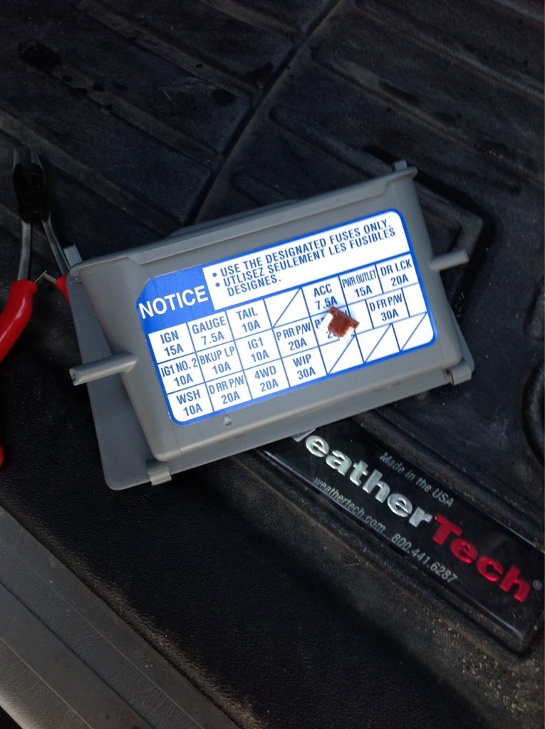

    Just put mine into my 2013
    USB, nav, weather, traffic and steering wheel controls work as plug n play.
    My vaistech sirius integration did not.
    Easy install. I may buy the XM box from FLtrucksc047ebd10e8c156c92e4b2ada5e5abb0_5e5163a92b5dcf19ca3cf80a8bb6203d87076851.jpg
    Removed the fuse.

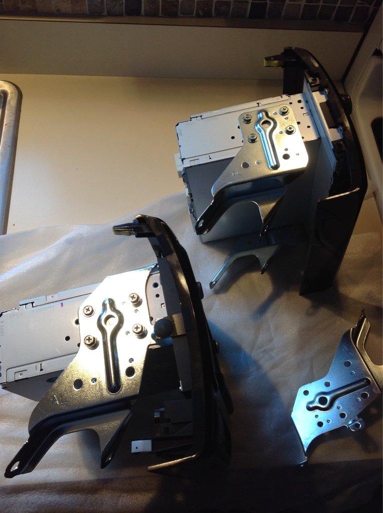

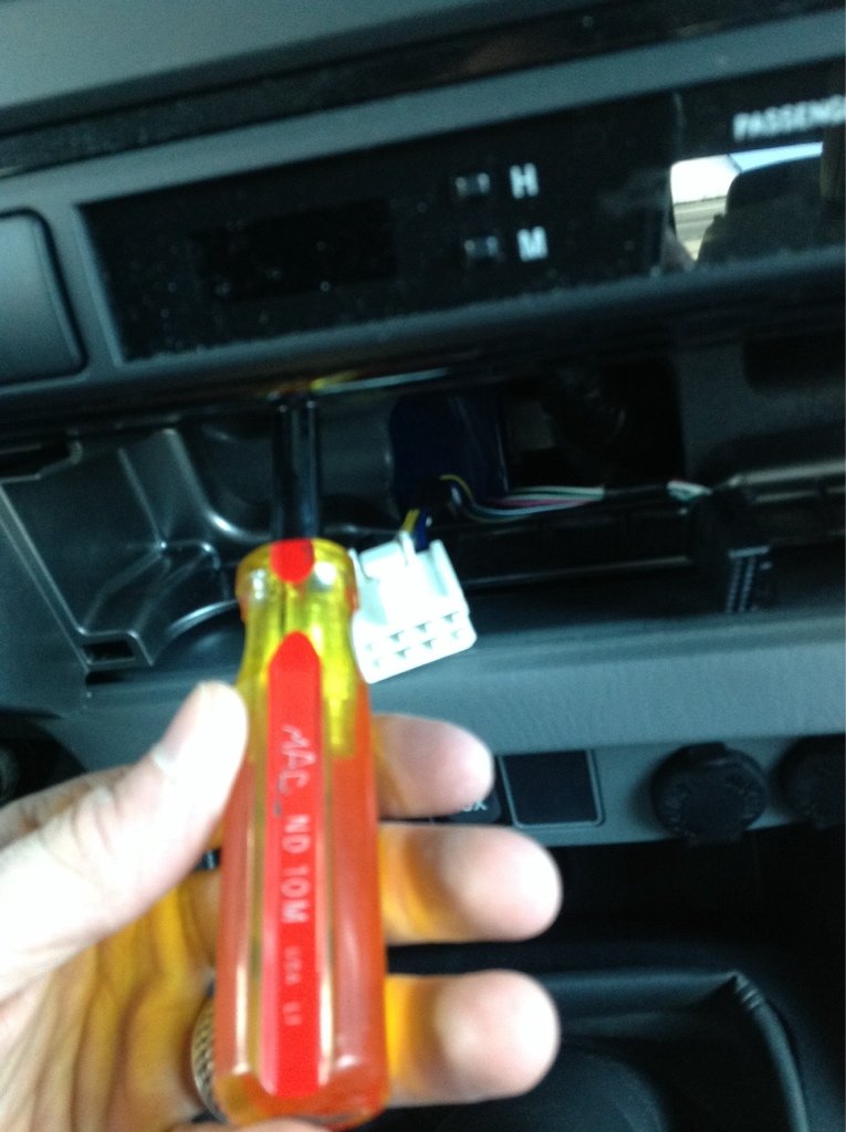

    Unbolted the 4 10mm bolts.
    Assembled new brackets and swapped the clock

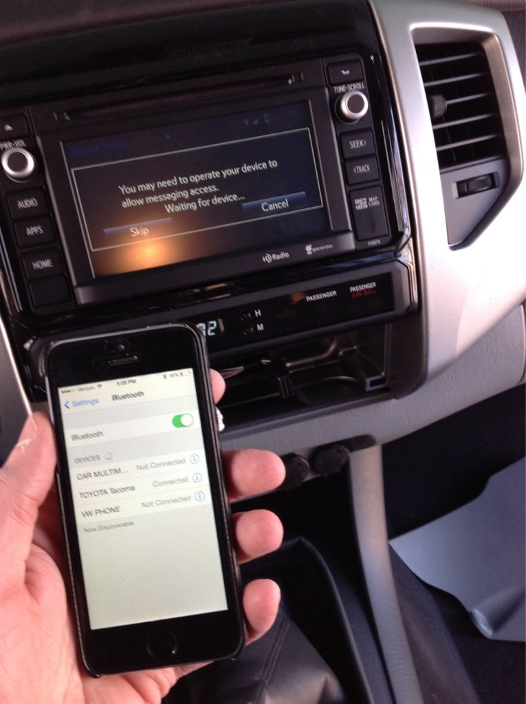

    Several plug positions are left unused. I just wanted to make sure it worked.
    Pairing my phone for Bluetooth.
