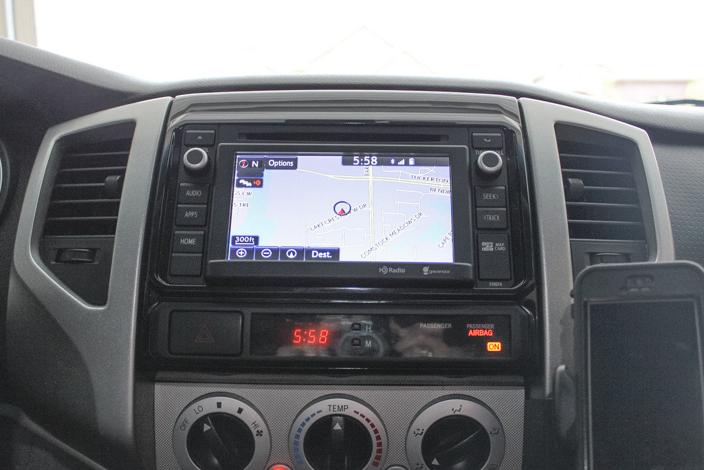

    Issue resolved! It took some driving for the GPS signal to register, but now works well with a little calibration. Very happy with this unit and meets my needs! I went from a 2007 - 2014 OEM Nav Unit complete retrofit that included:
    • New OEM Entune Nav Unit (March 2015)
    • New 12+ OEM Upper Dash Bezel
    • New OEM Lower Dash Panel with USB/AUX inputs
    • New OEM Center Console (Painted Black)
      Waiting to receive or find time to install the following pieces to be complete:
    • New OEM Bluetooth Phone/Voice Steering Wheel Controls
    • 12+ OEM Hazard / Clock Assembly (Black & White LED backlight)
    • 12+ Climate Controls (Black & White LED backlighting)
    Perhaps later this year I will tackle the OEM back-up camera. Definitely something I want to add!
