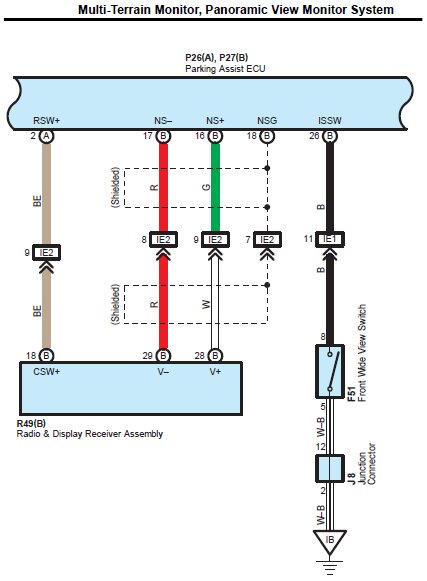

    Panoramic camera system has ALL cameras wired into the Parking assist ECU then the video feed is sent to the head unit.
    All cameras are also tied into the CAN-BUS system.

    Where did you get that image? Do you have the service manual for the '20+? I can only find the older one.
