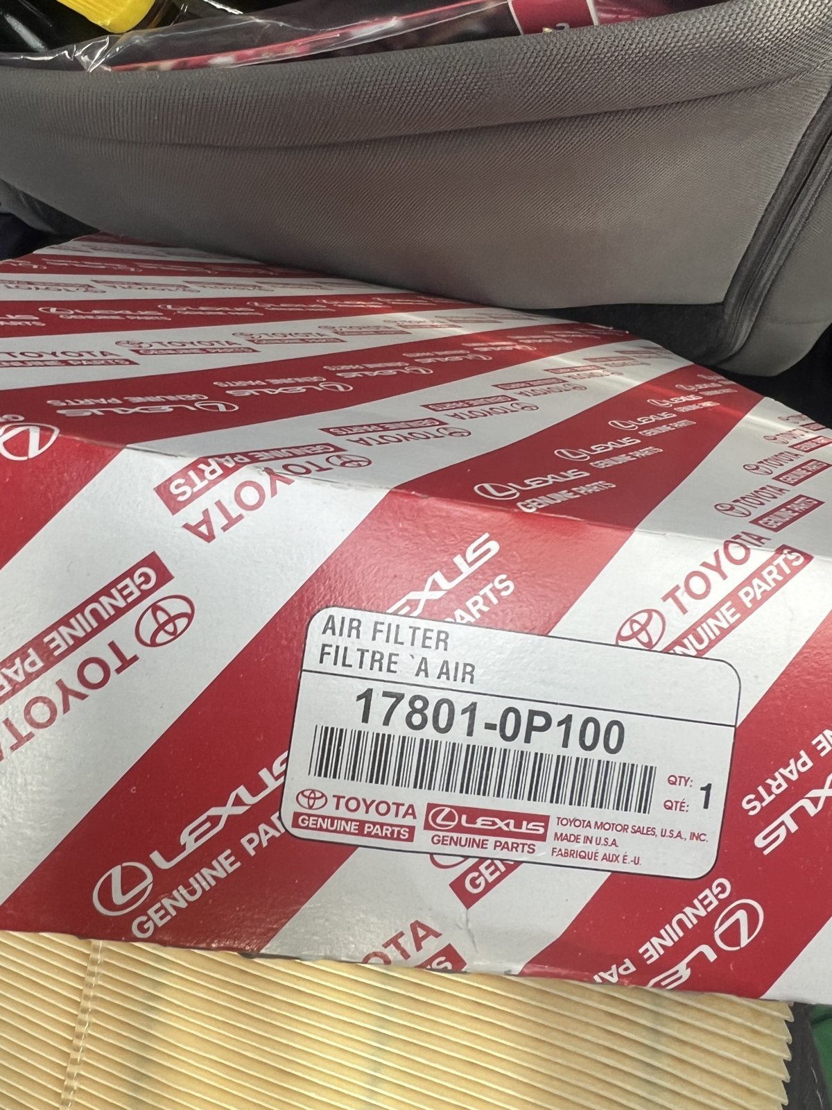

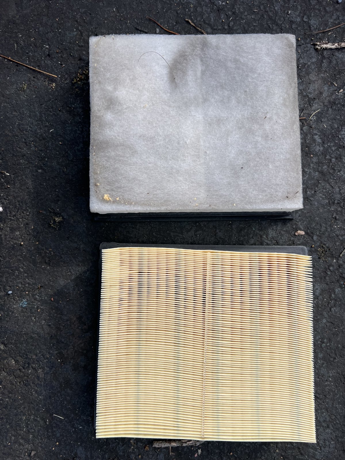

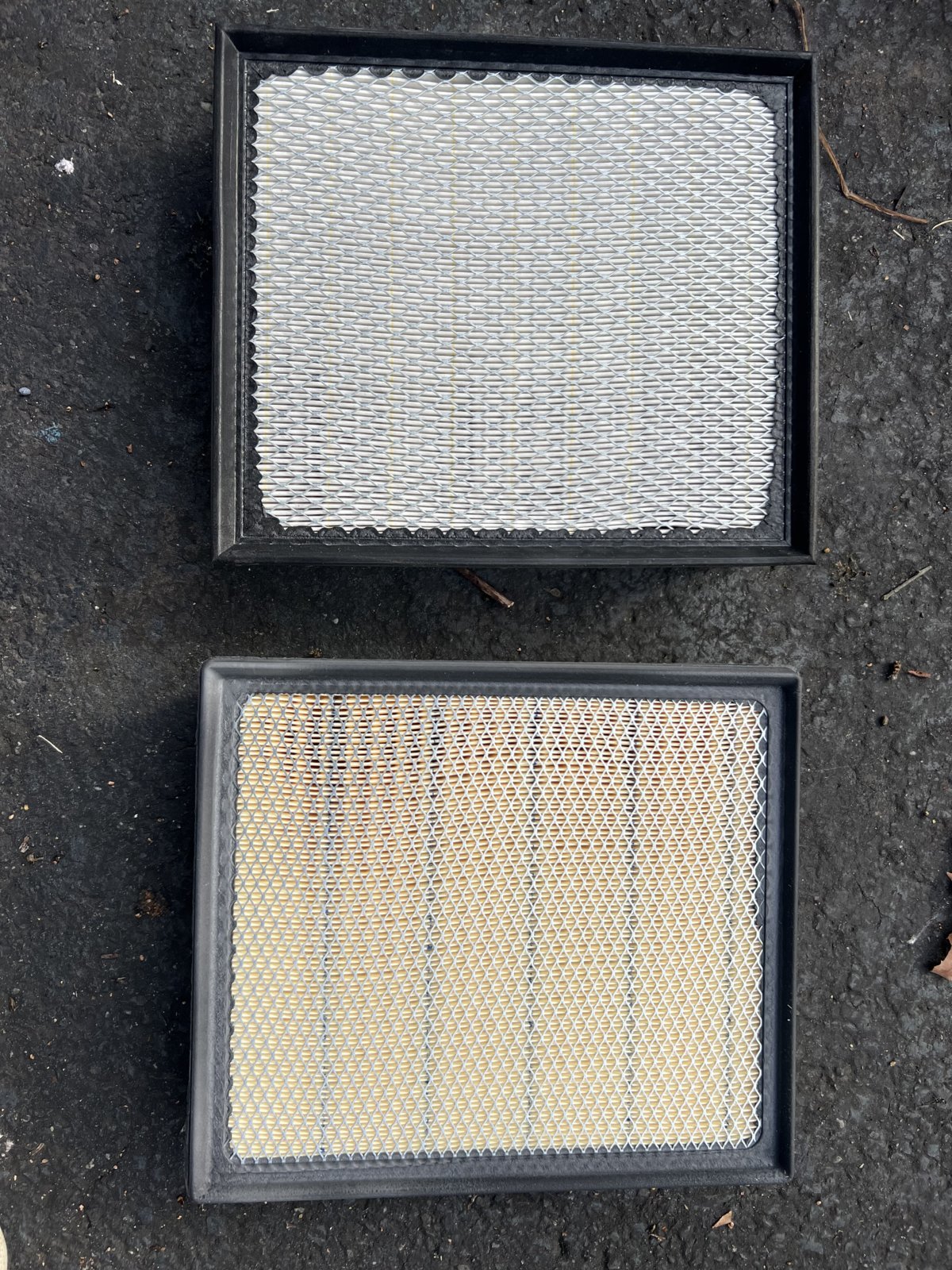

    Okay changing air intake filter. One on the top, the whiter one with the foam bottom is the old on, yellow looking one is the new one. Pictures part number is the new on. Is this right? The new one looks different

    Yellow paper is definitely OEM. Not sure what that foam is about.

    The foam pad that is attached to the air filter is called a pre-filter and it’s there as an added layer of protection for the filters of vehicles that are driven in severe conditions.
    The purpose of a pre-filter is to stop larger pieces of debris from getting stuck in the filter’s pleats and prematurely restricting airflow. It’s a well-intentioned addition for certain makes and models, but has led to quite a bit of confusion, particularly in the DIY community.

    Also that air filter isn't super dirty... 20-30k miles on that?

    34k on it i was kinda surprised when i took it out

    So the the new one i have is correct but there is a new one with the added foam pad?

    I had that issue with my bmw also. Sometimes they have regional specs.
    Just use the yellow one and call it a day.
    or tear off the dirty foam and drive on the clean old filter for another 20k

    OP are you in an area that gets a lot of snow, or a dusty area, or did the truck come from one of these areas? The white part of the filter is used to catch dust and snow that gets sucked into the airbag. Keeps it from clogging up the paper part of the filter. There is a part number for the filter with the gauge pre filter. But you will be fine without it.
    EDIT: look on the original filter for the part number, compare to the new filter

    Understood it was a Massachusetts truck i guess that’s why but we don’t get too much snow down here in south jersey so I guess that’s why, but I’m good with the other just wanted to make sure i didnt mess anything up. It fits perfect and everything but im ocd and wanted to confirm
