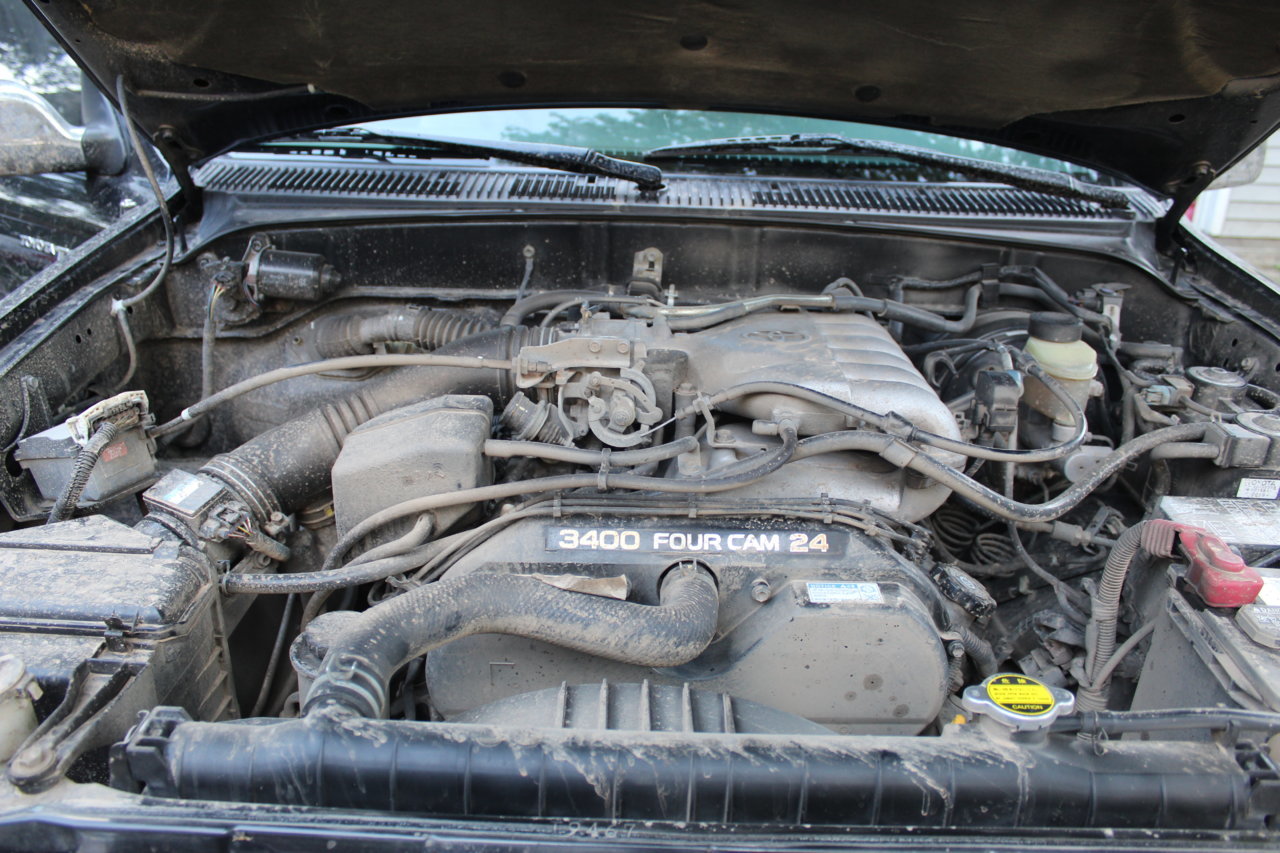

    So as you can see my air intake is cracked, previous owner jbwelded it.
    Was wondering how important this is, and are the OEM ones really worth paying for?
    Genuine Toyota-$150
    Isumo or Perfect Fit $20-$25taco 004.jpg Another thing, the insulation or whatever you call it, under my hood is totally falling off.
    Wondering what yall have replaced it with, or just tear it off, or what?

    That hole means it's completely bypassing the air filter and some sensors, definitely replace. As for if OEM is worth it, no idea.
    You could replace the insulation with dynamat or something but definitely tear that junk off

    Definitely replace the intake. Rockauto seems to have decent replacements for most stuff, I'd go there or a wrecking yard and try to find a used one.
    As for the insulation, I've literally never had any on my 2004. Tear that crap off. I'm not sure what it's trying to insulate. All it would do is reflect heat from the engine back to the engine and cause it to run hotter. Ditch it.

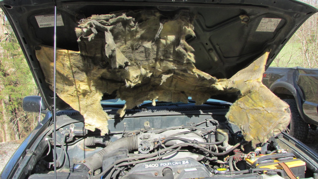

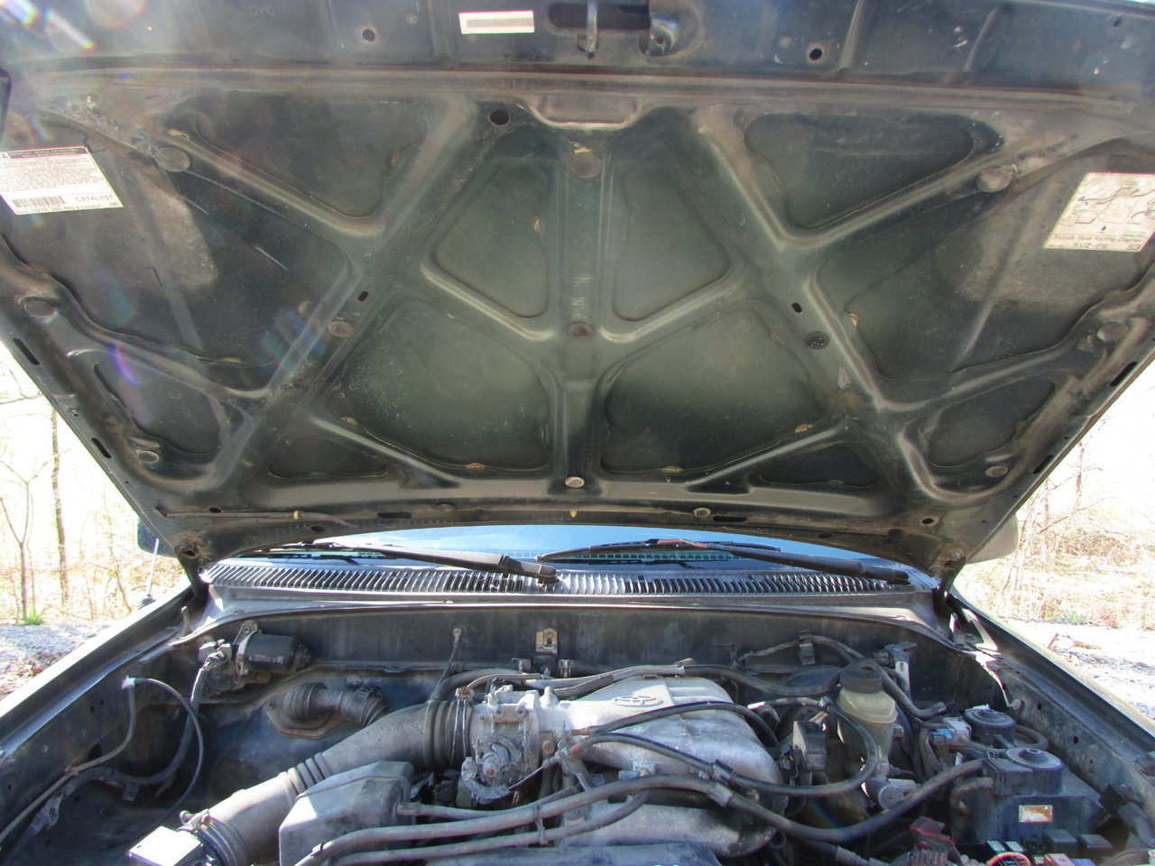

    I ripped the OEM hood insulation crap off both my Taco and my 4runner when I got them. One of the first things I did. I hate that shit!

    I think they stopped putting the insulation in '00 or '01 as @jbrandt said I've never seen any with it, only pics on TW on older models
    and where the crack is it's right at the butterfly so any contaminants go right to the cylinders. either OEM or AM jsut make sure it's the right one for the vehicle. and don't crank the clamp too tight, just so it's snug not to pop off, there is a ridge there for a reason

    Tacoma hoods have insulation? Seriously I have owned several Toyotas and currently 1 first Gen and 1 sec Gen and none of them have the hood insulation, then again all of them were purchased "Pre-owned" never new. Just take it off, looks cleaner.

    With that crack in the intake your definitely running lean and probably will throw a code if you haven’t already

    Ok, I went with MTC brand air hose, middle of the road at $40
    I haven't had any codes though.
    got rid of the insulation, prob won't bother replacing it with anything, but we'll see.

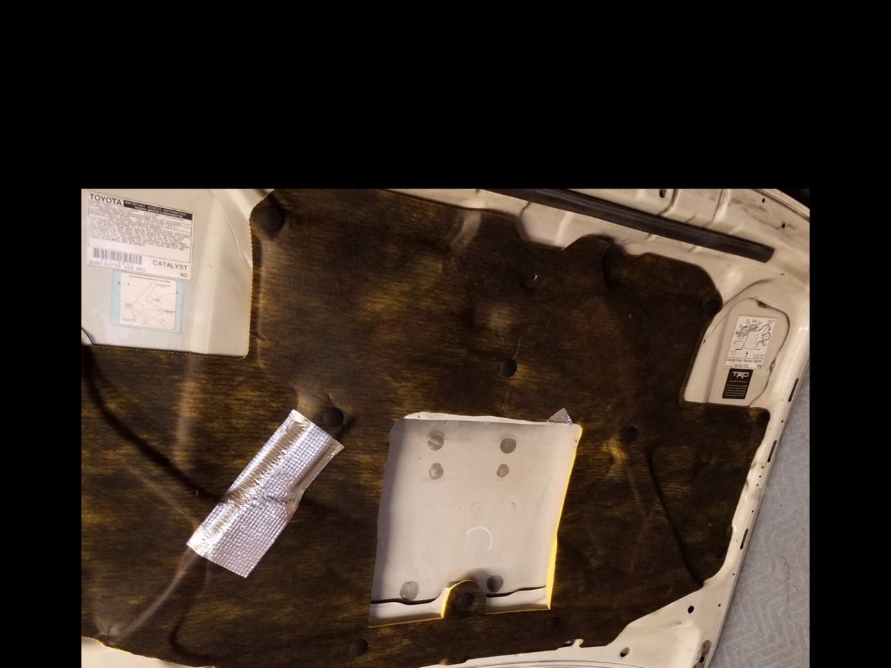

    i have my original hood insulation still, has a few tears and is starting to droop in spots, i can see why some don't care for it, especially if you got yerself a fancy trail rig on dusty off-the-beaten-path roads. I took mine out on some weird adventure trail in WI (called TWAT) last summer for the first time, mostly dirt back country roads for 100s of miles literally.
    i made it to near the Canadian border in Minnesota on Lake Superior and stopped at a wand wash place to clean some of the mess off, opened the hood and the insulation thing was caked in dirt, tried rinsing it off lightly but it got worse being so old and basic brittle
    best pic i have of it showing the bottom part of insulation material

    I applied the BINFINISH multi layer process on the insulation when the truck was brand new, 21 years ago. The pic was taken two days ago. It is washed in place with a wash mitt just like the rest of the truck, weekly. It's been a DTR for 17, make that 18 years.
    I think there were 2 versions of the insulation. This one had a cloth like layer on the outside. It appeared to be glued to the semi stiff fiberglass mat with a water soluble adhesive. The first time it saw an errant splash of water from the first under hood hose down it began to fall off, in minutes.
    When it was out, there was a noticeable increase in engine noise. Not much but noticeable. The kind thing one would forget about after a week. Might have had something to do with background noise at a "new car" level. Probably why Toyota quit putting it on.
    For me, the "preservation" effort was due to Toyota not fully painting the underside of the hood. Couldn't live with 4 or 5 square feet of bare gray primer/sealer.
