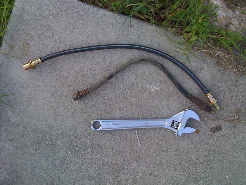

    I have a 2" rear lift and really needed a longer brake line. I can get away with the stock one if I don't get wild. I've priced the aftermarket ones and just didn't want to fool with it or shell out $40 for something that isn't broke. Well, I got to thinking since I'm running some other 'custom' projects around my head...
    (all part's brands were picked for their measurements and autozone lists the sizes and/or fittings of most things when no one else does)
    ToyTec is 20", Tundra w/out ABS is 20.25", stock Taco is 15.5".
    $40 here $21 here for the Tundra one
    http://www.autozone.com/autozone/pa...jfjc1Z8knpa?itemIdentifier=689924_168069_3559_
    The stocker for reference
    http://www.autozone.com/autozone/pa...jdcjxZ8knpa?itemIdentifier=689829_168069_3559_
    The eyes on the T-100 shocks have a smaller rubber, but it can be greased and reasonably forced on with the bolt that holds the shock on. The Tacoma shocks are actually side specific and the T-100s are not, but it doesn't really matter that much since the T-100 would be more than a 2" rear lift puts up.
    Tacoma stock rear shocks: compressed-13.52", extended-21.79", 8.27" stroke
    http://www.autozone.com/autozone/pa.../_/N-jdcjxZ8oxxx?itemIdentifier=412124_0_7413_
    The T-100s are: compressed-14.88", extended-24.9", 10.02" stroke
    http://www.autozone.com/autozone/pa.../_/N-j9ifpZ8oxxx?itemIdentifier=310511_0_7413_

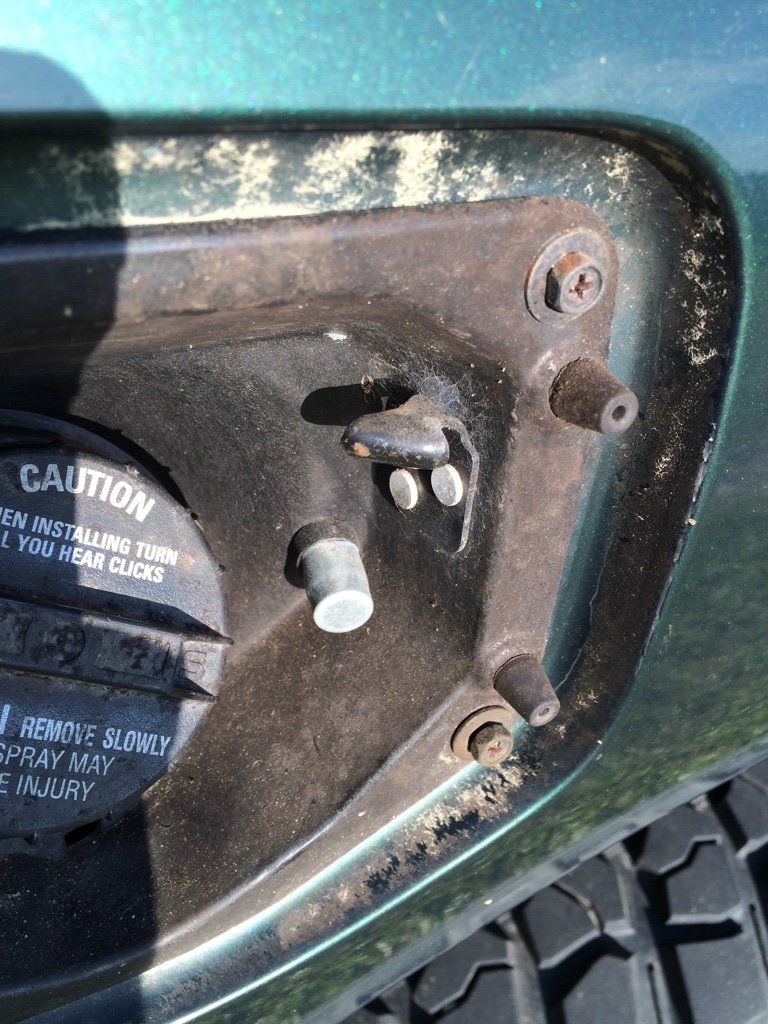

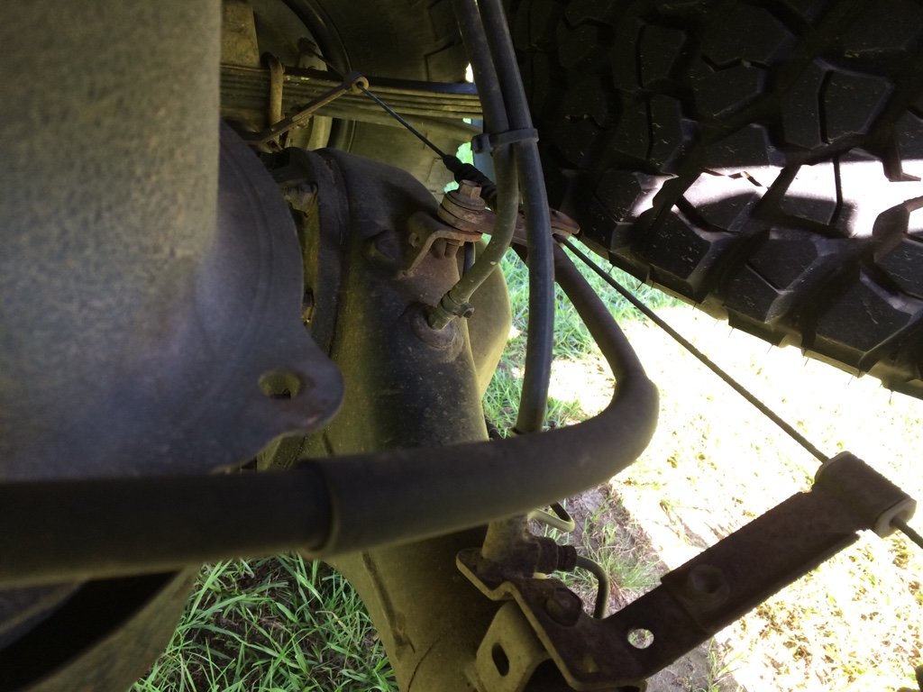

    I can't find the Toyota Part Numbers right now, but the rear diff breather relocate was all OEM parts except for the parts house hose.
    The nipple on the axle with a simple zip tie.
    Then route the hose up your brake line and to your fender well. Then come out in your gas hole with a breather that's another Toyota part.

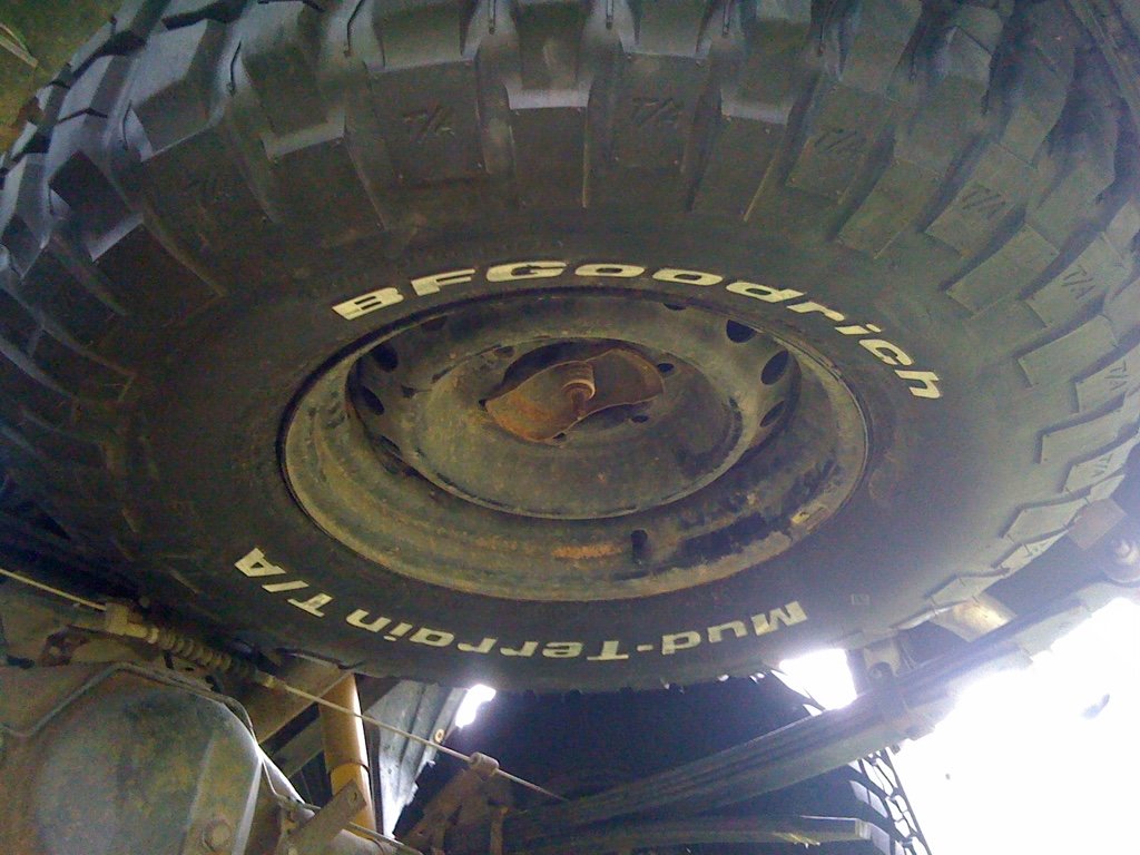

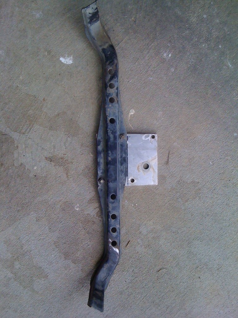

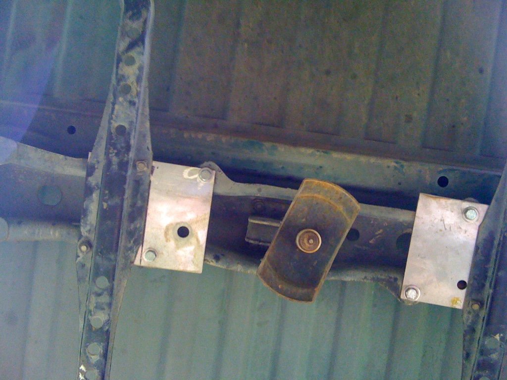

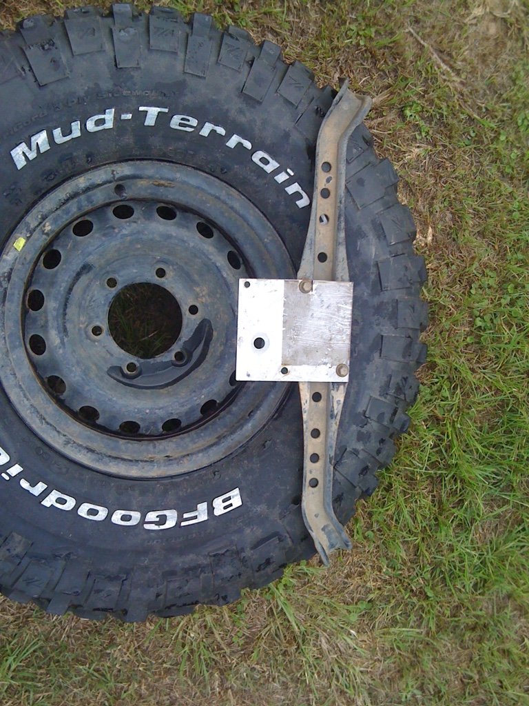

    How about a 33" tire for your spare? I had some scrap stainless so I used that. Anything sturdy enough to support the tire bouncing around would work, though. 1/4", 3/16", 3/8", whatever you've got and a few nuts and bolts.
