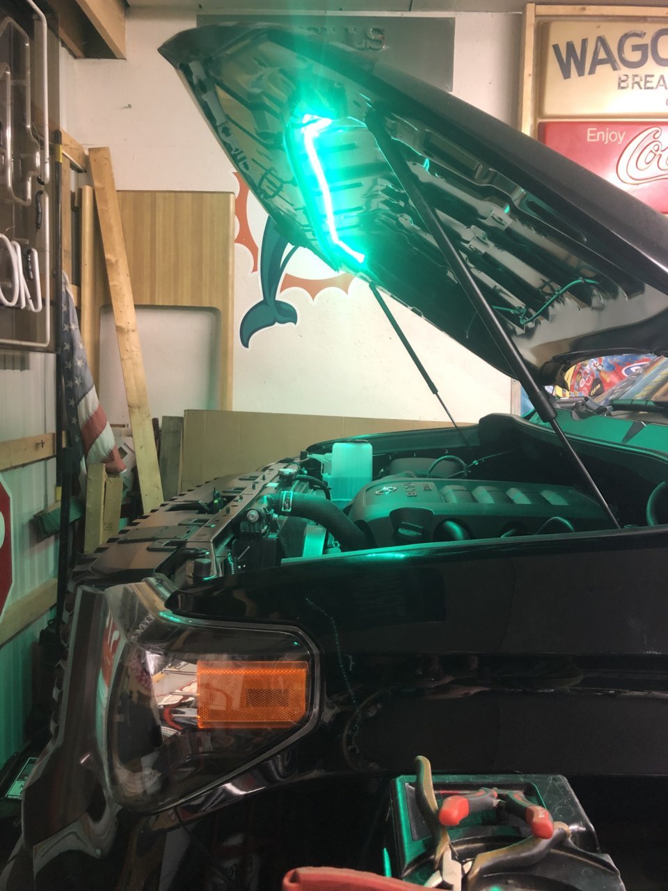

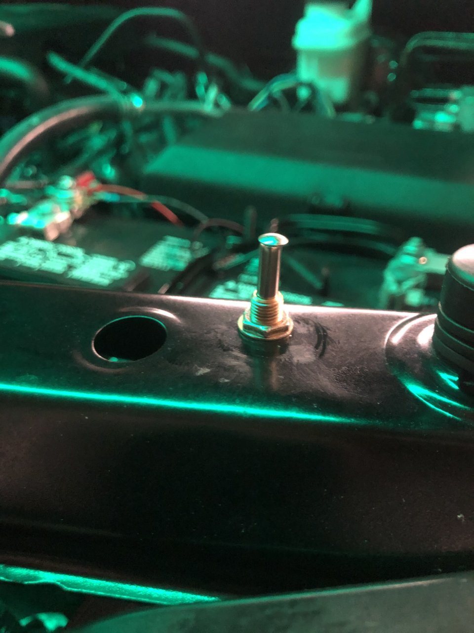

    Hood pin switch is very easy- I installed one for my under hood led light strip to activate when hood is raised - one hot wire to battery then ground wire makes contact and completes circuit when switch is activated

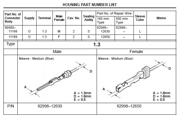

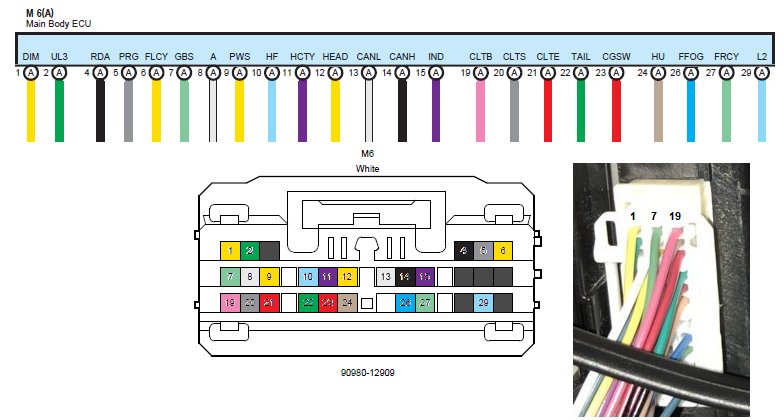

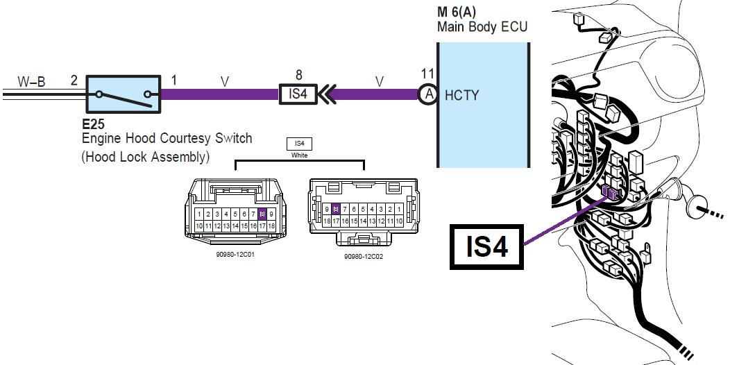

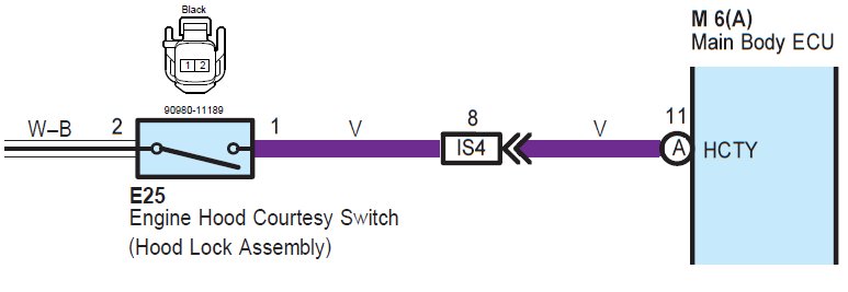

    M6_11 HCTY
    Terminal is TE 1827855, same as for the missing terminal of the SR Fog Switch circuit.
