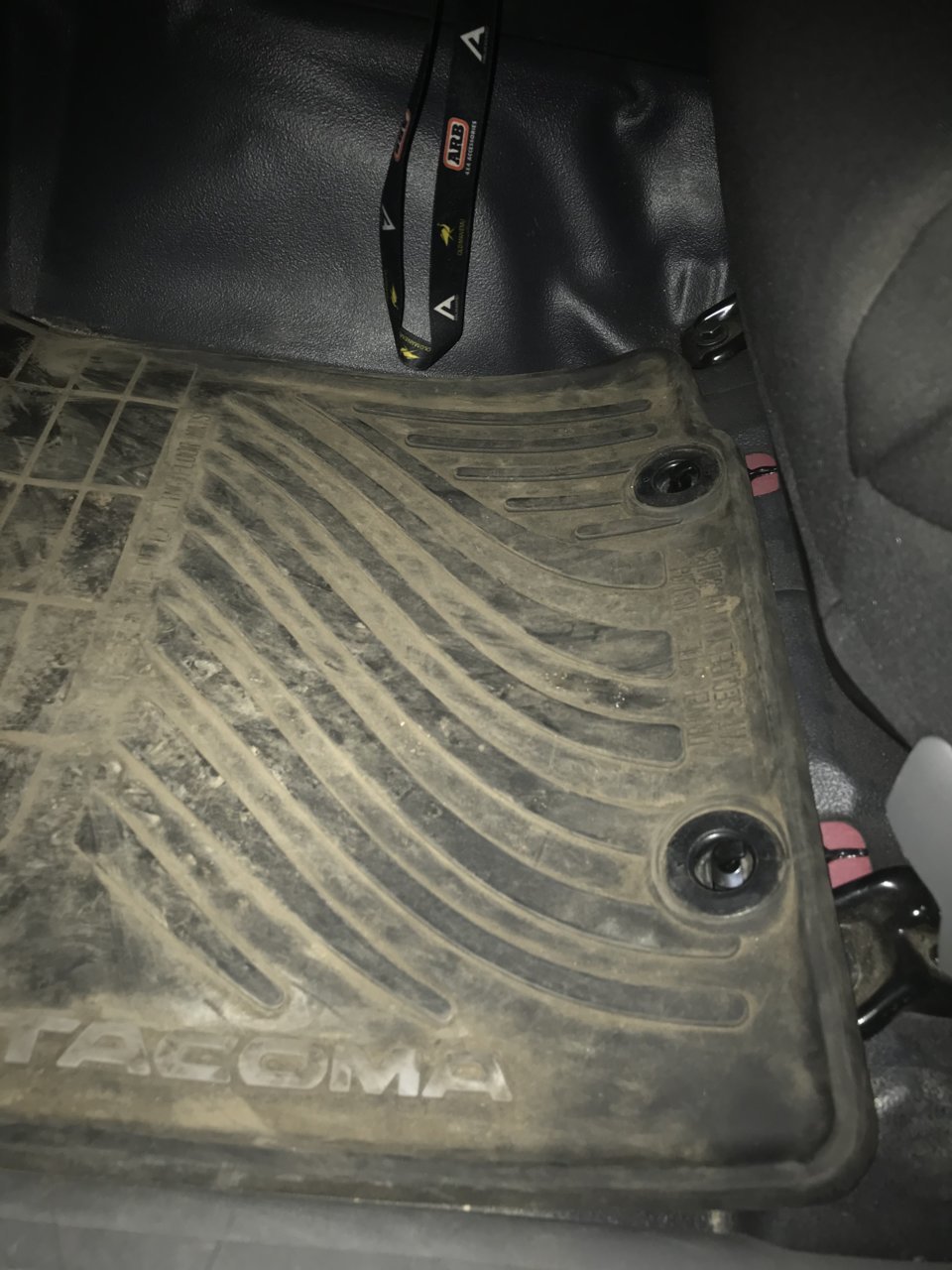

    Heres a pic of how the floor mats have to slide back slightly vs the position they clip down in on the oem carpet. Id say they sit back towards the seat about an inch or two further

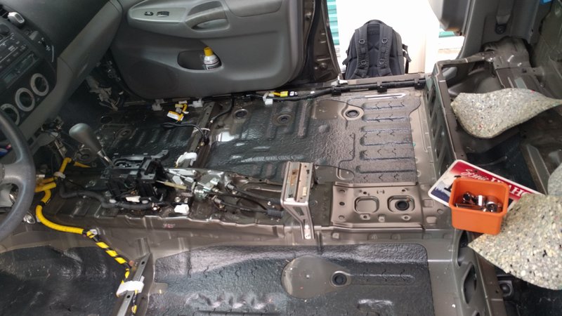

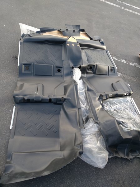

    Looking good at unboxing and carpet is removed...Edit: Will be doing final install today!

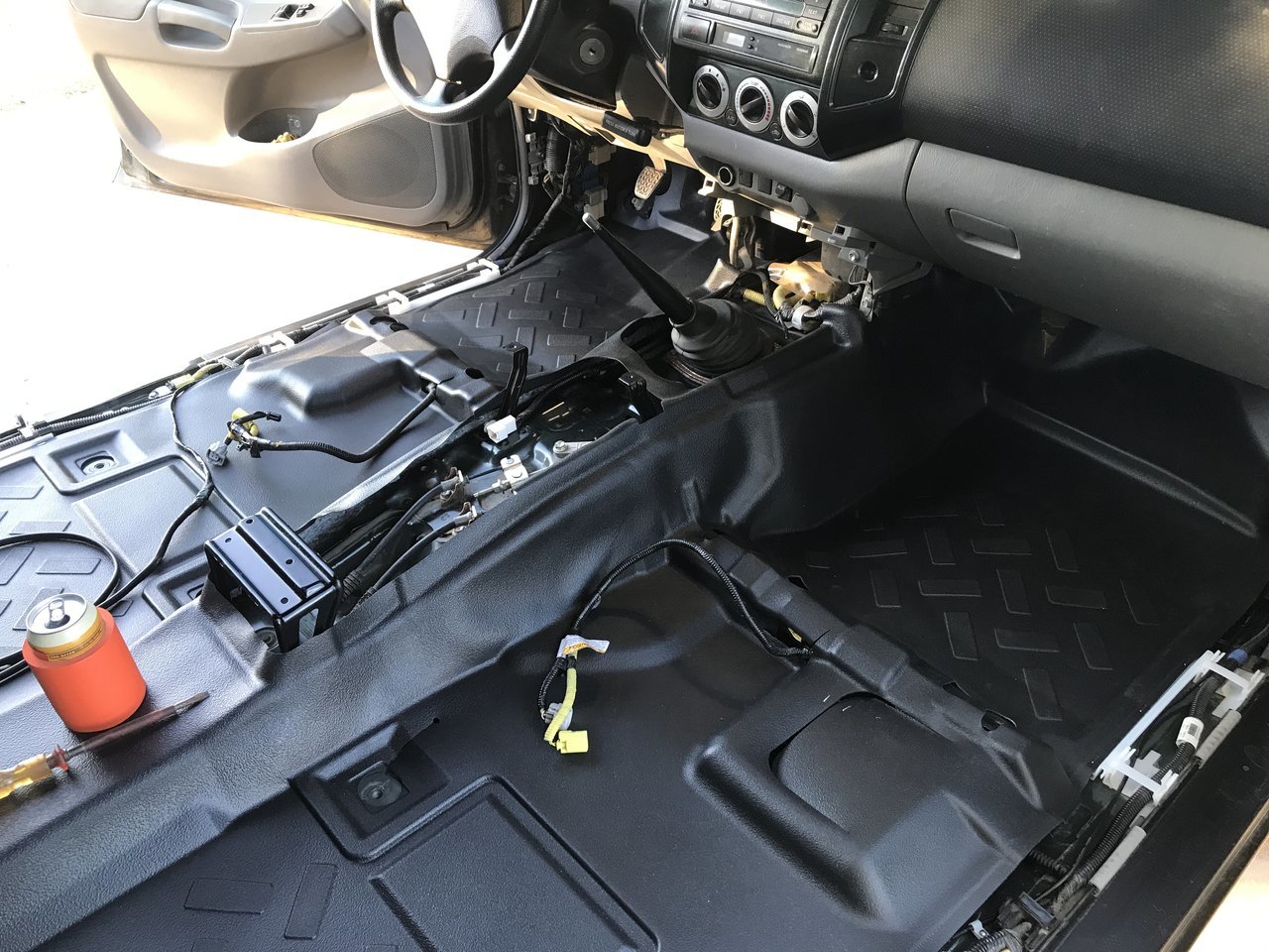

    Got mine installed today. Loving the way it turned out. Fear not folks, this is one project that you can work on your truck and enjoy a few brewskis in the process:D
