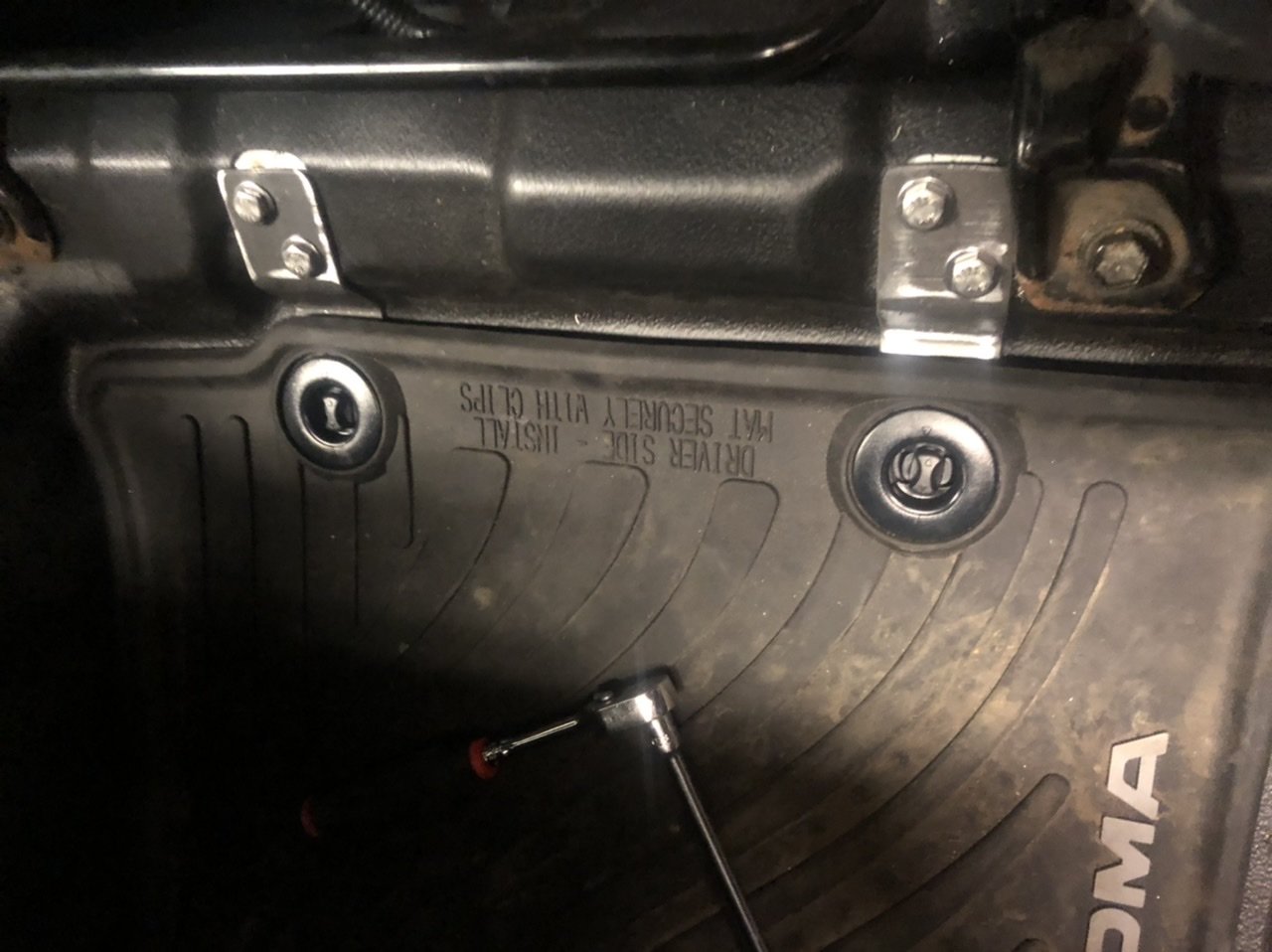

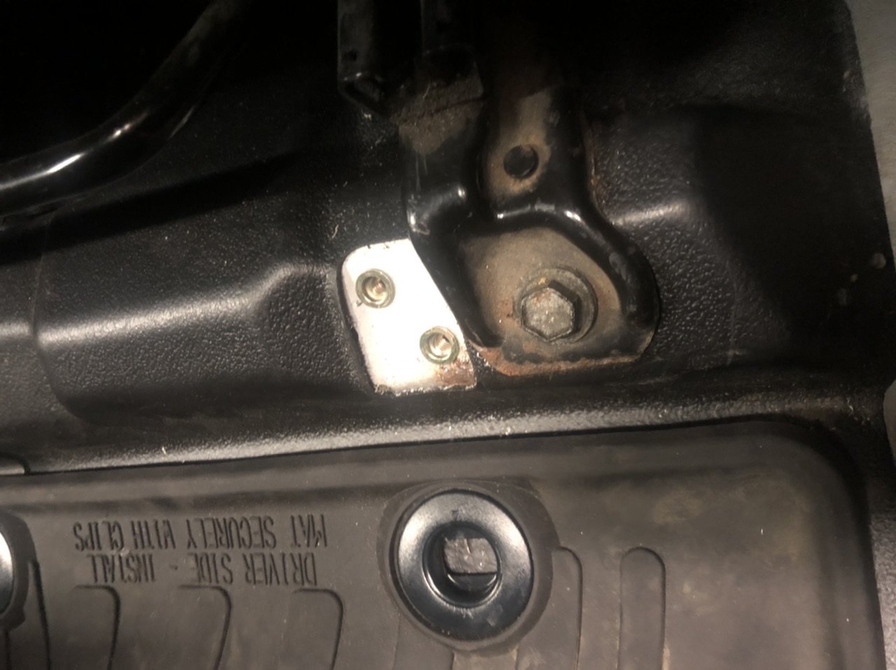

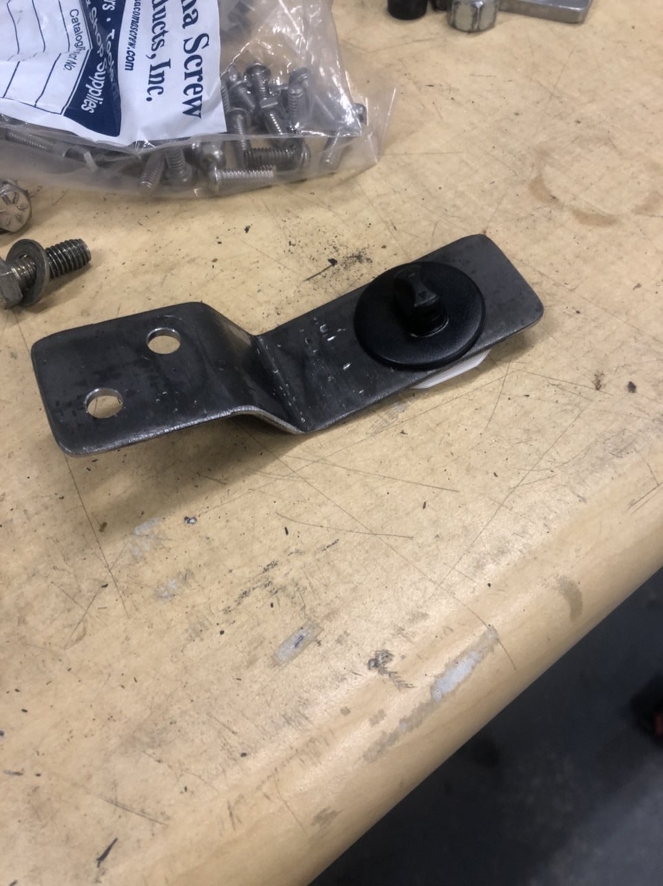

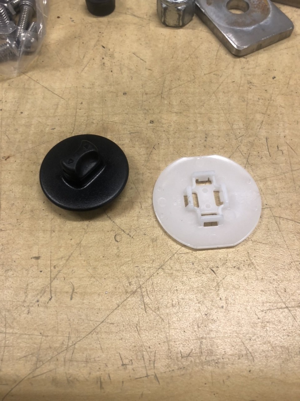

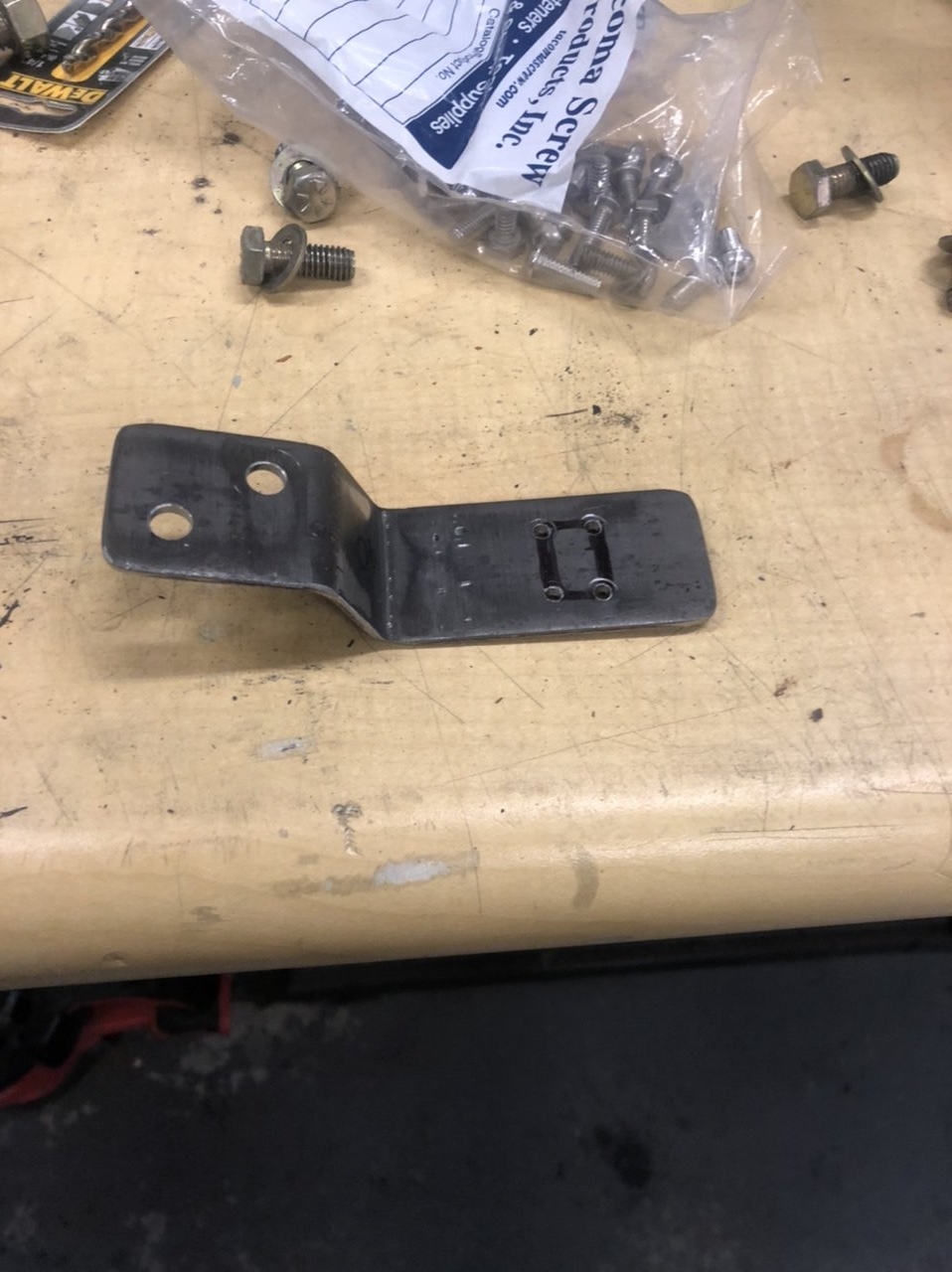

    Figured I would give an update. So in my search to find floor mats that I could put down in the vinyl floor to try and keep it in good shape for as long as possible. I found the 12-15 oem all weather mats fit really good. They still have the buttons in the back so they are retained easily that way. The fronts are a different story since there’s no holes in the flooring to put the retainers in but there’s two holes right next to the seat rail mounts I had an idea. I made some brackets that would use this space so it would cover the holes as well. So I ordered some oem retainer clips, part numbers 58698-76010 and 58694-76010. Then I bent up some brackets and then cut some holes in them for the retainers to fit in. Then I drilled some rivnuts into the floor bracing and bolted the brackets in that way. Still need to paint them but I wanna make sure they work well first.

    Dude this is clutch. I have my factory ones in there but they move around a ton this is great.
