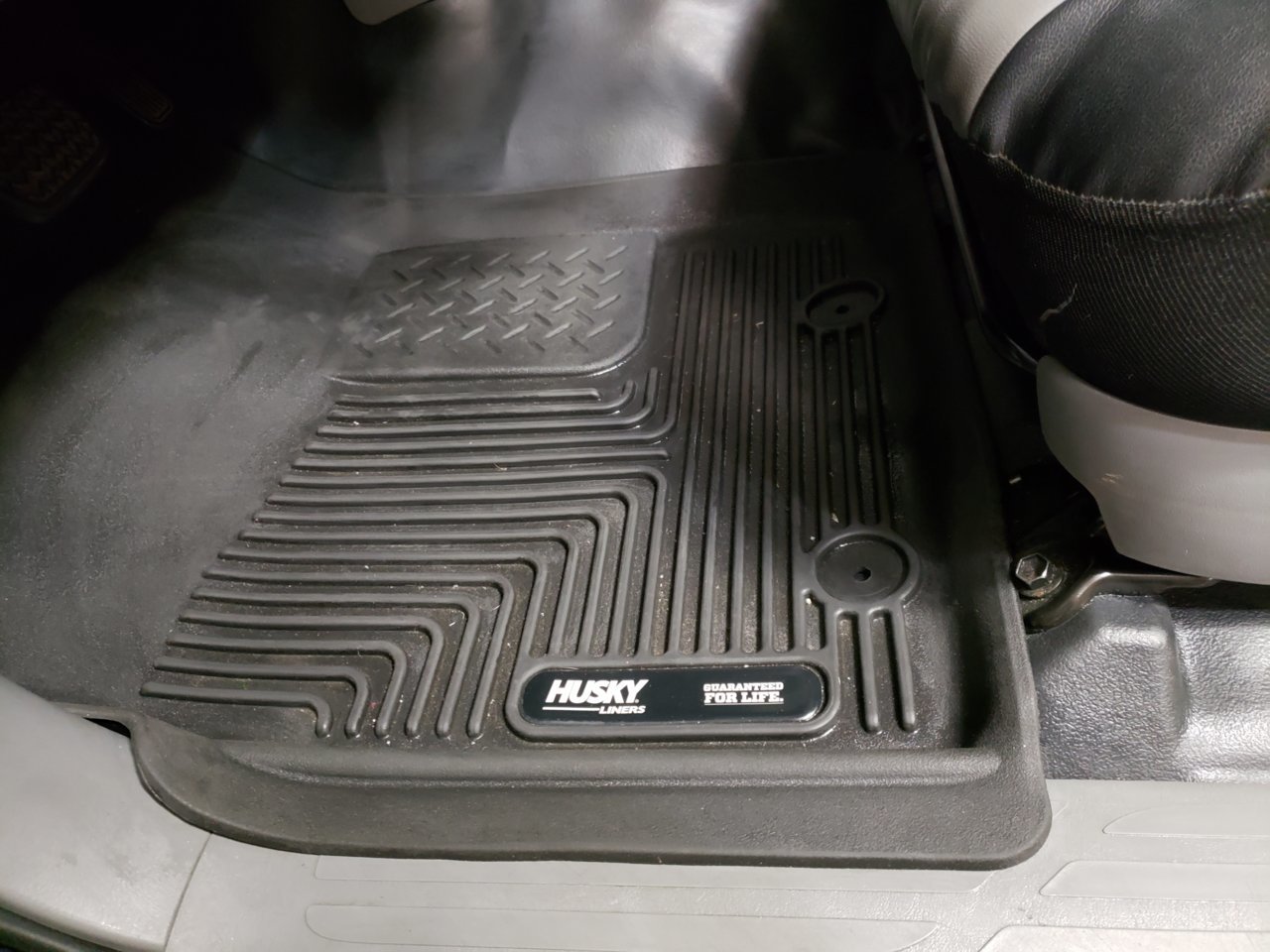

    Excellent, this is what I plan to do as I already have the Huskies.

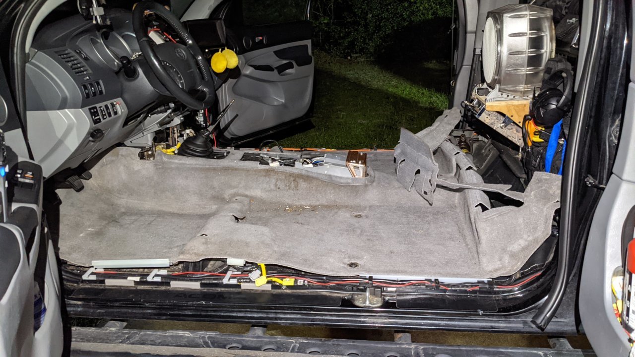

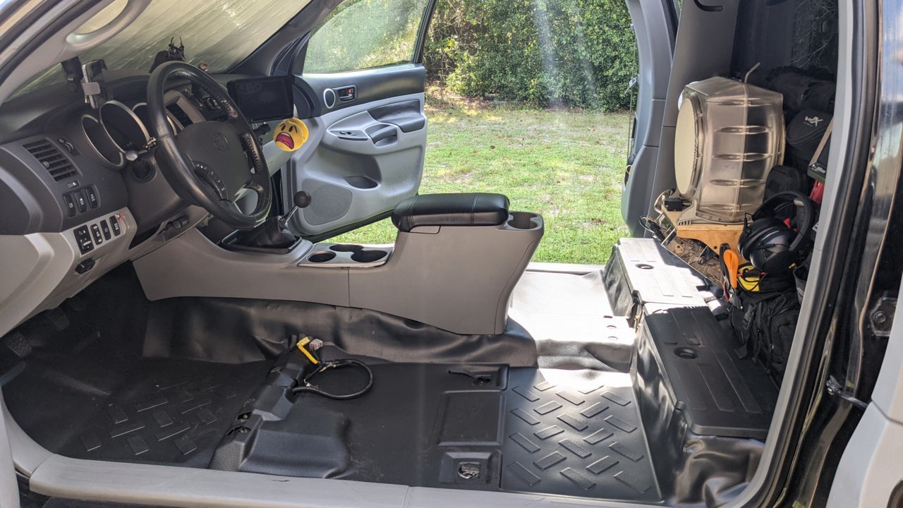

    Goodbye nasty old ever damp carpet:
    Hello Dynamat Dynaliner and Dynapad floor with sweet black easy to clean utility "carpet"

    Hey Key, I'm still on the fence doing this mod. My question is, do the wrinkles eventually settle? If not do you think the material is pliable enough to maybe use a heat gun to smooth it out? My OCD would drive me nuts! :rofl:

    The wrinkles will settle out with a little time and heat from parking in the sun on their own for the most part. It's definitely workable with a heat gun if you feel so inclined, wear some gloves and take your time to work it, don't burn it.
    It looked like a forgotten in the dryer dress shirt of a mess when I first unfolded it. It arrived at the dealer basically folded in forths in a big plastic bag. I left it unfolded layed out in the sun while I ripped out the old carpet consoles and trim.
    I cleaned the metal floor pan and did the Dyna/mat/liner/pad process and then with the vinyl floor nice and toasty from the sun I was easily able to pull the jute matting and foam forms from the back before installing it on top of my own insulation and deading.
    Laying in the sun smoothed it out a lot but as you see some wrinkles were left. Part of that is just contouring differences and from fitting it without the jute backers over my own Dyna'ing.
    What wouldn't be seen behind the seats I didn't worry about and I think it's mostly gome now anyways and after a week of the truck parked in Florida sun it contours pretty nicely to the pan.
    Summer is probably the best time to do this but wear long sleeves as sun burn is a bitch and you will sweat any sunscreen off.
    There's still some spots, mainly the sharp corner bends around the rear cargo box area that I probably could stand to work with a heat gun for a more perfect fit but nobody will ever really see or notice them so I'm not bothered to take the time.
    Very happy with the final results, much easier to keep clean and I don't have to care about liquids soaking through or stains or sand getting hopelessly embedded in the carpet.
    10/10 would do again especially if you dyna everything while it's all ripped out so much quieter going down the road and I like the more muted less busy dark interior far more than the light gray carpet.
    I would get it asap if you're thinking about it. It is a part that seems to be on the chopping block for being discontinued.
    The most challenging bit was getting my custom floor mat anchors to work with the floor.
    This flooring isn't made with the use of floormats in mind so I had to drill some holes for the pass through anchors but it's all solid now, works great with my all weather Huskies and anything that makes it over around or under the mats is easily vacuumed out in minutes.
    Seems less humid in the truck too now, I had gotten a few inches of water in the carpet once and it apparent never could fully dry out, the carpet was dry on top, and floor dry underneath but the jute has a plastic vapor barrier that trapped some moisture in the insulation.
    Thankful it never molded but that's one more thing I never have to worry about again.
    And I don't have to care about keeping muddy boots off the carpet.
    Wish I knew about and did it sooner,!
    If you like to play in the dirt with your truck or work on and mod this one is a must!
    :thumbsup:
