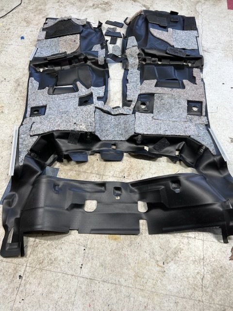

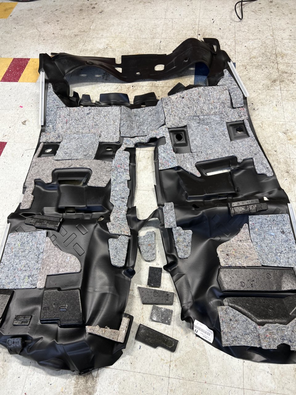

    Bumping this request. If one of the folks installing an all-weather flooring mat could take a photo of the backside laid out to show where the padding and blocks are placed, I'd sure appreciate it.

    I picked up my flooring from McGeorge this morning. I also discovered that some of the felt and hard foam pieces had detached from the underside of the flooring. @4xdog - here are a few pics if helpful.
    I’ll post up pics of the install once done.

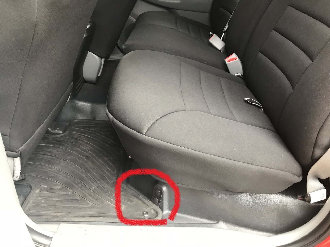

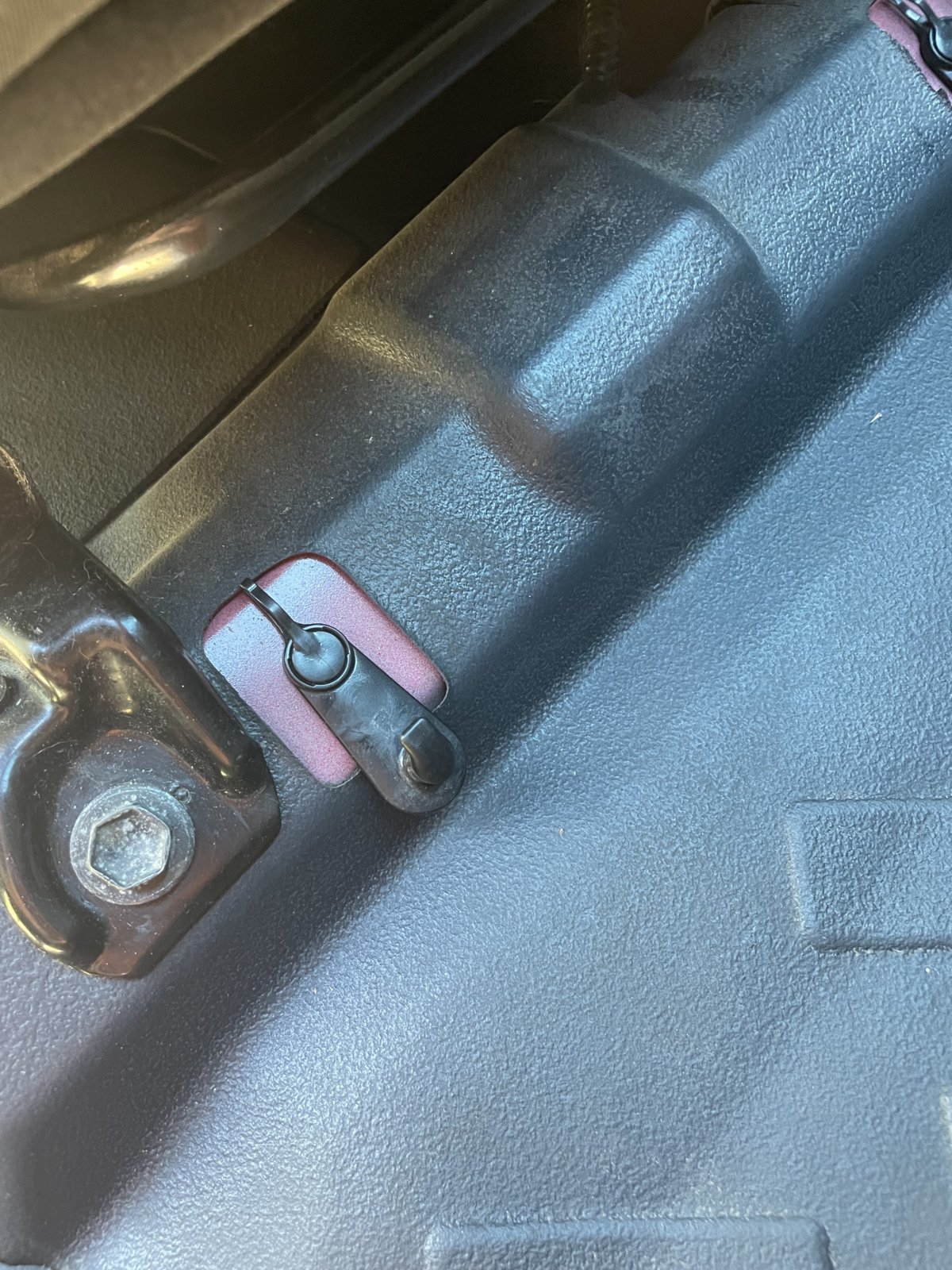

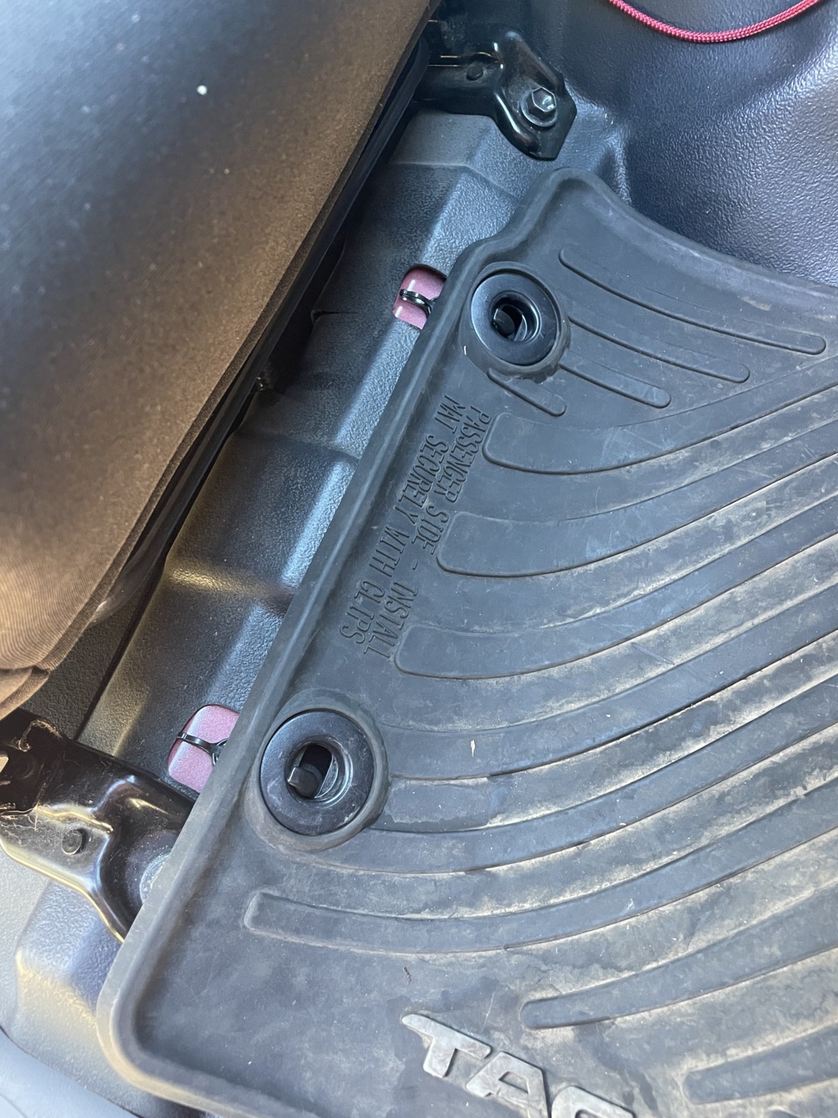

    For those that installed the double cab...do these clips come with the all weather flooring?
    Also if someone can post a pic for these clips...curious is it covers the whole completely or still leaves the metal floor exposed. It'll suck to replace the floor for easier cleaning only to get stuff to fall through those holes. That's the one thing that has kept me from pulling the trigger on this unless someone has come up with a solution.

    That’s my truck and looking back at my pics from a few yrs ago, I think I had to remove the clips from the stock carpet in the first picture.
    for the second one, the clips look like this. Part number 08210-00820
    Here’s how it is with the stock floor mats

    Forgot to tag you on it but also didnt know whos still on the forum since this is an old thread.
    Mine doesn't have those small clips for the rear. I'll call around some dealers and see if they still give out the clips free.
    Im content with that much metal showing. I thought those holes would've been more exposed.

    These toggle-style front mat retention hooks are unique to the all-weather interior.
    The earlier, smaller bent-hook style often given away free at dealers might work, but IMO aren't as optimized as the correct retainers.
    Hook: 58521-04040
    Screw: 90159-A0008
