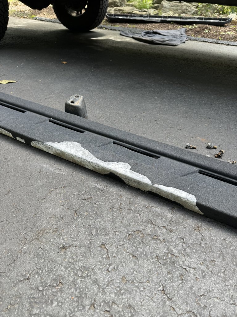

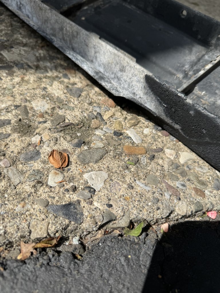

    2018, barely 60k on truck. I’d wash under the truck after some winter roads here in the northeast. Seem to be peeling from under step and then gets worse. going to see what dealer says ?

    I doubt Toyota is going to be much help, maybe if it is the dealer that sold and installed, they may help a bit.
    These aluminum accessories all seem to shed their powder coat sooner than later.

    Since you're well past the warranty period, the dealer will probably be happy to quote you on a repaint?

    yeh I have an ok relationship with them maybe get new set at discount. The wife and kids like them

    I wonder what it would cost to have them stripped and hard anodized.

  6. Sep 9, 2024 at 11:58 AM
    908tacoma
    908tacoma [OP] Well-Known Member
    Oct 5, 2018
    #268429
    1,090
    New Jersey
    2018 MGM
    OME, SPC, TRD
    on vs off
    FunknNasty likes this.

    honestly this is what I would expect from the north east

    You can probably find a set someone (like me) pulled off when they first bought their truck. My wife and I are both relatively short and found them just something to step over when the truck was stock height.

    They have 60 thousand miles of protecting the rocker paint from the sand blasting without mud flaps...

    Scrap and replace with someone's takeoffs. They aren't real popular with folks who off-road.

    Since they are aluminum.. id sand as much off as you can and truck bedliner them.. you can always touch up if needed.. if you use the roll on kind it looks really good covers blemishes and is good for touch ups it also adds good traction

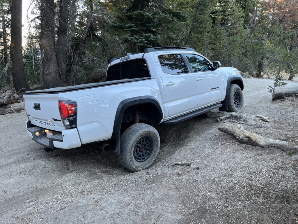

    FunknNasty
    FunknNasty Well-Known Member
    Apr 27, 2024
    #448729
    362
    San Jose
    2022 Pro
    …but the unpopular people have learned to love them. <tounge in cheek>

    You're in NJ, salt, brine, Calcium chloride 1/2 the year, normal. Remove them, get them sand/soda blasted and rhino lined if you like them.

    probably will scrap and keep eye out for used set.

    I’ve touched mine up with a shaker can numerous times. Not best solution, but does look better. That bed liner paint coating sounds like a great idea!

    Living in the north east I went with the Toyota plastic covered ones. Too many years dealing with corroding running boards.

    Contact a spray on bedliner company, and have them coated. I did that with the sets on my last 2 trucks, no peeling issues. I used LineX, they utilized a uv matte topcoat to prevent uv fading. Ski
