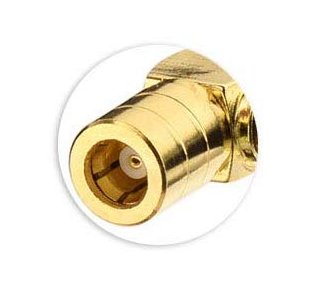

    Good afternoon TW! I have searched but not really found a definitive answer. I installed an Alpine ILX-W650 into my Tacoma, and have been loving it. However, I wanted to add SiriusXM back in since the new radio doesn't have it included.
    So, I purchased the SXV300 tuner, and wanted to use the factory antenna that is wired down to the old radio already. However, I am having trouble figuring out what adapter to use to get the OEM tacomma antenna plug to fit into the SXV300 tuner. There are just a lot of different adapters, and I am having trouble finding one that will definitely work for Toyota. Anyone have experience with this?
    Here are some examples of adapters I am seeing. Any help is appreciated, thanks in advance TW.
    Example 1
    Example 2
    Example 3
    Example 4
    Example 5
    EDIT: IF ANYONE RUNS INTO THIS PROBLEM IN THE FUTURE WHEN READING THIS, HERE IS WHAT YOU NEED. Fakra Z Male to SMB Female.

    You're going to need a MALE Fakra to mate into female Fakra connector the Tacoma has and other end with an adapter to the Sirius Module antenna input.

    You lost me... It seems like the FAKRA cable on the OEM antenna is the male cable. I thought I would need FAKRA Z female to whatever the siriusxm uses on their SXV300

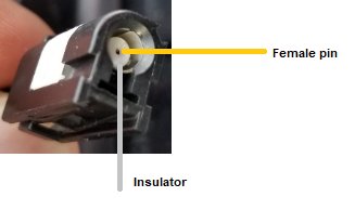

    Look at the center of the Tacoma antenna...there's an orifice...not a protuberance :D

    I see both :annoyed:!!! Gah. Because the oem antenna cord (this) fits into an orifice in the OEM head unit... so I assumed the antenna cable was classified as male :frusty:

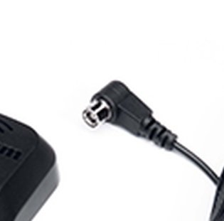

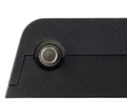

    Look at the antenna connector that the Sirius Module brought...

    Looks right to me... antenna connector on the sirius module looks to be male

    There ya go....
