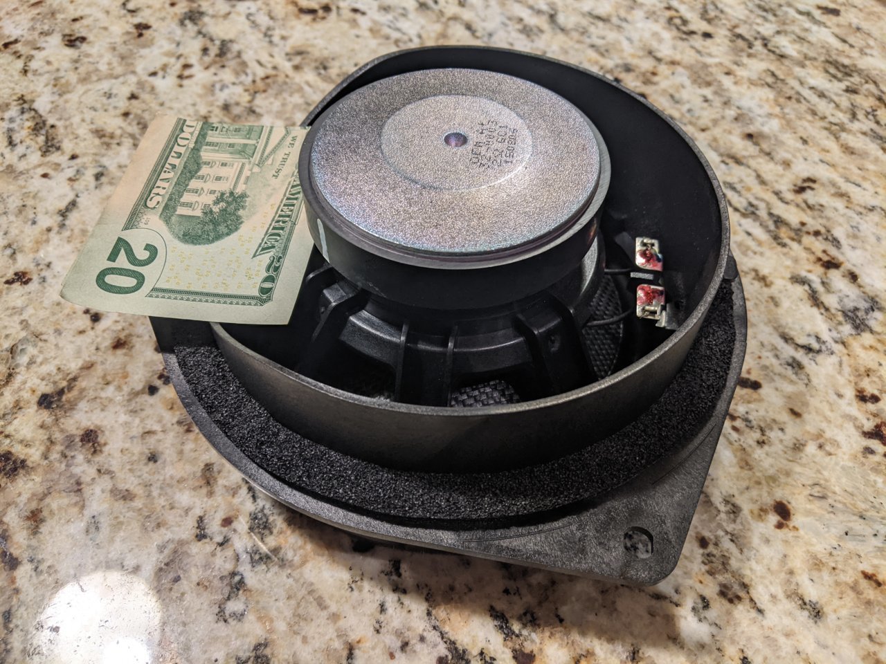

    Here's a picture of the magnet on the rear speaker.

    Wait wait wait. If that's considered small, I seriously question what my girlfriend thinks of me...

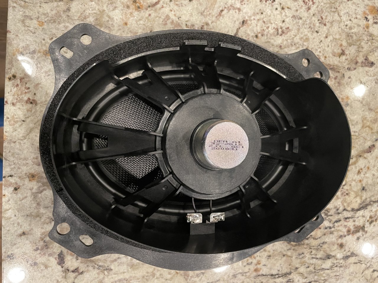

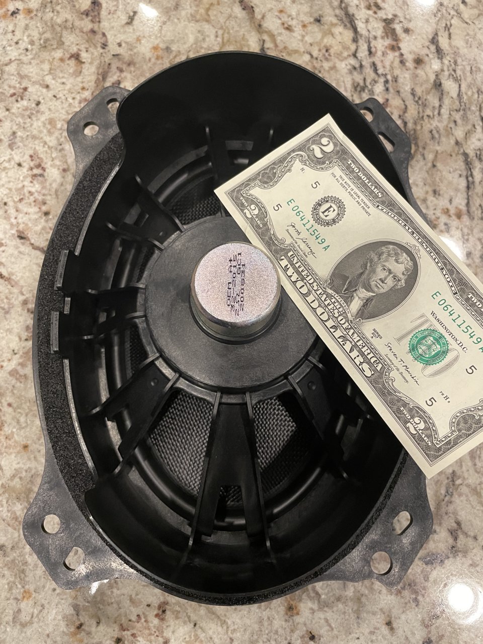

    LOL.............the back OEM Audio speakers are substantial. It is the front 6x9's that have a small.......actually very small and light........magnet.

    They are using neodynmium in their new speakers? That's actually impressive (and expensive). I know that they (OEM Audio) used traditional ferrite speakers with all of their door speakers front and back in the past (installed mine in 2019), so there must be a reason for the change, especially as it would have cost them more on an existing design. There are a handful of high-end home audio brands I know of that use neo magnets to produce an extremely powerful driver, without trading weight or depth - So makes me think that it must be installation-related.
    I agree with this statement to an extent. Yes, magnet quality is critical for speaker performance. But basing this evaluation on physical size only is relevant if it's the same magnet material in an A/B comparison. If they are using neodymium magnets, the comparison would be like comparing a 250GB hard drive of the early 2000s to a 1TB SSD Harddrive of late, yeah that 250GB is definitely "bigger."
    The fact that they would spend more on the 6x9 design they already had, has definitely piqued my interest.

    As per Daneil @ OEM+, they changed to the neodynmium magnets on the 6x9's so they would also fit in the tundra's. Apparently the original ones wit the big magnets they had been using on the Tacoma kits would interfere with the window operation, so to streamline production, they changed all 6x9's to the new style so they didn't have two styles to stock.
    When I spoke with Daniel 2 years ago, I strongly suggested he let people know they did this, so they would not get confused. Perhaps that's why they add a note with them now.

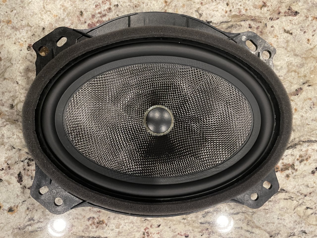

    Here they are. I look at the use of the neodymium magnets like a twin turbo V6 in the latest generation Ford GT. If you just looked at the displacement and configuration of the motor you’d assume that you didn’t have a Le Mans winning race car. Technology has come a long way.
