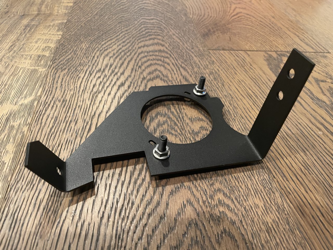

    Here is what the SOS speaker relocation mounting bracket looks like. I haven’t taken it out to the truck yet to try and see if it is intuitive where to mount it.

    Looks like a nicely engineered bracket!

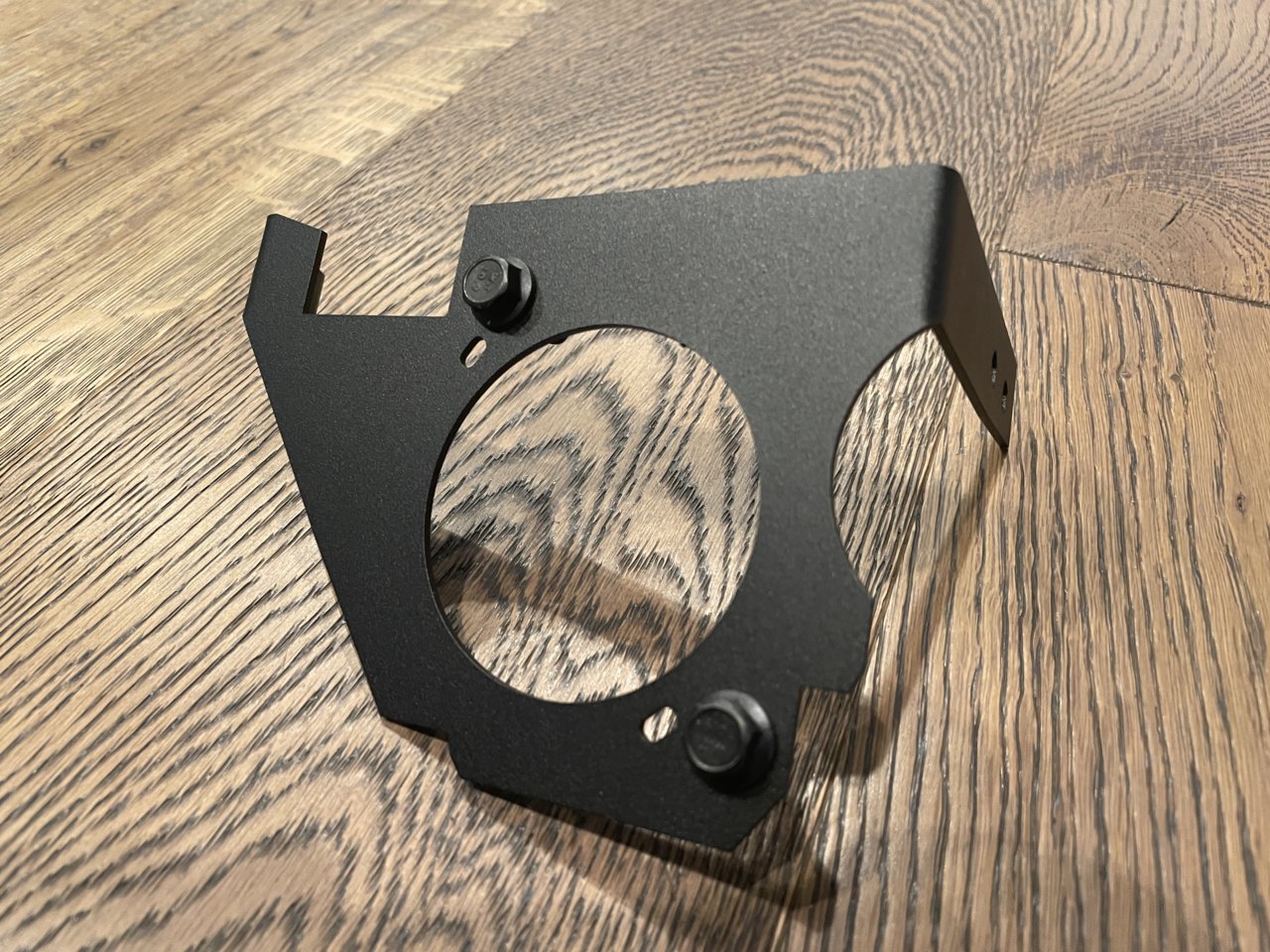

    Got my relocation bracket and replacement amp today. Haven't even opened up the amp, yet - but it should be a direct swap. Relocation bracket looks nice and should be something I can figure out once the kick panel is pulled again. Still would be nice to see if there are any special instructions or precautions.
    However, I decided to test-fit my speaker to the bracket and it did not fit well. The opening in the bracket is laser or plasma cut and it is just a tiny bit too small for my speaker to fit flush into it. I had to enlarge it slightly to get a good fit. Just an FYI to others.

    How did you go about enlarging it? Since fidelity isn’t critical with that speaker, could you use small spacers to push the speaker out from the bracket so that it clears the cutout?

    Spacers could have possibly been an option. I haven't tried to install the assembly yet, so I don't really know if spacing the speaker out might create any other issues with the kick panel fitment, etc. Probably ok to go that route since we're talking about a pretty small adjustment.
    To enlarge my opening, I used a half-round file and made a few passes, followed up by some dremel sanding to keep it pretty concentric.
