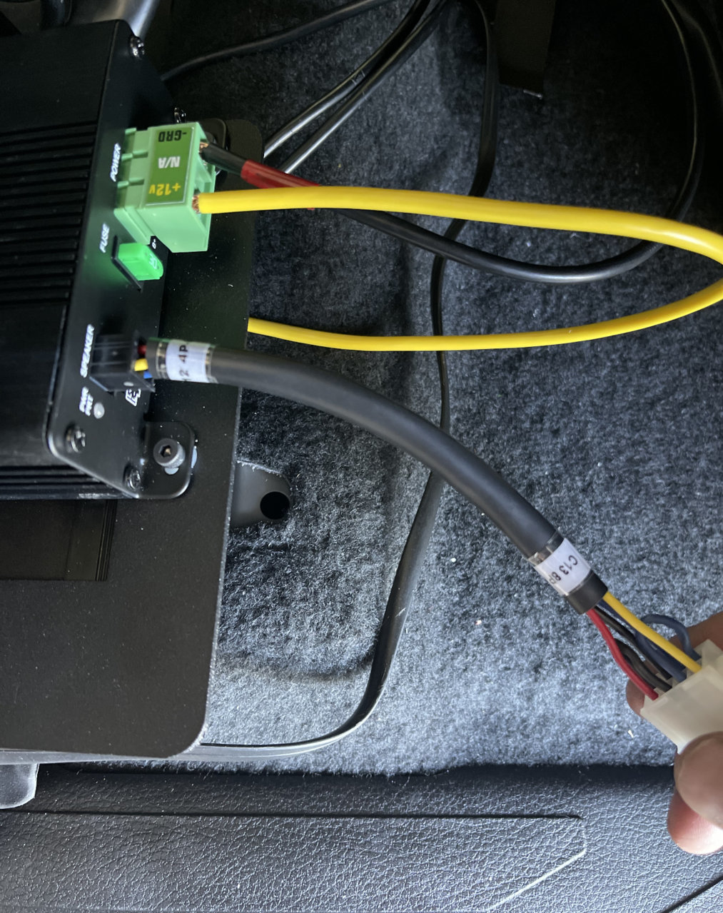

    I have a 2021 Tacoma sport. Decided to go with the OEM Audio Plus Reference 500 system. Installed it. Works great. Wanted to add the stand alone sub amp so I could individually control the sub with the gain control knob.

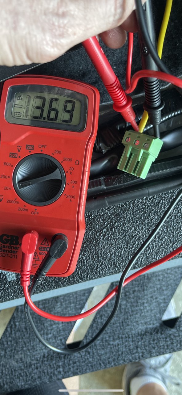

    I am having trouble getting the sub amp to turn on. I used a multimeter to test the voltage going to the power wire and I’m getting mid 13volts with the truck running. So the amp appears to be getting power, but it seems it’s not getting a signal from the head unit to turn on.
    Anyone have any help here? I assume it’s a remote wire issue, but I don’t know where to start. This system is 100% plug n play. I feel confident the amps/system is hooked up correctly. I called their support and the hook up isn’t the issue.
    They even had me run a wire from the power wire to the middle open plug on the green amp plug, it caused the amp to turn on. It won’t otherwise.
    Help! Waiting on a call back but haven’t heard from them today. Didn’t know if anyone has had this issue. If I hook things back up without the sub amp the radio and speakers work fine.

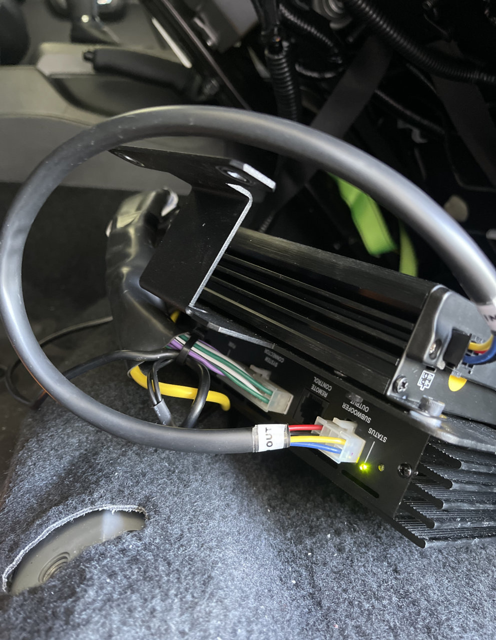

    The DSP sub has a 16 pin connector coming from the main harness that plugs into the head unit. The sub also has a 8 pin connector coming from the rear sub. That’s pretty much it. The add on sub connect with the harness seen in my pics. It also has another harness that the rear sub plugs into. I can send pics of this if needed.
