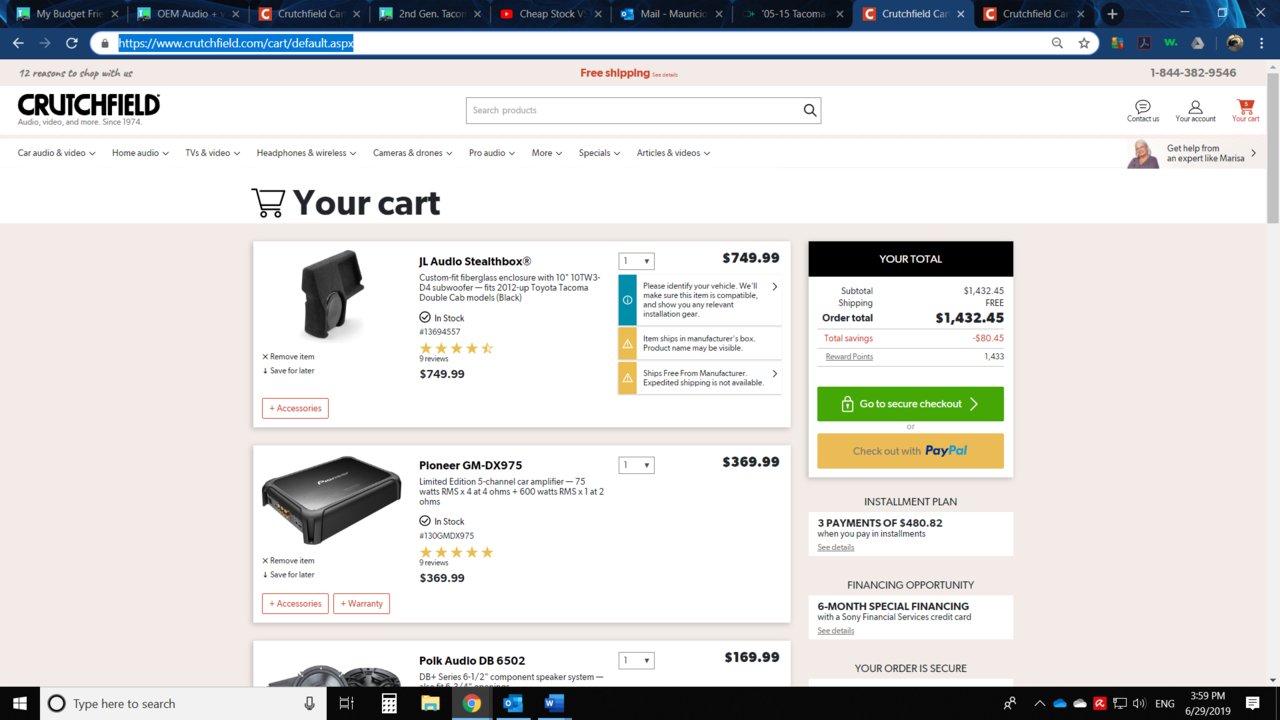

    Hows it going guys,
    Been searching in the forums for some sound upgrades. have found some really good info. The $250 thread was nice but it does not have a sub or AMP. ( I know you can add to that set up)
    I would like to add a sub behind the rear seat for some killer bass. And an AMP for some more power. I have the stock ENTUNE head with my 2015 doable cab.
    Found the OEM product thru one of the threads here and it looked ideal. speakers, amp, sub. looks like the cost is $1,550 with delivery. I found crutchfield on here, and spoke with one of the reps and they built out this cart. https://www.crutchfield.com/cart/default.aspx total $1,432. i do have the cash and dont mind spending it for some quality sound
    my question is, is it worth it to just spend the extra cash to get the OEM, is it that much better? or does that cart look better with less money and better specs ( by the look of it ).
    any info/recommendations will help. Thanks in advance for yalls time.

    That link doesn’t show the actual cart. Take screenshots or pictures of the cart, or link to the items

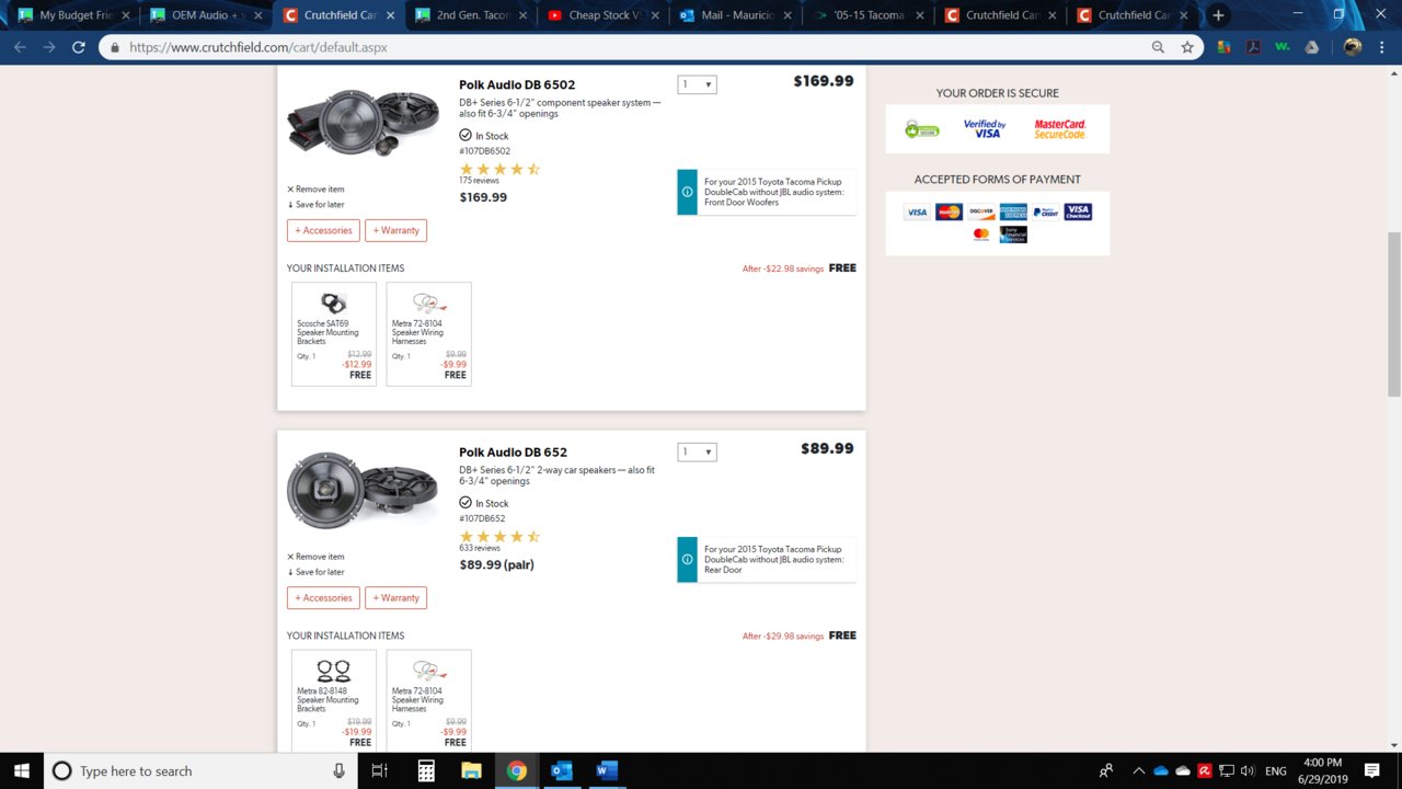

    My bad
    Here are the links
    sub - https://www.crutchfield.com/p_13694557/JL-Audio-Stealthbox-Black.html
    amp - https://www.crutchfield.com/p_130GMDX975/Pioneer-GM-DX975.html
    front - https://www.crutchfield.com/p_107DB6502/Polk-Audio-DB-6502.html
    rear - https://www.crutchfield.com/p_107DB652/Polk-Audio-DB-652.html
    wiring - https://www.crutchfield.com/p_007CK4/Crutchfield-CK4.html

    That stealth box is very expensive. You can cut the cost in half with a JL10TW1 and a box from Mr. Marv or supercrew sound. Still sounds excellent.

    That sub setup is steep to me, but I’ve been doing car audio work for almost twenty years. I’d buy a sub, build a box, and come out a LOT cheaper, if you have some basic wood working skills.
    Insofar as speakers, listen to a set before you buy. You can tweak a lot with a decent EQ, but a lot of how speakers sound is kinda subjective. Personally, I love Infinity but you have to dial the tweeters back cause they are crazy bright. Alpine’s are good to my ears as well, more balanced, just need to give them the power they want.
    Also, I see no mention of how you’re moving signal to the amps? If you’re using the built in high level inputs I’d highly recommend you grab signal from a front speaker (rears on many vehicles are highly attenuated) or use a line driver to convert to pre amp/low level inputs and run RCA’s.
    What’s your level of experience?
