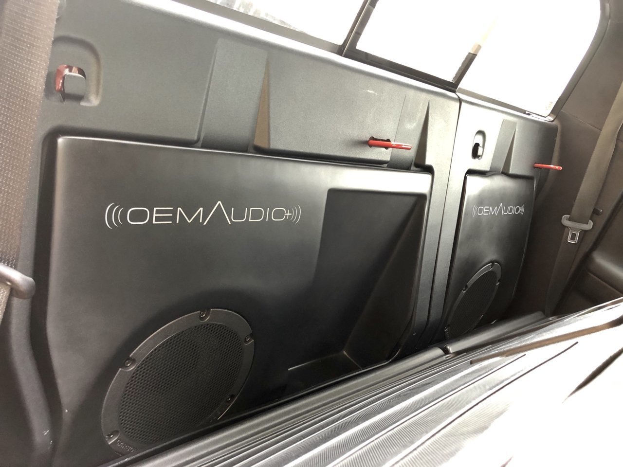

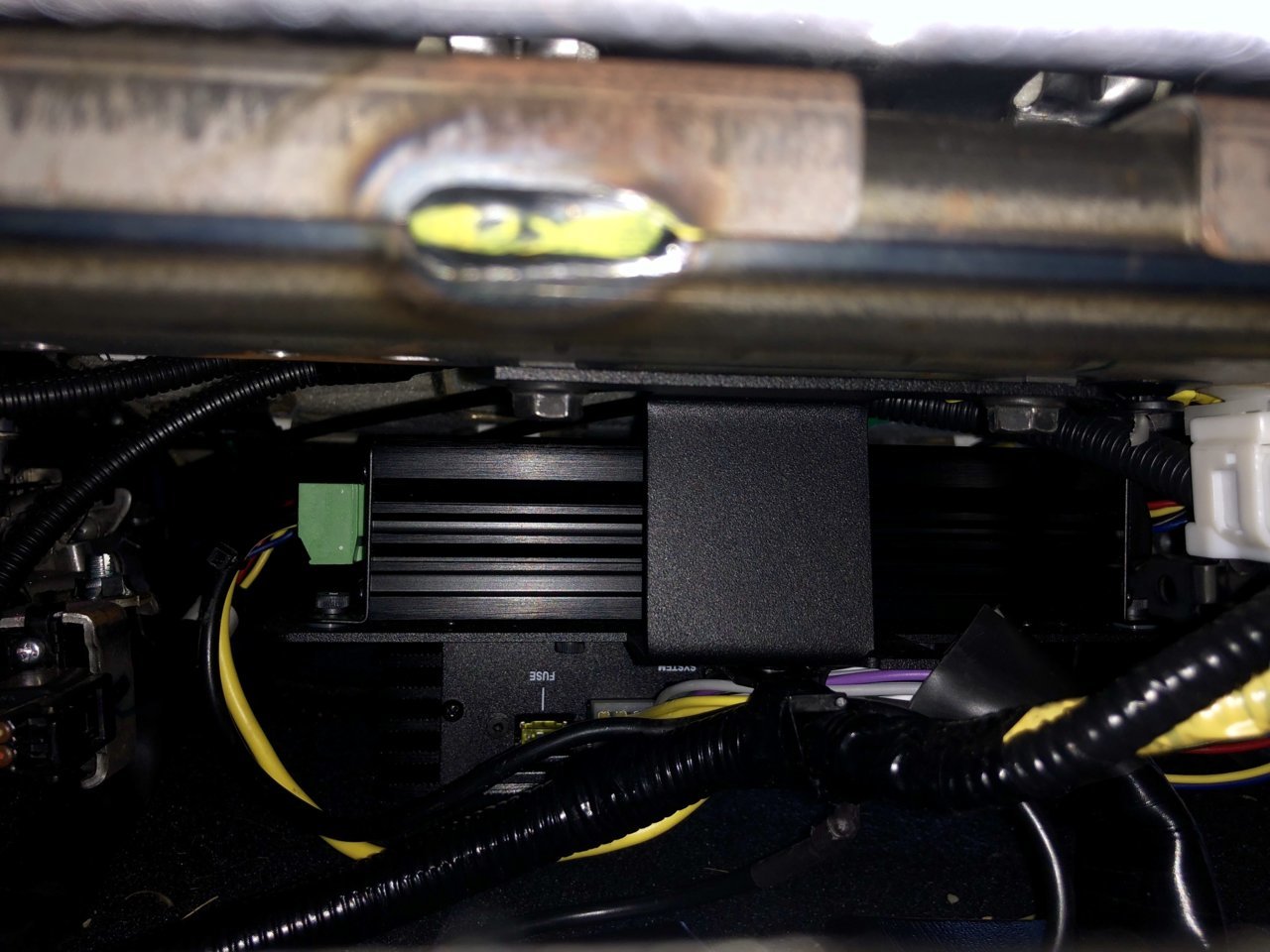

  11. Jul 21, 2019 at 11:22 AM
    CajunTaco2018
    CajunTaco2018 [OP] Member
    Jul 21, 2018
    #260024
    5
    2018 TRD Sport
    Just finished install yesterday.
    Ease of install 10/10
    Looks completely stock no issues what so ever.
    Sounds quality 8/10
    Very good clear highs and lows
    Volume 6/10
    The mids and highs are barely if any louder than stock but the clarity at higher volumes is much better.
    Customer Service 10/10
    Daniel was fantastic. Really I couldn’t say enough.
    Value I think is right on the money. I could have designed a system in my own but having everything ready to go plug and play was invaluable to me. Overall I’m very happy with my purchase.
    If I could change one thing it would be the power output to the mids and highs to increase the volume. I feel like I have to turn the two subs down a lot to balance the music.
